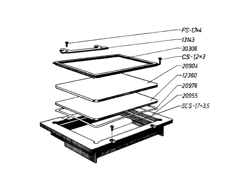

I know that you are supposed to put the spring in, then the fresnel (in this case a beattie bright screen), then the ground glass, then the little hold down frame and screws, using the screws to adjust the screen height.

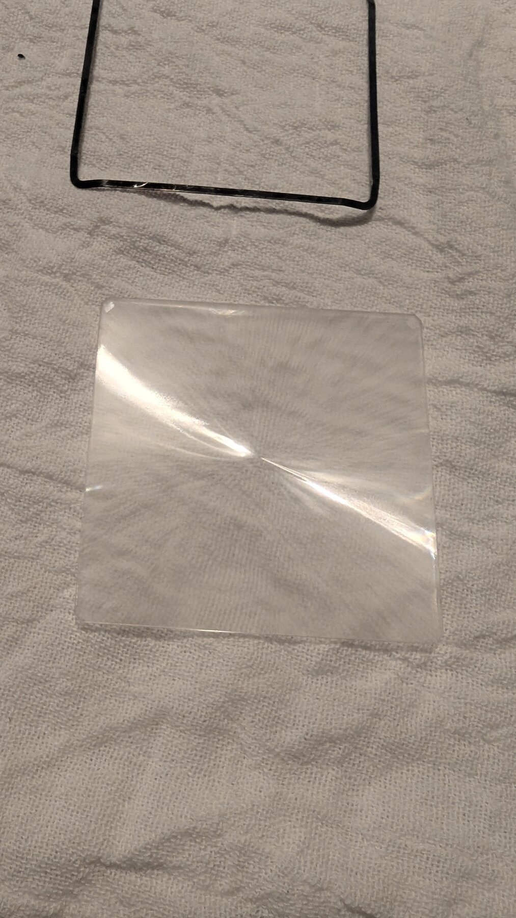

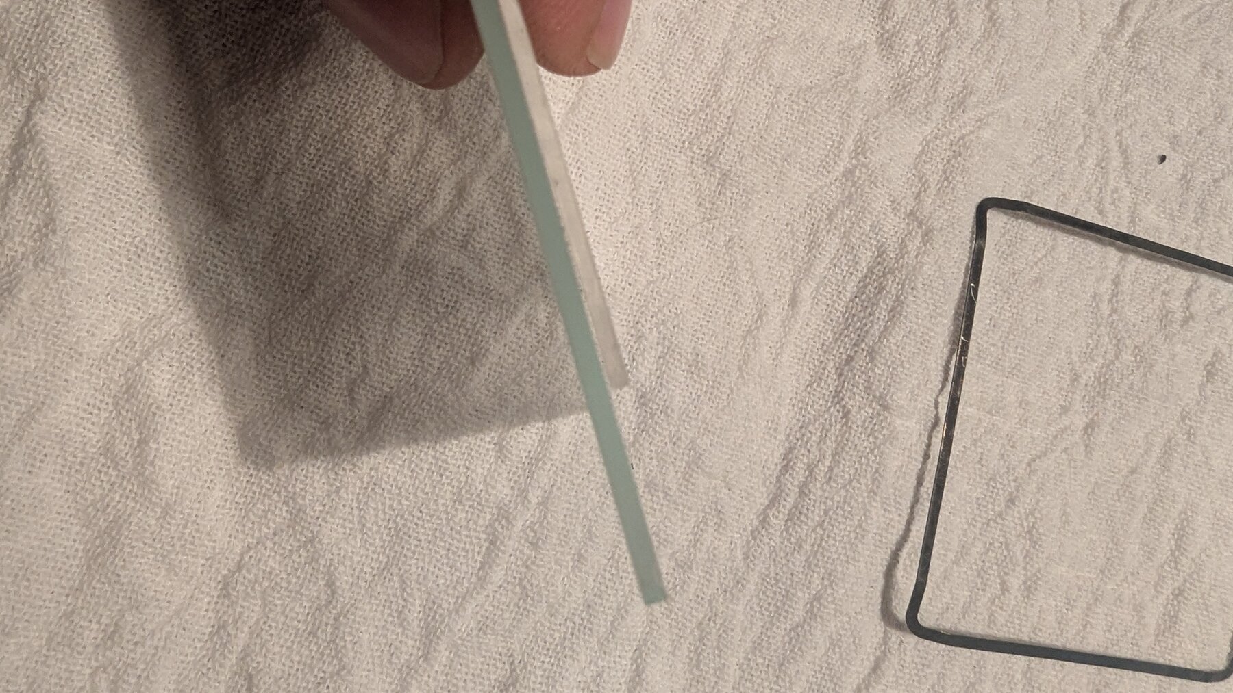

Oapoli, I went ahead and flipped the fresnel but it's too dark out to check infinity. Will check in the AM. And I don't know if it is a proper Beattie. The previous owner just told me the screw in the frame snapped when his tech went to put in the Beattie screen and he seemed to think that was the screen in the camera. The screen seems pretty thin, just a bit thinner than the ground glass. I attached a picture. Seems like it might warp when adjusting screen focus but maybe I'm wrong. Does this look like the real deal?

To me it looks like a plain Fresnel. A standalone focus screen should have some frosting. Does it catch an image on its own?

Ok! Thanks! I was wondering because the image looked terrible without the ground glass! The image is also darker than the factory screen on my Mamiya C330 which seemed wrong for a Beattie screen from what I've read. I went ahead and flipped the fresnel but it didn't make much of a difference.
