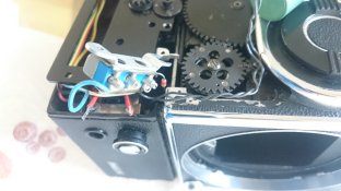

For Hassy B, I took a picture attached, seems like two red wires were out, no idea where to put them. I think in the middle, but not sure. And once back, it's not that easy to put everything back (I tried to, without putting the 2 wires back, just to see) ! I did it once to try, but forgot the removal part of the solenoid -_- (classic, I know, even if I saw this same mistake in the link above, and I was like "pff how can someone forget that" and yet I did...). So now, once I get these two wires back, I hope it will work !
Will post evolution for Hassy B, and wait for any advices for Hassy A !

For Hassy B, I will check with a real service, such as the one mentionned by JOR (thanks for that btw) since I can't get it to work even though I fixed the two red cables, I think it's the motor unit since the rest is turning, mirrors up/down perfectly well now.
edit : For Hassy B, I managed to have the solenoid work (see at 5th second in the video), and simulated its effect on the mirror at 11th second, however, the rest where the motor should turn the gears to bring down the mirror doesnt seem to work...yet (?)

So...I have been working on Hassy B all last days...
I ended up opening completely the motor unit, played with the electronics, resoldered all the wires, tested the solenoid and...worked ! tested the motor and..worked ! now, the game was to put everything back inside, I did it many times before understanding all the links (solenoid needs to be carefully put so that it would trigger a gear and a small switch needs to be VERY carefully put as well so that it would stop the motor from turning when the mirror is down. all that done, I can now say that my cameras are working !!!
