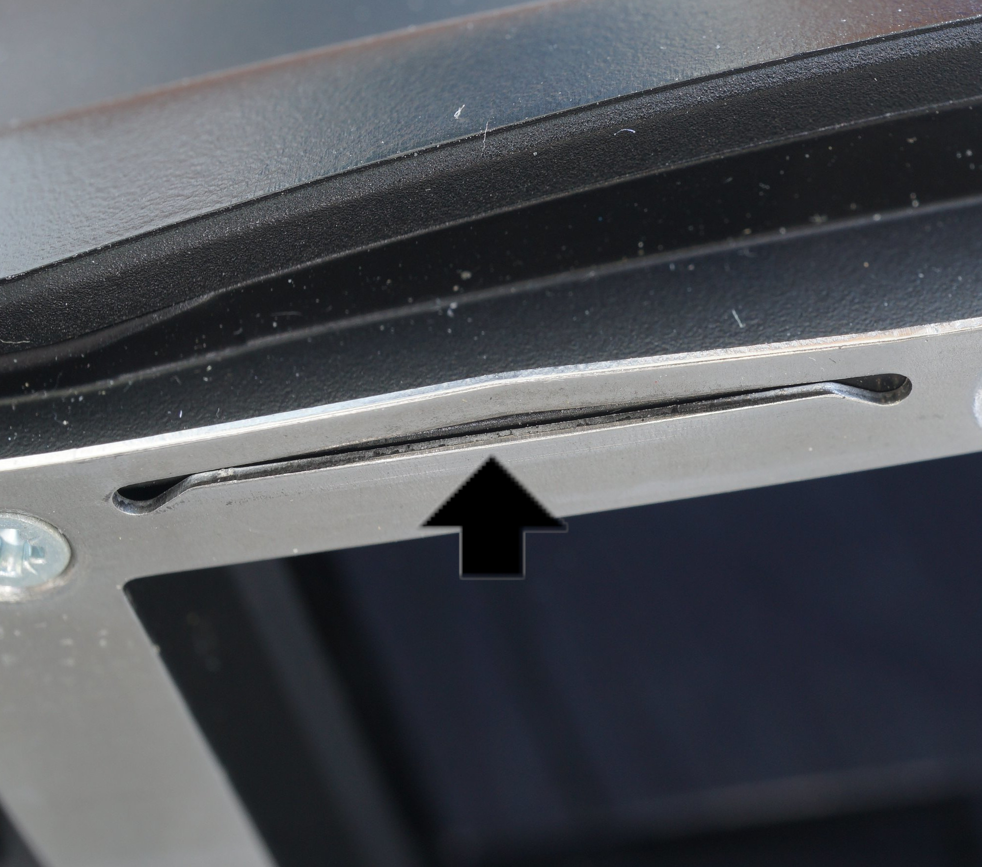

You should not need to use tape or spacers to correct the prism looseness on the hasselblads. They all have a mechanical spring that is used to take up the slack. I have a NC-2, PME51 and a PM90.
The PME51 uses a thin plate on top of the main plate, which has a raised flange near the end that takes up the slack. You may need to bend up the spring a bit, easily done with a knife edge.
The PM90 has a cutout that is bent to spring load itself in the slot. Again a slight bend with a pair ot needle nose pliers does the job.

My Prism doesn't seem to have either of those features. It does however have two little spring loaded balls at the rear end of the mount, which push that side down. However, that means that the prism still has room to wiggle at the front (lens facing side).
