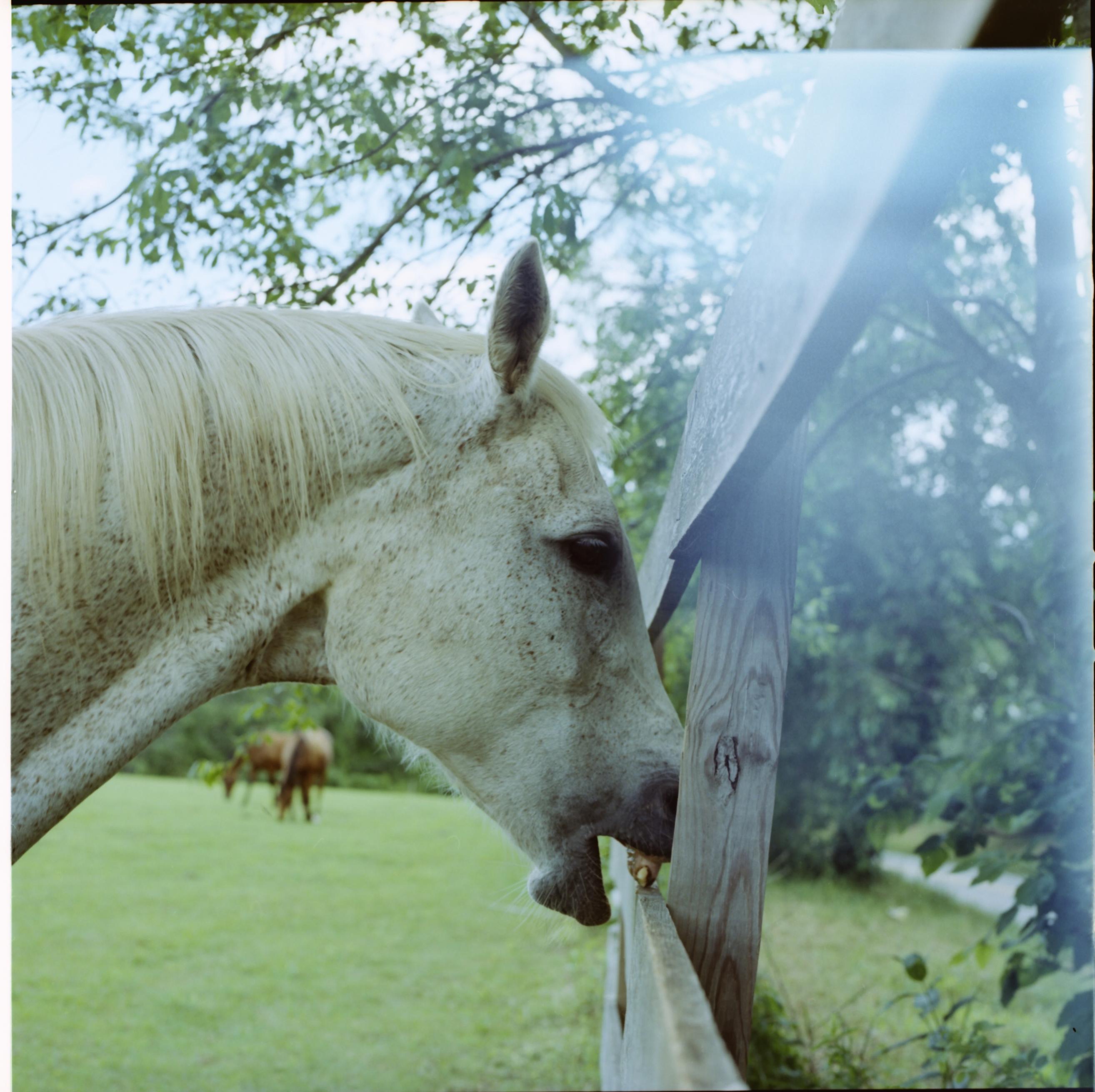

My Hasselblad 500 cm appears to have a light leak, and I am trying to figure out how the light is coming in and how to fix it. I am not sure if it is the back, or the camera body. Any thoughts or ideas?

Looks like the light trap on the back - where the dark slide goes in. Trap is not difficult to replace with the correct parts. Got mine from Hasselblad Service in Gothenburg, but that was rather a few years ago now, there must be sources closer to you.

But am i right when i think you've posted the image left-right reversed?
If so, that doesn't help diagnose the problem!
And if so, it may not be the dark slide slot seal.
What else it is i don't know right now.
One of my backs had a huge leak similar to what I see on your image. Check eb@y for "Hasselblad light trap" add "OEM" if you want. Can be had for about $12 to $25. Easy to replace, demo can be seen on YouTube IIRC. There are about 9 little screws to keep track of and a stamped spring or two that will usually stay in place if you are careful, but not hard to put back in place if you are not... provided it doesn't fling across the room never to be seen again.

Thanks for the help. I bought some light seals off ebay. I think the picture was scanned in the right way, but I could be wrong. It was a while ago.
I asked, because i think that those are the two Hasselblad Vees that are just about visible, cutting through the right edge of the frame.
If they are that, the image as shown is left-right reversed.
