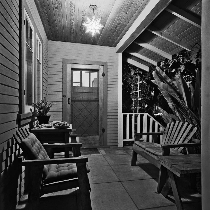

Does anyone have a picture taken with the Hasselblad 40mm CF fle lens (not the CFE-IF version) with the horizon or other straight line near the edge of the frame? I would like to see how much straight line distortion there is with the fle version. I have the older 40mm Zeiss lens for my Rollei SL66 and there is no noticeable straight line distortion, see the photo attached. I may be switching to Hasselblad and would prefer the CF version to the older compur shutter version.

Guys, I know all about the info available at Zeiss, I have seen everything there. I know the C lens has around 1% distortion and the fle has around 1.3%. What I don't know is what that looks like.

Do you really think anyone is going to notice a .3% increase in distortion? Think about what the 1% distortion looks like in the picture you posted. :wink:
