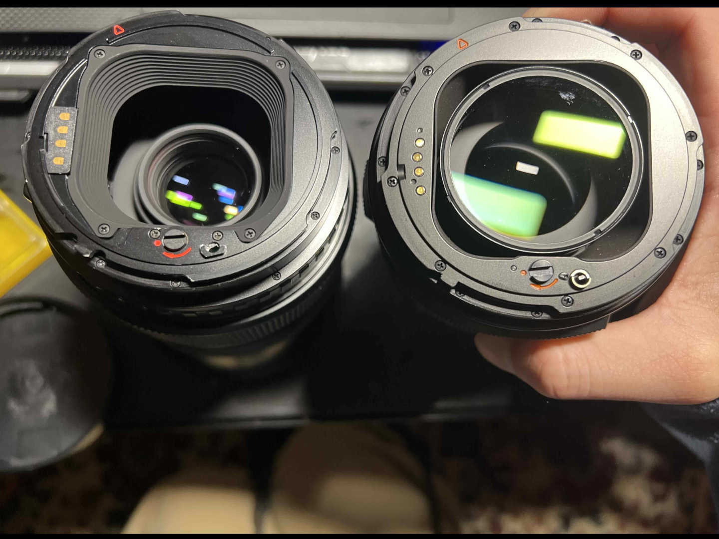

Thank you for reminding me that this problem actually started when I recognized that the lens was uncocked off the body, so I recocked it and the problem started. The first photo is the position of the screws off the body, the left being a working lens and the right being the offending lens. I note that to recock the lens on the left, it turns a little more than 180 degrees, and the offending lens screw only needs to turn about 90 degrees.

<snip>The first photo is the position of the screws off the body, the left being a working lens and the right being the offending lens. I note that to recock the lens on the left, it turns a little more than 180 degrees, and the offending lens screw only needs to turn about 90 degrees.
<snip>
That means that the 2.8/150 is hanging up during the release, as it's only making it 90 deg in the key, which explains the mirror not completely rising, as the key position is directly related to the state of the camera. And I see you have it working after exercising the lens.
Keep in mind that if this is happening, something in the lens is getting sticky, and typically this will get worse as the lubricant ages or parts wear, so you may want to get the lens serviced eventually. Sticky lens parts are pretty basic to service, but make sure you have someone familiar with the FE lenses, as the aperture ring needs to come off and it has a bunch if very delicate electronic wiper contacts, which are very easily damaged when dismantling.
