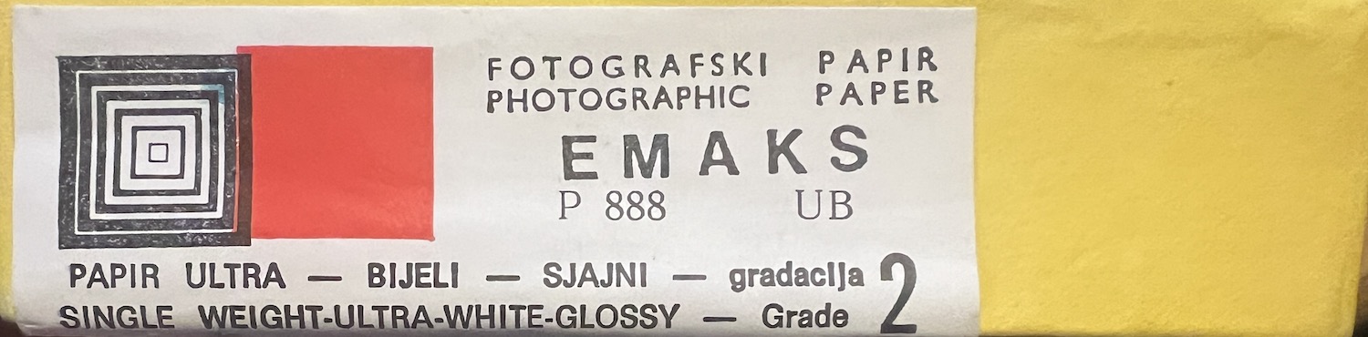

You are very welcome Emaks!
Regarding your username, I spend many years printing on that paper.
Here is variation, single weight version:
emaks k888
May 5, 2007
6
Great to hear. It was fantastic with deep blacks and beautiful tone. Miss it. But then came Forte Polywarmtone (was it pw14?) and it was even better. Still have my darkroom.
