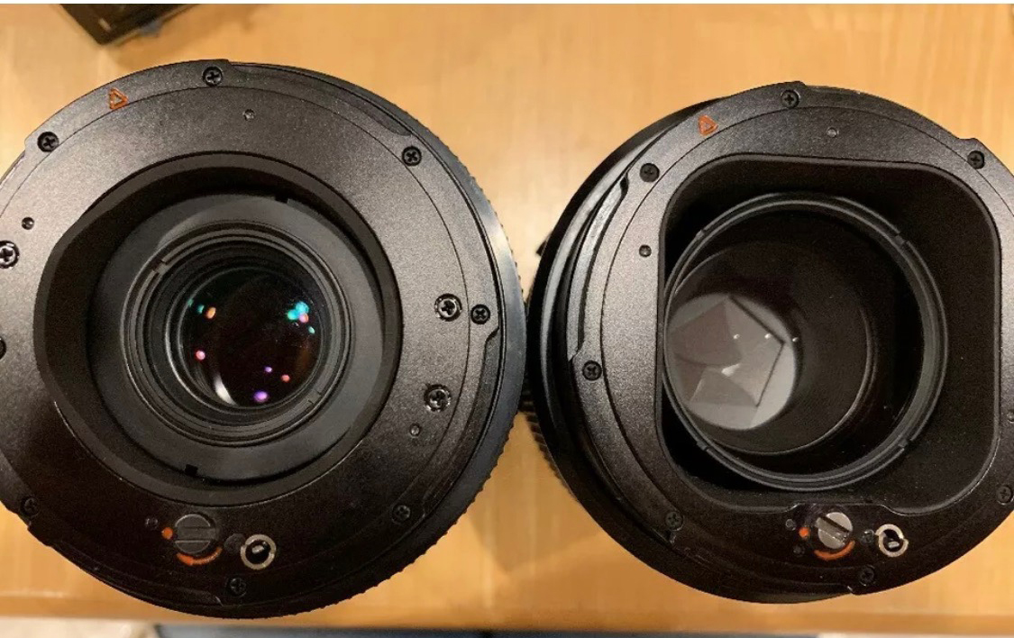

Attached is a photo showing the properly wound and cocked 50mm CF lens (on the left). Note the position of the shutter release pin toward the center of the lens and the aligned slot and red mark.
The problem 150mm lens on right has a slot unaligned with the red mark and the release pin toward the edge of the lens in the released state.
Rotating the screw on the lens on the right should cause the pin to move to the center and latch as the screw is turned 360 degrees to align the slot with the red mark. The pin does not latch and remains towards the edge of the lens.

I had a chance to try an experiment with the lens last night. I rotated the cocking screw about 360 degrees to align the slot and red dot and had my daughter jiggle the small release pin in its hole. It had absolutely no spring tension to push it into the locked position and flopped freely back and forth!
She could push it to the central latched position and the screw would then lock normally.
It appears the latch spring is either out of position or broken.
Time for repair!
One local Hasselblad repair guy suggested that I remove the back plate to examine the mechanism. He claims this can be done without much danger of further damage. I have repaired various shutters over the years, but nothing this high-end. Probably better to just get it repaired, as the Ebay seller has offered to pay for the repair. The three month lead time for the repair that everyone seems to quote is a bit of a disappointment, but them's the consequences of shooting an older premium system, I guess!

Rather than risking any further damage, I spoke with David Odess (http://www.david-odess.com/repair.html) and described the situation, We worked out a great arrangement for a repair. The Ebay seller agreed to cover the cost.. Dave is great guy to work with! He took the time to discuss what was wrong and suggested a solution to minimize cost and turnaround time.

Happy ending!
Dave found that some misplaced grease was preventing the cocking latch from engaging. He cleaned off the grease and returned the lens in great operating order in record time.
The Ebay seller paid Dave directly.
Great cooperation was displayed all around in getting this resolved!.
