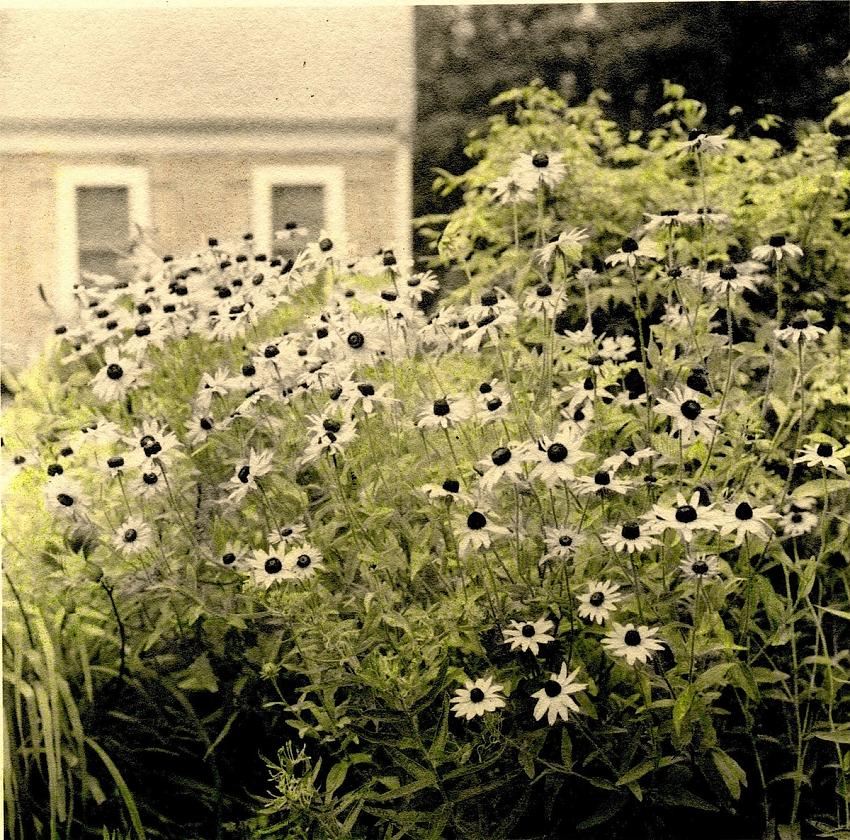

I've used it for hand-coloring, but found the surface a bit fragile for my way of coloring. I tend to apply a good bit of pressure when using oils and pencils. For pencils, I use eraserstiks to blend the color, which is more difficult on a textured surface. This image is done entirely with pencil on Art 300:

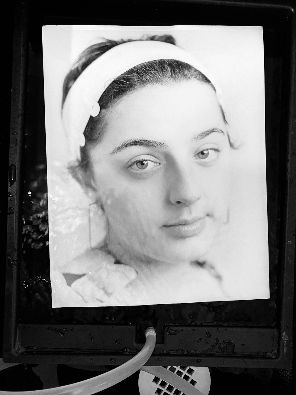

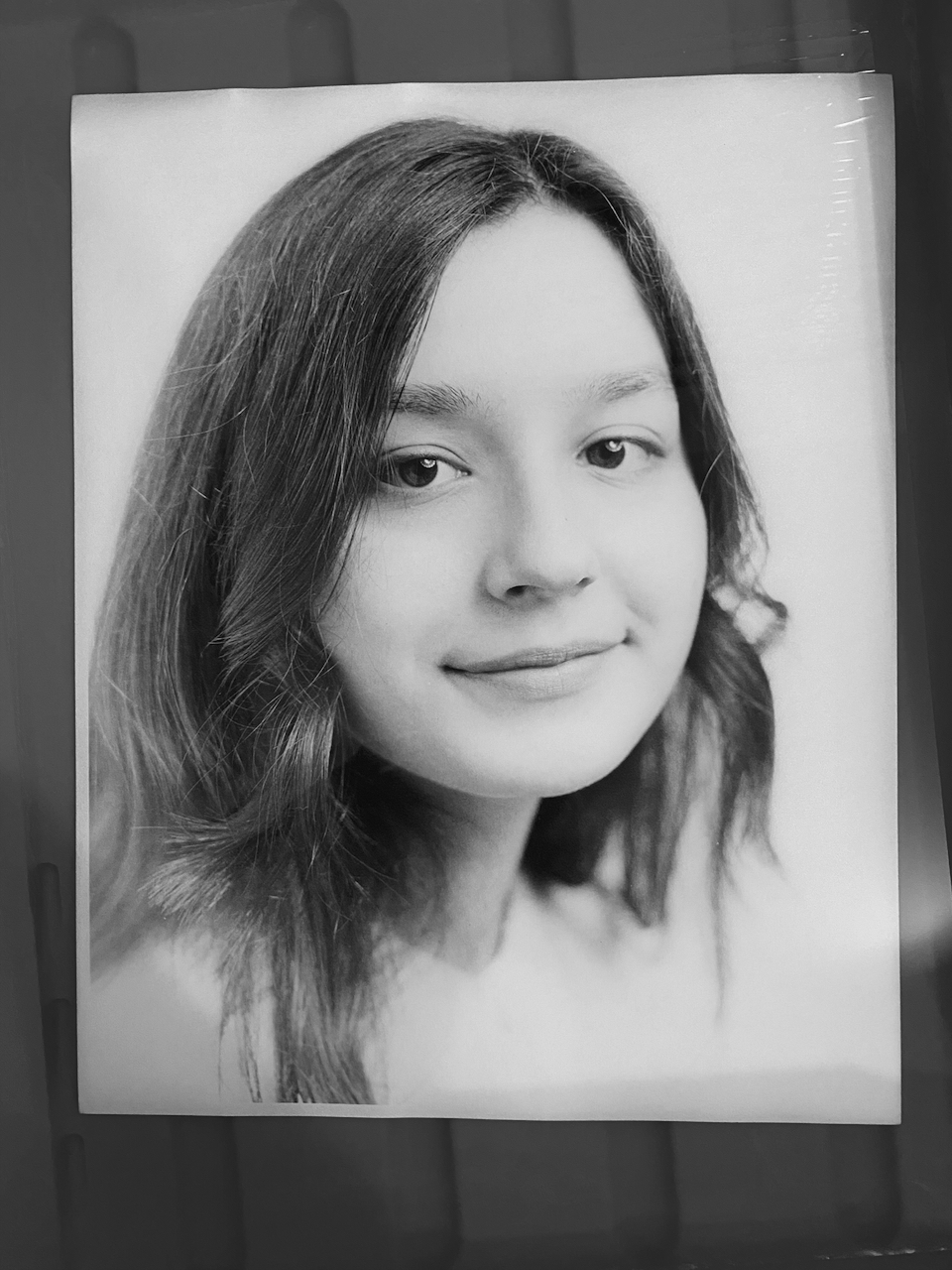

I've been trying Art 300 for a portrait project. In this case, I'm looking to see how the lack of fine detail might work well for portraits of teenagers with less-than-perfect skin.

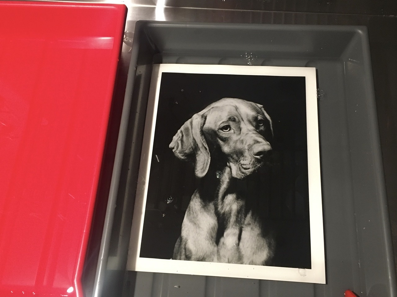

I will be using this paper for a project I have with shooting portraits. Animals and people and I think it works great for this. It is warm tone and doesn’t seem to change too much after it is dry.

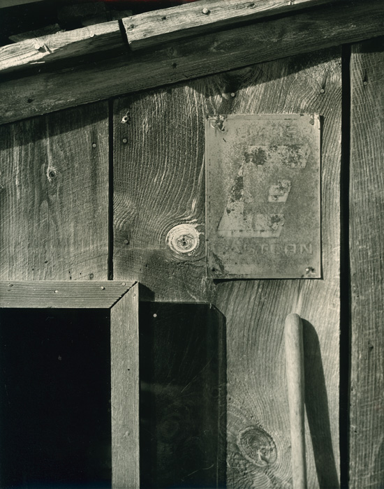

I made a print of this negative on it, the paper texture makes the saw marks in the wood look 3 dimensional.
Unfortunately, with a framed print under glass, you can't discern the texture.
