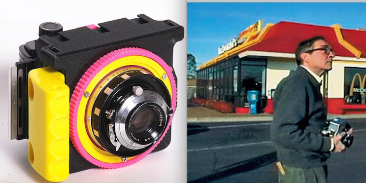

I have been keeping an eye out for a 6X9 camera I can afford. This guy makes a plastic camera that uses Mamiya Press lenses, which are reputed to be great, along with Graflex backs.
The sample of images on Flickr for these things is very thin, so I was wondering if anyone here has any experience with it. Theoretically, it should allow for great images.

I can't picture Eggleston using one...Parr maybe...

Does not look like a Mamiya back, so wondering how good the back will be keeping he film flat? Does it have frame counter or red window? Also plastic breech mount, will i warp in hot weather?

It uses a Graflex back that you supply. That's why I say in theory it should be pretty good, as long as the distance from the lens to the back is right. It uses a Mamiya Press lens and Graflex back, both of which you supply.

I have one and in my opinion it's pretty good. I made a page about it here http://www.oddcameras.com/cameradactyl_universal_travel.htm . it uses mamiya 23/univeral optics and graflok backs, which a part of the mamiyas uses as well. it seems to be a rough 3D print at first sight, but the optics and backs fit nicely. even the mamiya finders fit. my favorites are the 65mm and the 50mm. you can't do smaller and lighter in wide angle 6x9.

Thank you for that post! So you find the results sharp and lacking light leaks?
This may be the option I'm looking for, and I love supporting creative film camera efforts like this.

no leaks and the results are as sharp as they could be. for me it is the 6x9 option I was looking for, light and compact. my other favorite is the Lomo LC-A 120, as small as a folder and even lighter, but that's 6x6. if you are interested, I made a page here http://www.120folder.com/lomo_lca120.htm .
