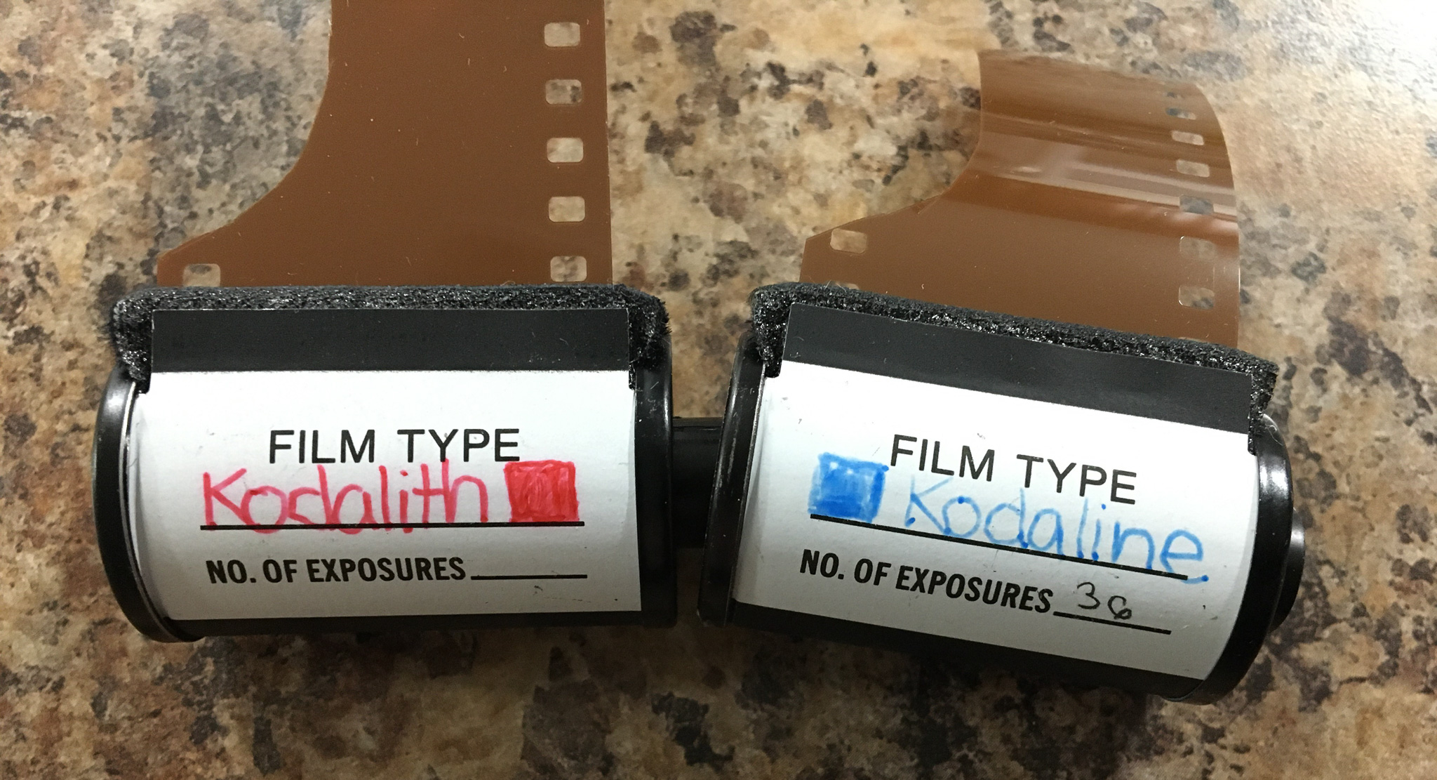

I recently got a 100' bulk loader which had some film inside as well as some Kodak Snap-Cap magazines. Two of the magazines were labeled, one reading "Kodalith" and the other reading "Kodaline". I'm trying to figure out what the film is and have found some information about Kodalith, but nothing about Kodaline.
I made some test exposures of a color chart from the film inside the loader and developed it in Sprint Standard developer for 7:30. The best exposure was made at EI 6 and showed that the film is orthochromatic. I could not find any useful information in the rebate text except for a date and production code indicating the film was made by Eastman-Kodak at Rochester in 1984. The unexposed parts of the film had the clearest base I have ever seen and the lightstruck leader of the film was extremely dense with a grey appearance from both the base and emulsion sides of the film.
I think the film is most likely Kodalith and will run more development tests at different times and dilutions to see if I can confirm this, but I was curious if anyone knew about this "Kodaline" film on the off chance that's what it is.
Here is a photo of the magazines for reference:
Thanks in advance for any help!

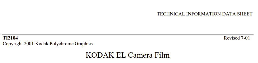

And from this datasheet for graphic arts line camera film:
The following:

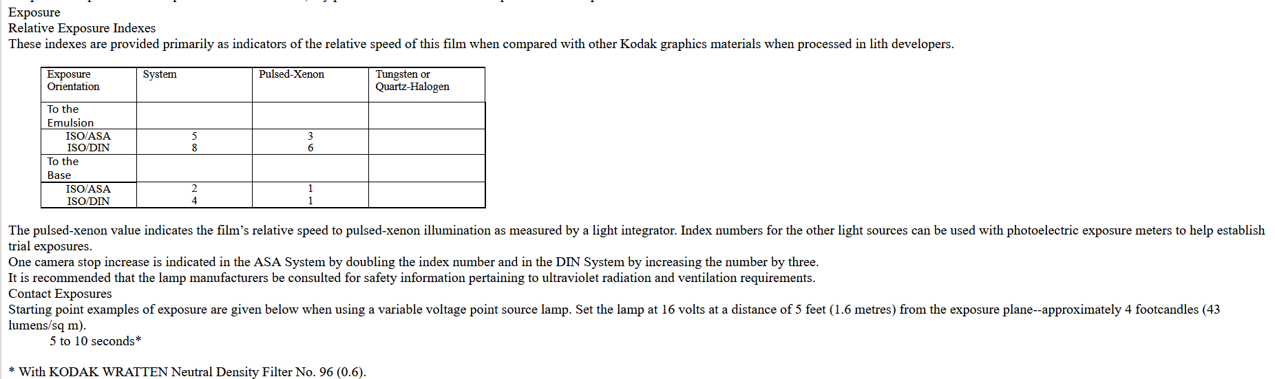

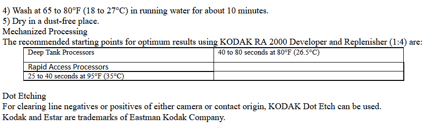

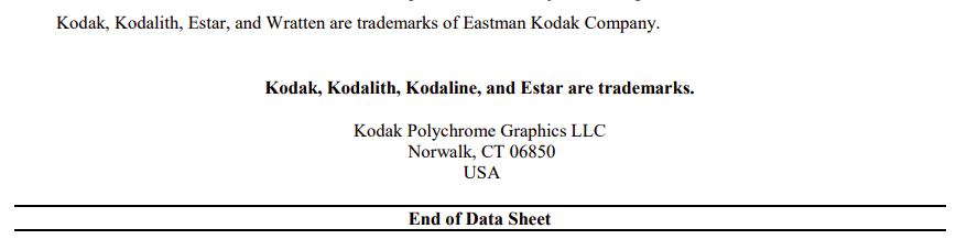

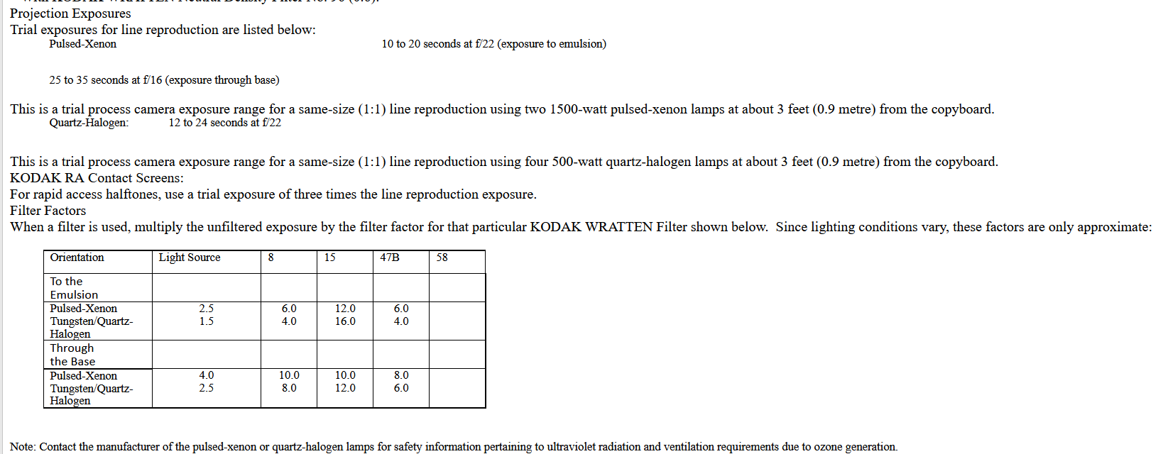

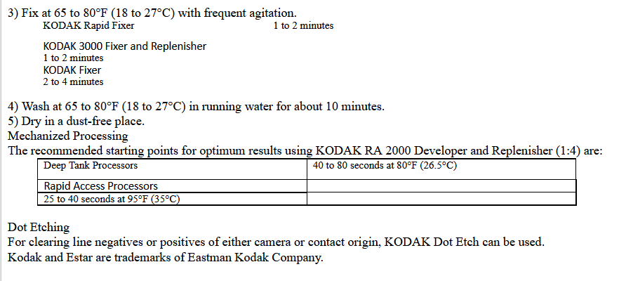

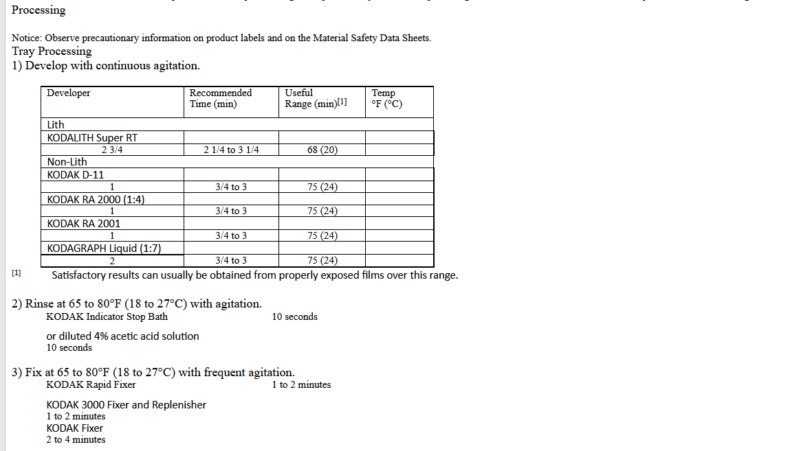

From the 1989 Technical Information sheet, courtesy of a reliable source:
My apologies for the segmented format. The material came to me in a way that makes it difficult to add to a post.
I know this is an old thread, but I can answer your question. Both Kodalith and Kodaline were high contrast orthochromatic films. Kodalith was on an acetate base and Kodaline was on an Estar base. I was a photo tech at Eastman Kodak and we used 35mm Kodaline for masking purposes for slides used in computer controlled multi projector, multi image shows. The Estar base remained dimensionally stable under the heat of the projector lamps whereas the acetate base would shrink and swell which would cause havoc with image alignment.
