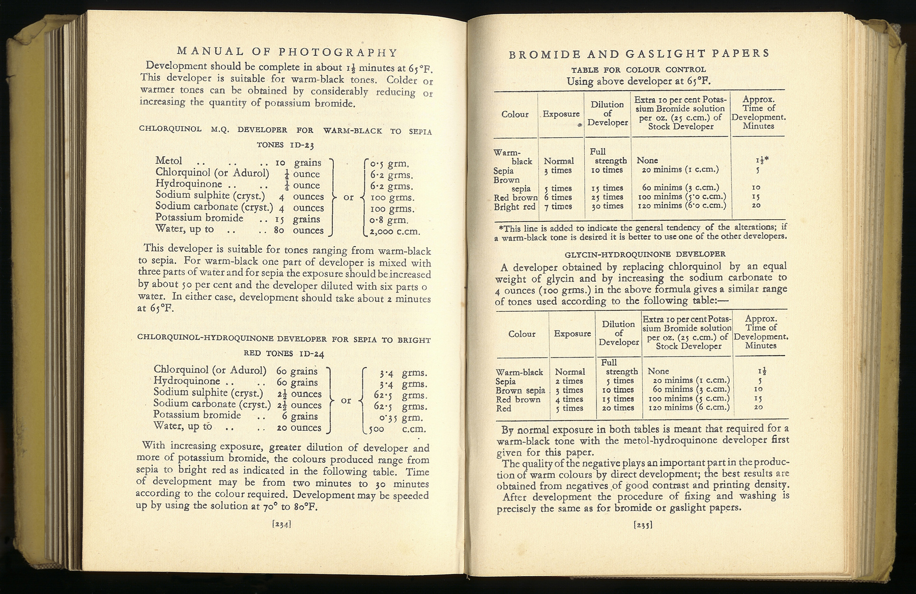

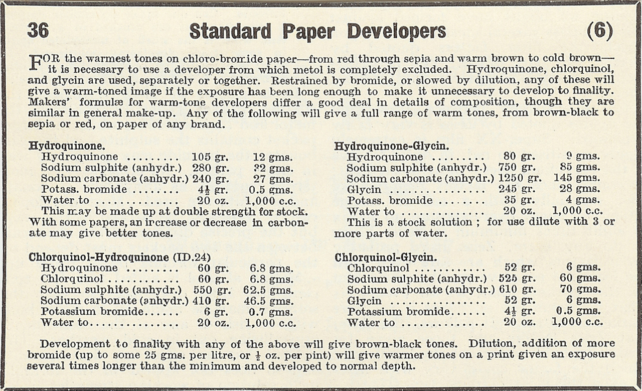

Just for future reference if anyone has any interest, these are taken from The Ilford Manual of Photography, 1935 Edition (n.b. I couldn't find it in my 1955 edition), and [II] Index Cards issued in 1936 in London Photographic Periodical which someone very kindly cut out and pasted to boards and boxed for me to discover 80 years later:
Perhaps not providing any additional assistance, but possibly of historical interest.
