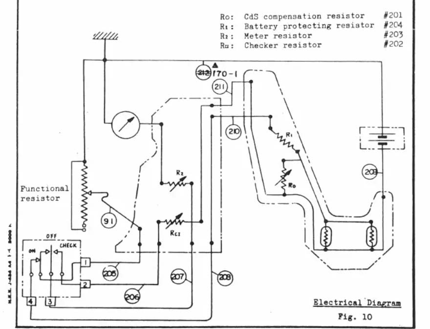

I found the service manual but to down load the manual I have to pay. But I can do a screen shot of the page with the diagram. The FTN finder has 2 Cds cells.

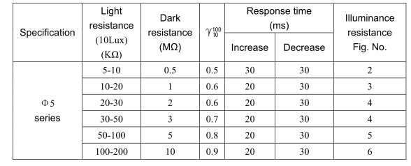

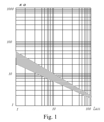

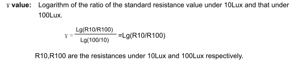

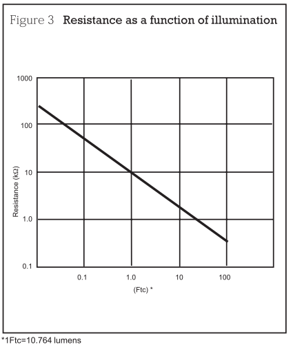

Your chances of finding a suitable replacement are, IMO, quite slim. Yes, the current-voltage response of a photoresistor is linear.
BUT various photoresistors differ not only by their sensitivty, i.e. conductance (inverse resistance) at a given light level. The resistance versus illumination curve is NOT linear. Or, rather, it is linear in a log-log plot, with a slope that is different between various units. This slope (in log-log) being less than one is welcome because a large dynamic range of illumination translates to a smaller easier to manage, dynamic range in resistance and meter current.
For those readers not mathematically inclined, and as simple example, a value γ=0.5 means that when illumination changes 100-fold, resistance changes only 10-fold.
Illustrating the slope in log-log coordinates, from: https://docs.rs-online.com/fb50/0900766b8001a9d6.pdf
Variation of that slope between sub-types, from :https://www.kth.se/social/files/54ef17dbf27654753f437c56/GL5537.pdf
Dispersion of γ values even within a well defined component model number:
Thanks, this is helpful, once I have a cell that will fit I will need to find the right set of resistors the compensator resistor may be key. But once I change that resitor might need to change the others.

The problem with these meters is generally said to be the resistive track wears out - the "functional resistor" in the circuit diagram. This is like the track of a potentiometer and not a standard electronic component you can buy. If it were just a question of replacing the CdS cells, then someone could probably try to replace the cell with another CdS cell and adjust some of the trimpots to get it to work over some range.
There are two CdS photoresistors in parallel. If one of them went bad, you would probably see slightly off meter readings, but the meter would work. It is unlikely that both would go bad at exactly the same time.

Reading the service manual I found the key of the meter is the FRE. It's not linear but rather logarithmic.
