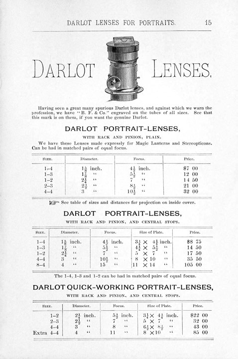

Hi Joe,
I have attached an image from a 1890s French's Lens catalogue detailing Darlot (Harlow) Petzvals. I have never owned one, following (allegedly) Julia Margaret Cameron who called her Darlot "that horrid French lens".

Ummm! This might be interesting. Sometimes horrid is just what I'm after.
Thanks for the catalog page.

JG Motamedi said:
Hi Joe,
Hi All,
It looks from this catalogue that other manufacturers mounted Darlot lenses in their own tubes, if I'm understanding the top few lines correctly. I have a large petzval (about 13" focal length, roughly 4" dia front element) with no markings on the outside, and equipped with an iris diaphragm that opens up to f5. The back element set though is marked "Darlot a Paris 1862", which tells me it's a Darlot lens. I'm guessing it must have been remounted with the iris at some later date, or perhaps the lens cells sat about for a while before mounting since I thought only waterhouse stops were used in the 1860s. If someone has more info on these lenses I'd appreciate it.
thanks
Tim
