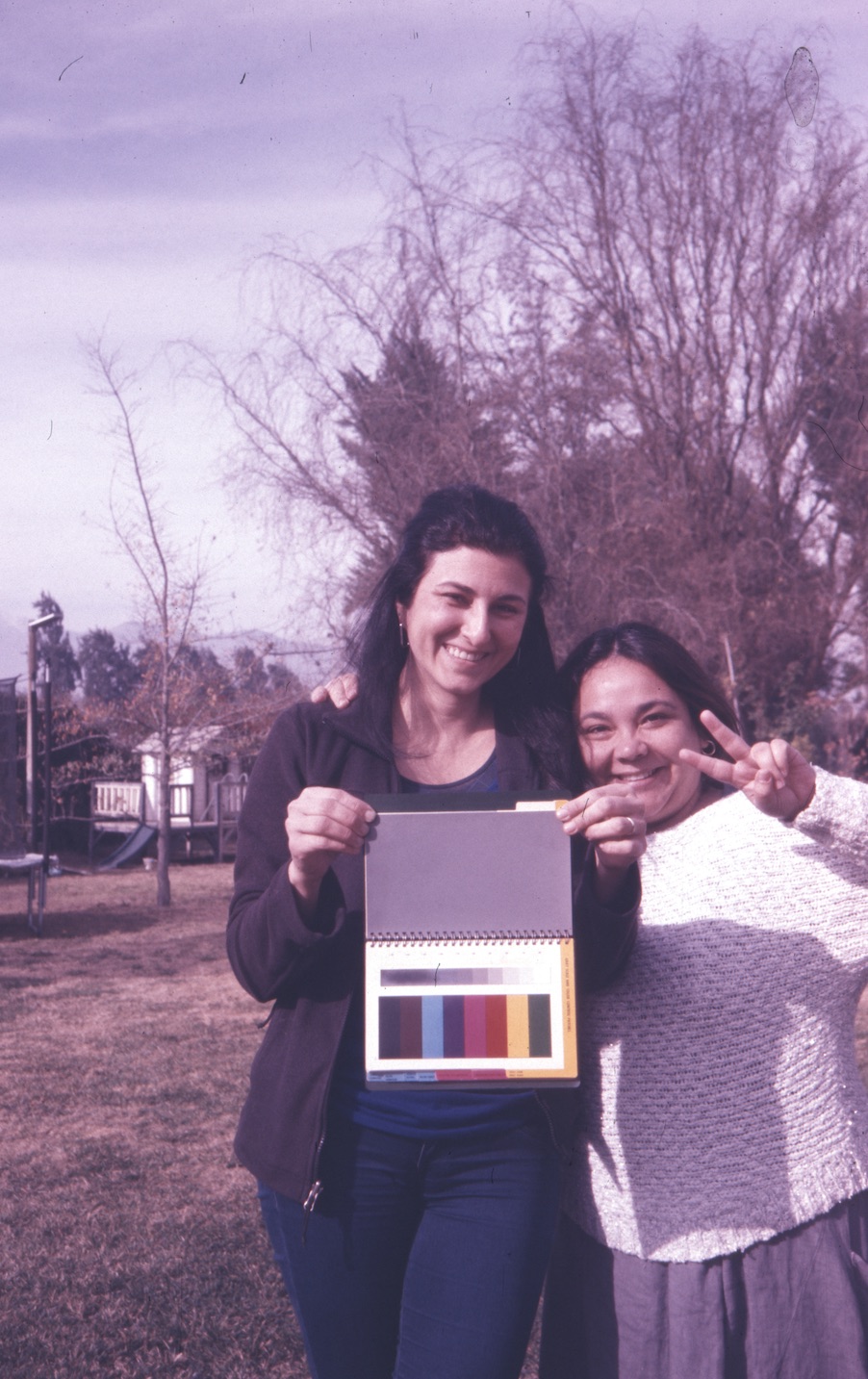

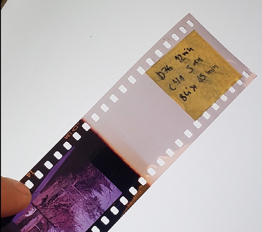

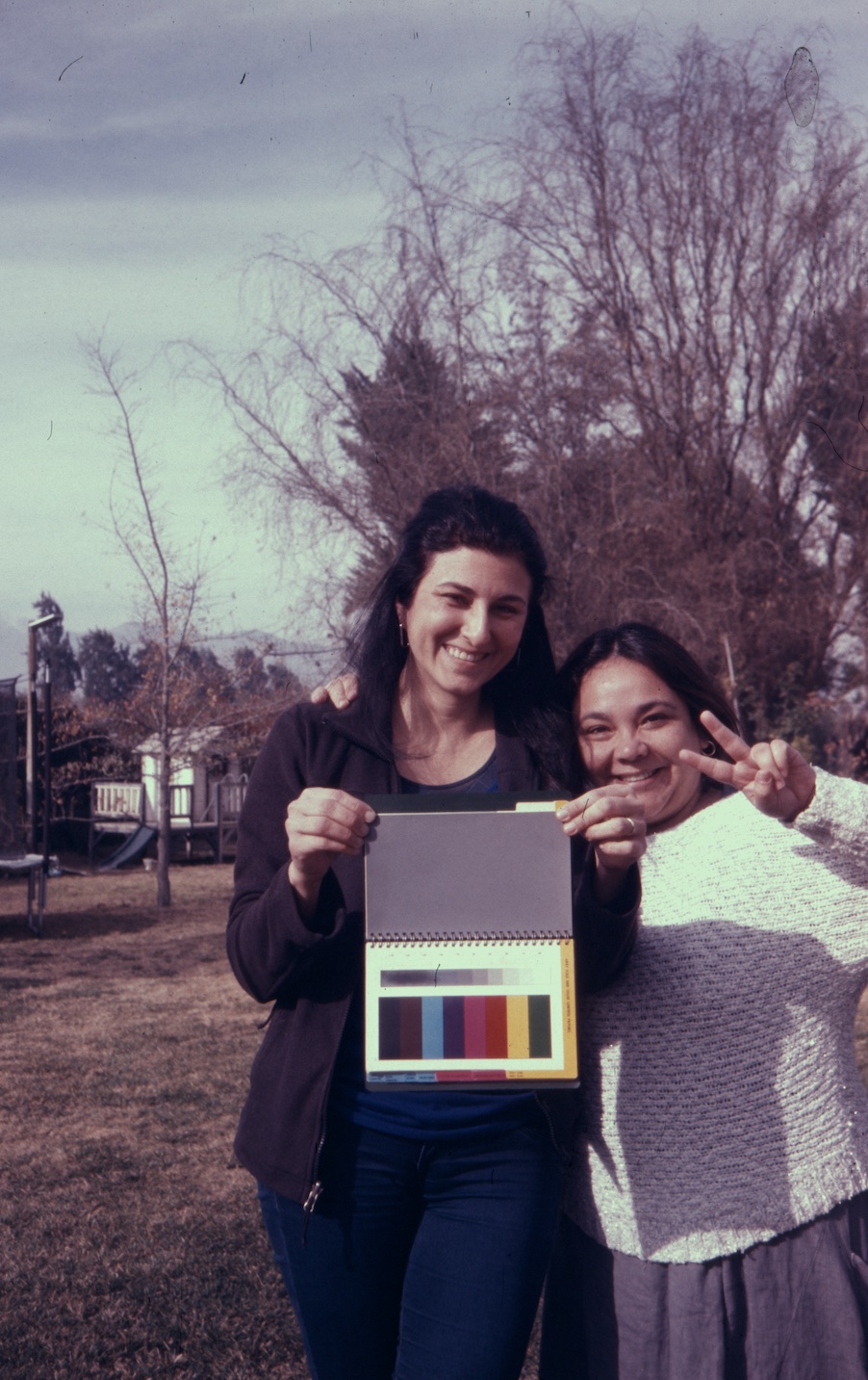

Just the past week I received a box of 12 Sensia 100 rolls, all expired in 2001. I developed some test shot on D76 stock for 12 minutes then light, then C41 developer for 3,5 and 5 minutes (almost no difference) and finally Blix for 15 or so minutes (all that at 40C). The images have some kind of magenta - blue cast that can be somehow corrected after scan. For projection I don't know, when I a see the test shots with one of those thing to see slides against a light they look better than the scanned images, maybe is just the eyes "auto white balance" doing is thing.
Here are some pictures, the one right from the scanner and another after some adjustments,
Also a shot of the base film, I don't know if that is base fog o the slide base film is a little gray.

Interesting results! However i am not familiar at all with the chemistry you used.

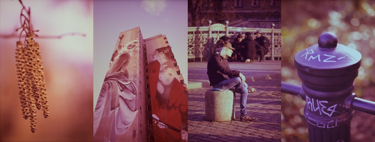

The roll i have is even older than yours as edge code is RD instead of RA. I think the formulation is the same as the pre-provia Fujichrome 100D. I shot another roll from the same batch some years ago and the magenta cast was much more pronounced than in your case (some low res scans below). Unfortunately experimenting with chemistry other than tetenal's e6 kit is not an option for me right now. I think i will just shoot it normally or overexpose+pull and see what happens.
