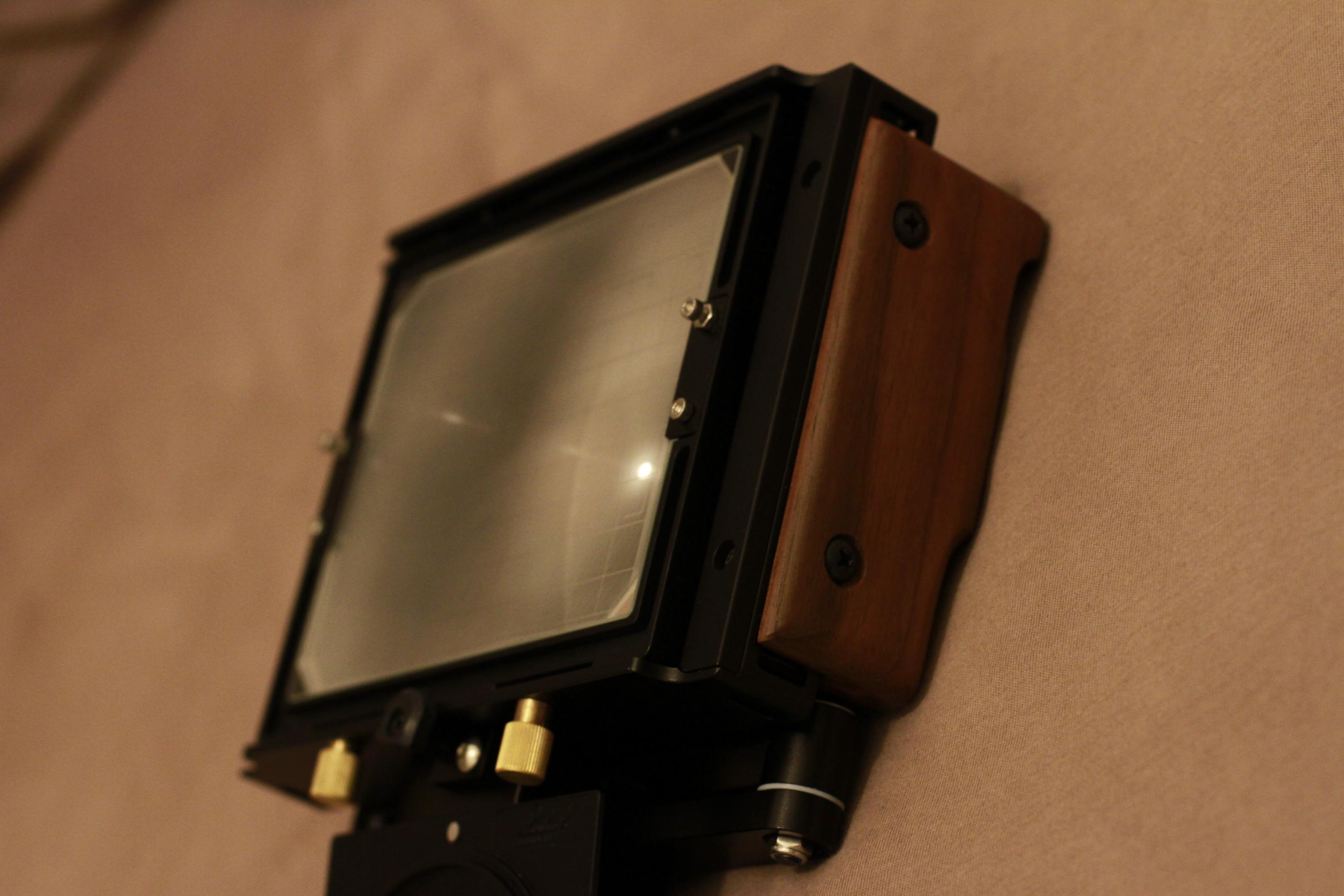

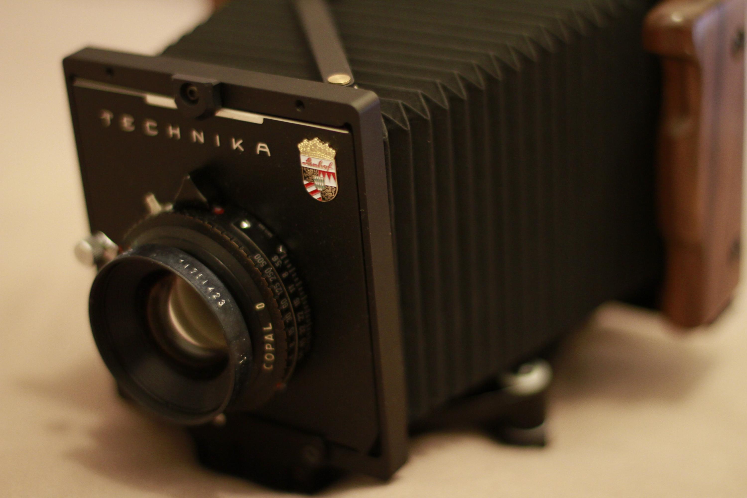

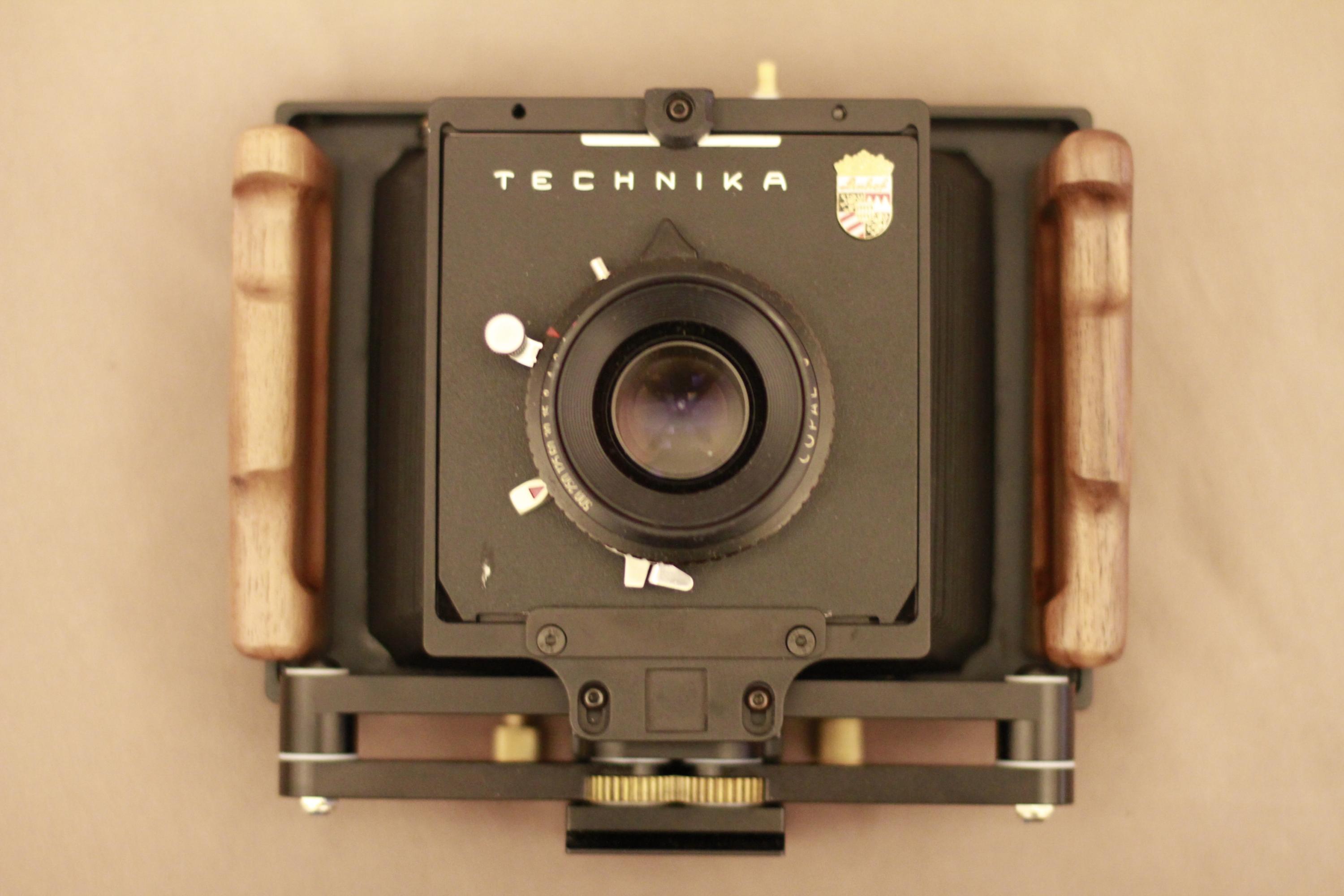

There is no movements on this 4x5 and it suppose to have a rangefinder up top but I removed it cause it was inaccurate.
If you had this what would you use it for?
Its lighter than 1Kg (I estimate 800g, I dont have a scale right now :tongue:)
flange distance is 55mm - 185mm
:smile:

Is that a true Linhof Technika model, or is it just a Technika lenboard?
Looks very Alpa to me...
Clemtography
Apr 15, 2013
15
The reason it looks Alpa is because it uses the same dimensions for the handle.
and its also just the lens board
Clemtography
Apr 15, 2013
15
Use it for a handheld 6x12 panorama camera by attaching a Da-Yi 612 roll film back. You'd want a focus helicoid for your lens.
I actually have a used horseman 6x12 back and I use ground glass to focus it :smile:
Im not sure why you would need a Helicoid.

Looks like a Bull Dog 4x5 from England, I believe. It is a DIY kit made from brass and MDX board. They also make an 8x10 version. www.bulldogcameras.com
I'm struggling to see any similarity with the Bulldog whatsoever. Can you explain what you're seeing that is similar? This appears to be a metal camera (sans the handles), whereas the Bulldog is mainly timber.

Almost looks like a law enforcement ID camera. If you always stood the subject of the photo in the same spot, and the camera was always in the same spot, you don't need much adjustment, probably don't want any.
waynecrider
Feb 8, 2003
2,580
Georgia
It's pretty cool looking. Just use it for it's intended purpose or as a lightweight camera on a lightweight tripod. At least it has a GG. I've used Graphic's handheld that didn't have a rangefinder.

Yeah, it's possible to use the Graphics without the rangefinder, I do it all the time, it helps to use a setup that allows you a broad depth of field. I've gotten really good at estimating 6ft and just setting focus to that and using the viewfinder for framing.
EdSawyer
Sep 3, 2008
1,793
It looks really well made. I'd be interested in learning more about it, and interested in one if others were available. Looks like a great rig, sort of like a Chamonix Saber only maybe more well made ?
