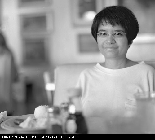

Here's one cropped from 4x5", handheld wide open Zeiss 135/3.5 Planar--
