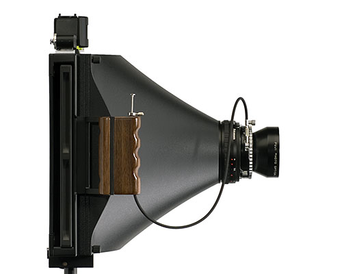

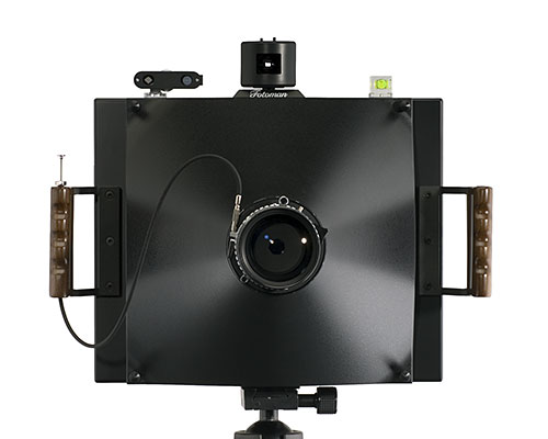

The Fotoman 810PS would be very suitable, but the longest lens useable is 305mm. Attached is a pic of the 810PS with a Fujinon 250/6.3 mounted. More info here... Dead Link Removed
  • Fotoman 810PS:250.jpg
