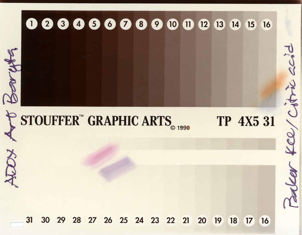

The absolute smoothest base coating to apply color to is a silver gelatin emulsion coated on glossy baryta paper. ADOX makes an excellent product. (Freestyle carries it. Unfortunately, it seems to be out of stock right now. Hard to know what the future holds for any product. Freestyle says to call for availability.)
When you coat with your own emulsion, the emulsion is the layer you color on. Commercial glossy paper has a hard super-coat over the emulsion to protect it. Protection is all and good, but sometimes the coating resists dyes just long enough that they don't lay down absolutely evenly. "Bare" emulsion accepts dyes just like a watercolor paper would. Dyes are also the coloring method with the most detail control. In contrast, there's limited control with photo oils. And, dyes sink into the emulsion and the image, rather than riding on top of the paper like colored pencils do.

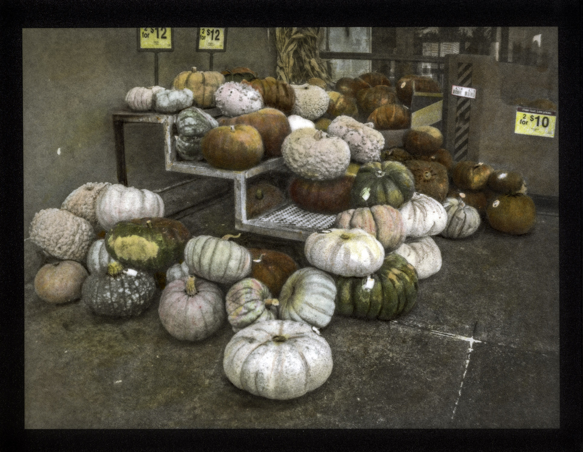

I only have one sample of ADOX with emulsion that I wanted to play with, and it's POP emulsion, but emulsion is emulsion as far as coloring characteristics go. I'm posting a contact print of a step tablet with a couple of swatches of dye, and a crop of the same. If you have a 4x5 step tablet, you can compare the size of detail possible. Also, for comparison to baryta, a (dyes) hand-colored print made with silver gelatin emulsion on Rives BFK. (I haven't posted images to Photrio for a while. Let's see if I can do it right).
note: gelatin POP isn't considered "salted paper." That's a separate process with several variations. Depending on the paper used, it can be a lovely substrate for colored pencils or pastels, and I believe there's an artist who puts watercolor paints over salted paper.
