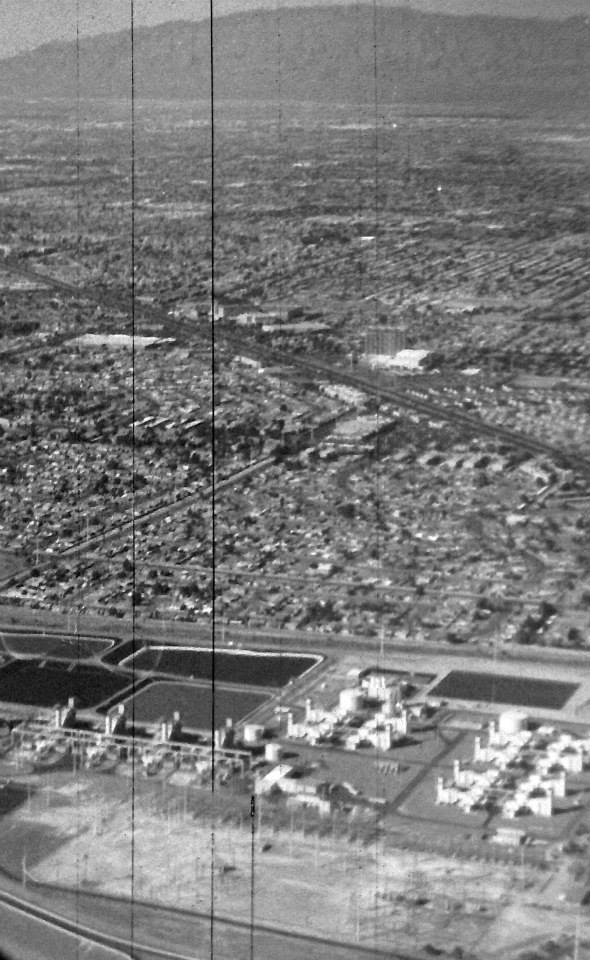

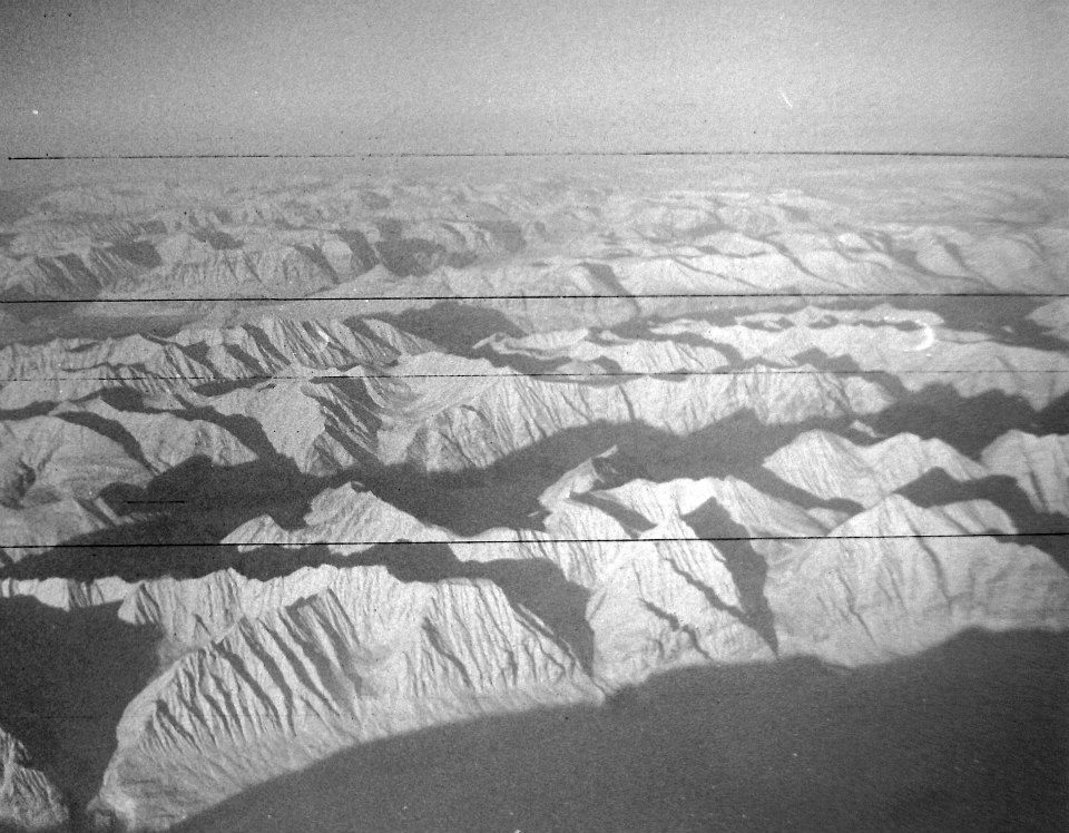

I've been occasionally using a Halina 35X which I inherited from my great aunt about 12 years ago. Not the best camera in the world but a step up from toy cameras and quite fun to use in it's way. It gave her 30 years of good service and until recently worked for me too.
The last two rolls of film I put through it had severe scratching horizontally across the negatives...varying but present to some degree across both rolls. They were different films from different batches so I think I can rule out a film problem. Although the film chamber and "gate" area of the camera has some wear, I cannot feel anything sharp.

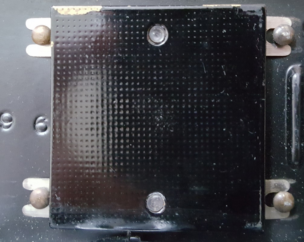

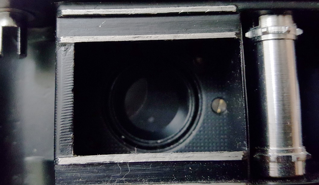

I've attached pics of the camera, the back and some low res scans of pictures with the scratches. Any ideas?

They are scratches. You do not need a feelable nib to cause scratches. If this has only just started happening, you could clean the inside around the film gate with a damp microfibre cloth. It Halinas are not worth a lot of bother.
The other possibility isdirt in the cassette felt .- only really happens if you roll your own frombulk rolls of film.

Are the scratches on the emulsion side of the film or the backing side?
Emulsion side- the area adjacent to the cassette chamber next to the film plane is rough or holding dirt or the take up side of the film gate is rough or holding dirt.
Backing side-the pressure plate is rough.
Take a nylon stocking or similar and drag it across the film path with the weight of the material only on the film path. Any place it snags is the scratch cause.

Your fourth picture is the film-gate, and I see a slightly raised lip on along the left side that is rough. I suggest that you carefully bend that lip downward by tapping on it with a hammer and block. Or you could file it down.

Thank you. I will do as you suggest, as it's the only thing I can see which might cause an issue. I actually have another 35X for which the two slowest shutter speeds do not work and could also swap the back - thus eliminating the pressure plate
The only odd thing is that those little dings in the left side of the gate have been there as long as I've had the camera, and they didn't cause problems before. The last two rolls I put through the camera both had the same scratching. One was Paterson Acupan 800 and the other Acupan 200...both from proper metal cassettes and not hand loaded cassettes. So I think issues with a reused cassette can be ruled out.
Looking at the negs it is actually quite difficult to be sure but I think they are on the emulsion side.

Well....I banged the dents out of it....and that bright, shiny little camera which looks good on the shelf is also going out and about. It is back to it's best. Nope...it's not the best camera ever by far, in fact I am sure my Ilford Sportsman is better, but it fits in my pocket and has enough manual controls to make it usable.
