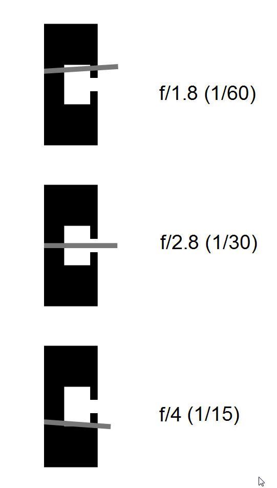

OM-4 Observations
I just did this observation on my OM-4 with 50mm f/1.8 lens (with the camera on ISO 400 and pointed so that an 18% grey card filled the viewfinder) in Auto mode the shutter speed scale in the viewfinder has increments of 0.33EV
  1. at f/2.8, shutter speed indicated 1/15 + 0.66EV
  2. at f/4, shutter speed indicated 1/8 + 0.66EV
  3. at f/1.8, shutter speed indicated 1/30 + 0.66EV to 1/60 (bouncing between the two)
I very carefully repeated my observations several times to ensure that I was making consistent observations about segments being displayed on the OM-4.
OM-1n Observations
So then I took my recently calibrated OM-1n, and repeated the observations with the same three aperture settings, and observed this
Note that the 1EV displacement of the needle from f/2.8 to f/4 resulted in the needle covering fully the white space between the edge of the white opening and the needle, but the (between-2/3-and-3/4 EV) displacement from f/2.8 to f/1.8 left a visible gap in the window. The OM-1 viewfinder marks do indicate 1/3 EV increments (1/3EV when the needle just touches the black 'tab', 2/3 EV when the needle just covers the tip of the black 'tab', 3/3 EV when the needle just touches the edge of the white window opening) The needle position for f/1.8 was NOT equivalent to 1/3 EV nor 2/3EV nor 3/3EV positions of the needle.
I very carefully repeated my observations several times to ensure that I was making consistent observations about needle position on the OM-1.
Conclusions
From these observations I contend that the OP observations have no bearing...both OM-1 and OM-4 behaviors seem to reflect the in-between 0.66EV and 0.75EV true aperture value of f/1.8, and the increment of the detents for f/2.8 and f/1.8 is NOT a 'a half stop out' as is contended.

OM-1n Observations
It is hard to tell what you're trying to show there as your example changes both shutter speed and aperture, creating essentially the same three exposure with very different meter indications. And while one may be able to infer 1/3 stops on an OM 1 or 2, Olympus' intention was for these meters to indicate half stop increments.
