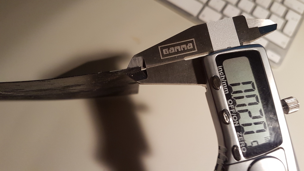

My brother has some scrap metal lying around his job and thinks it might be appropriate, hence the question.
