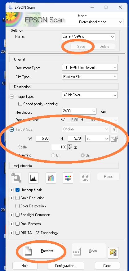

I don;t know if this might help. But can;t you setup and/or save settings by some combination of Target size and then Preview >save that would give you back all the manual frame lines?

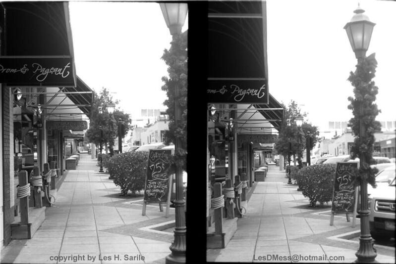

Here is a scan of two half frames taken with my Olympus FT and scanned as one using the Coolscan . . .
Kodak TMAX 100 by Les DMess, on Flickr
