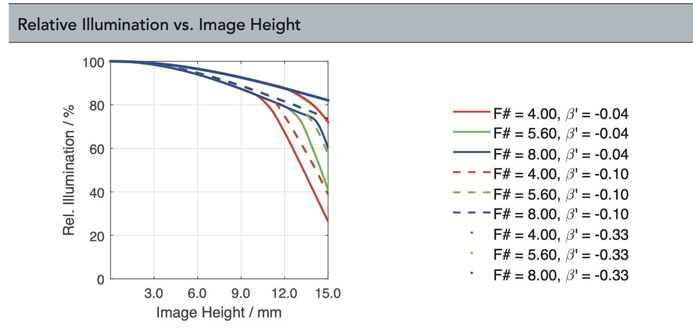

Schneider 28/f4 image data. Diagonal of 18x24mm "Half Frame" = 30mm
So, a 11x14" would be about 30x enlargement.
The table below only goes to 25x. The solid blue line is f8 at 25x which seems acceptable coverage at the corners. Just make very sure the lens is perfectly centered on the negative. I can describe my method with laser if interested.

Just don’t assume that 28mm or 30mm will cover HF.
Nearly all 28mm enlarging lenses cover half-frame. Minolta's is an odd one. You would think it would cover because of it's longer focal length, but Minolta made it (6 elements) with a smaller image circle for 12 x 17mm -- so it clips the corners of half frame.
By my maths, it's about 14x. 24mm is nearly one inch, if this long dimension of the format is enlarged to the long dimension of 14"... it's 14x.
