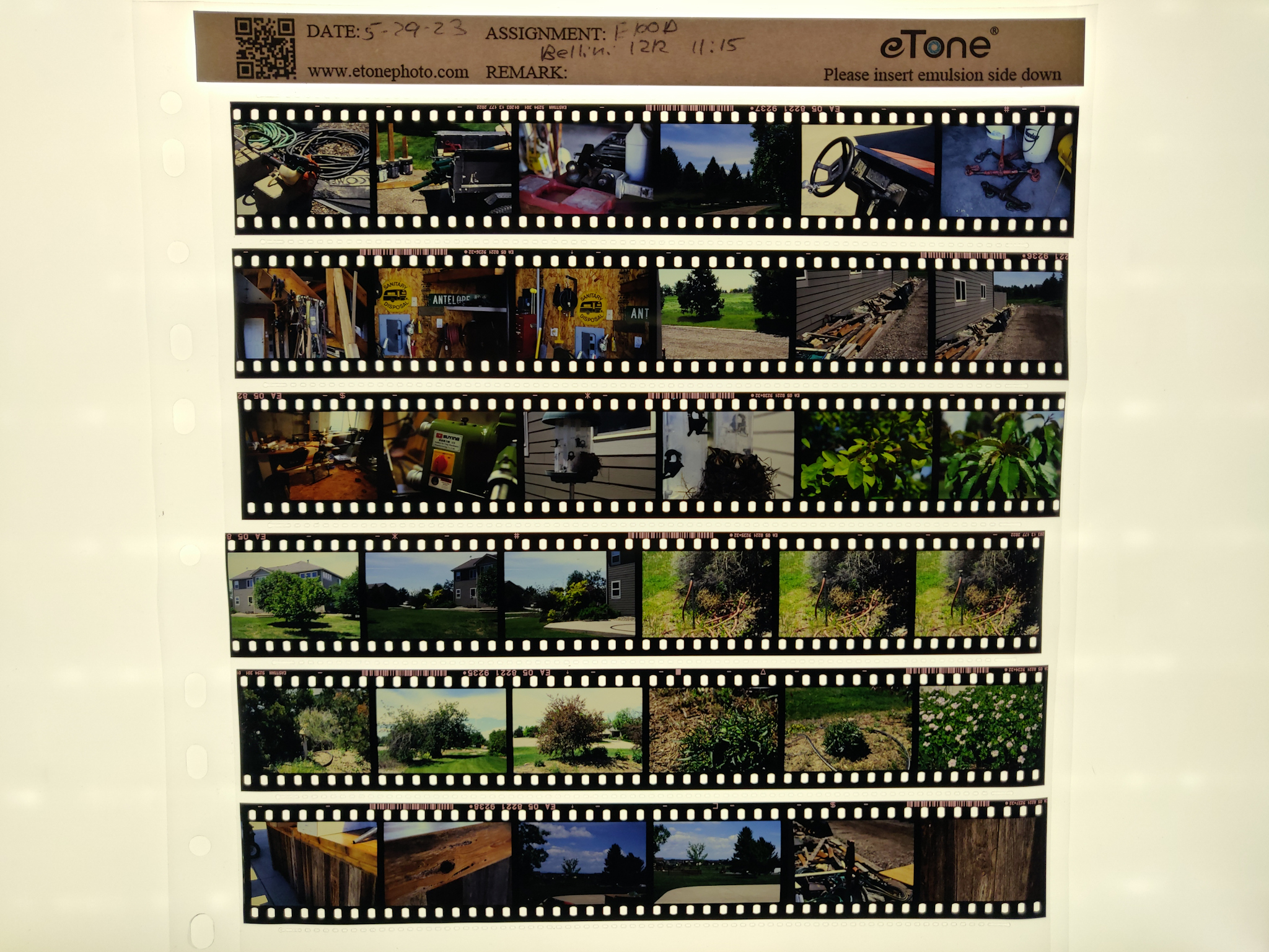

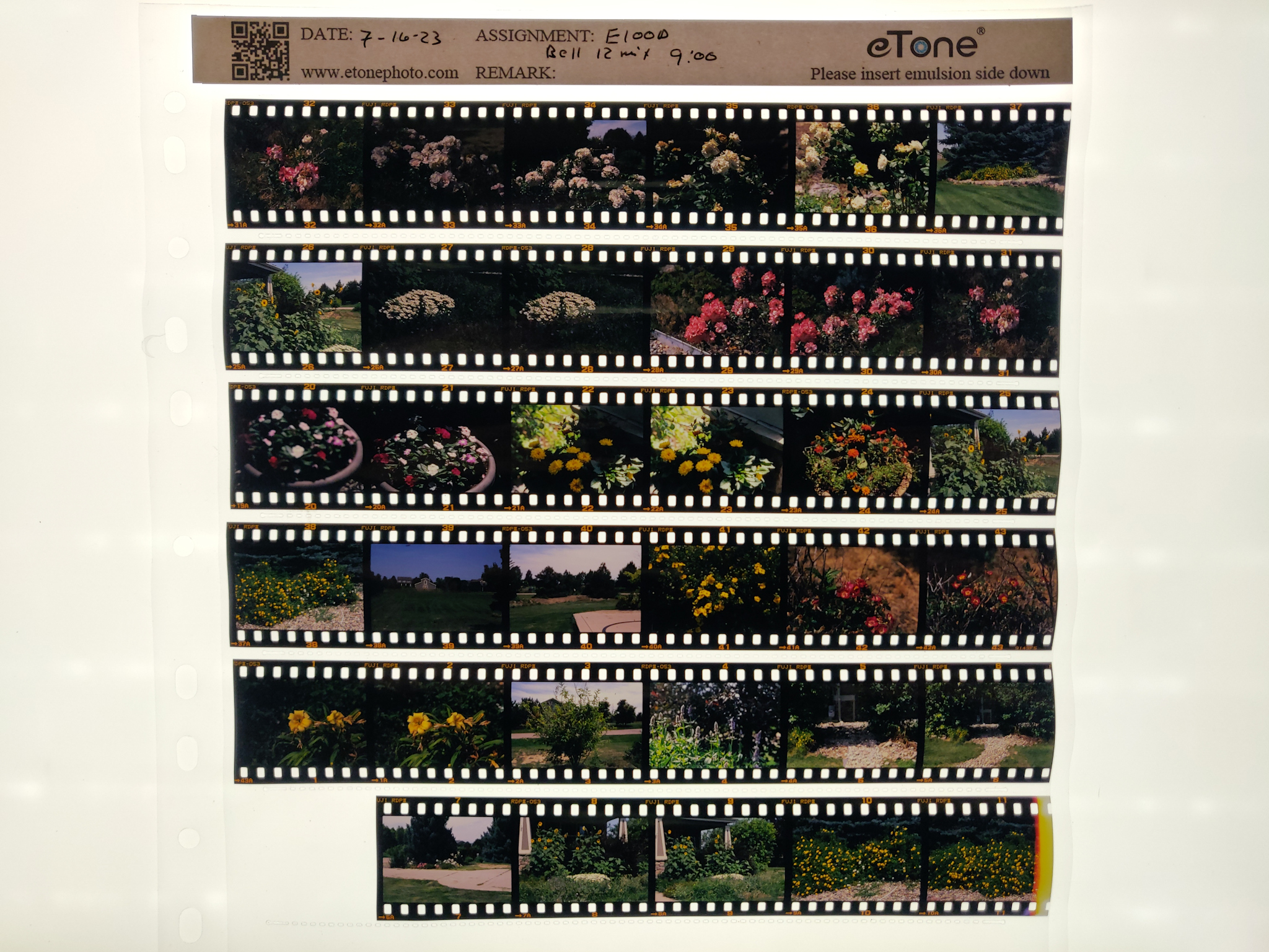

I guess I'm going to go against what most are saying here.
When I was processing things one shot ( most because I was not processing often enough to get good use out of mixed chemistry ), I worked out new dilutions and times to process C41 and E6.
I went about it deciding what was a target number of rolls I wanted to get out of a kit.. Say that was 12 rolls ( say a 1 liter kit ), if one of the components was 250ml, 250/12=20.8ml, I would mix that with water to make what ever volume I needed for the tank. This gets sticky because how well or even if it will work depends on the tank you are using. For a 35mm roll for example, my Jobo only needs 140ml for a roll, I don't think this would work as well for a tank that needs say 500ml.
Here is a sample using a Bellini E6 kit. I used an FD times of 11:15 and 9:00, I doubled the rest of the times. It did take several rolls to dial in what I think worked well for me. I never finished tweaking the Bellini kit, was well dialed in with Tetenal ). I found that mixing 500ml at a time, I could adequately use up the chemistry before it went bad ( 4 months or so ), so I stopped doing the one shot..
It's not impossible and all depends on what are acceptable results to you.
