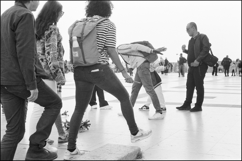

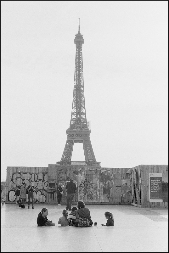

I've been trying out Kodak Double-X lately. On-line reviews have suggested it is not great in bright contrasty conditions because the highlights tend to run away. So of course I was curious to try it in such conditions. October sunshine in Paris provided the opportunity. The film coped very well, far better than I expected. But I re-discovered what I should have anticipated: why most modern films have an anti-halation layer.
So then I wondered why the pressure plate isn't somehow coated to reduce the light reflected back through the film backing. This photo was taken on an (old) Leica M6, in which the pressure plate is a plain smooth sheet. I remembered that my old Nikon FE had a textured pressure plate. I never wondered why. Is there in fact anything that the camera manufacturer can do to reduce halation, and if so, why don't all manufacturers do it?

Are you sure what you're looking at is in fact halation? It looks too sharply defined for this. Furthermore, halation tends to make highlights bloom; in your case it seems a sharp duplication of shadow areas. Are you sure the effect is present in the physical negative?

What camera? As stated by koraks, one sees a slightly offset ghost image. Shutter rebound? I've had this with a Compur shutter, and have not found the cure so far.
Did you look closely at pictures taken with other films but same camera, at shutter speeds equal or close to the picture shown?
Now there's a very interesting thought. It is difficult to look for the duplication in the negative because being the highlights those parts are the densest. Just in case it's the scanner, II will try scanning the negative rotated 180 deg (but still emulsion down) and see what happens.
A ghost image posted on Halloween, but not halation. I don't think it's the camera to blame, are you sure the negative hasn't moved when it's being scanned?
Leica M6. These are interesting thoughts, friends. I admit I didn't think of any alternative explanations. I will report back after further investigation.

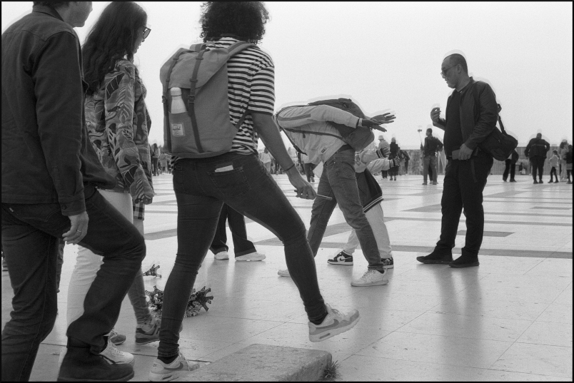

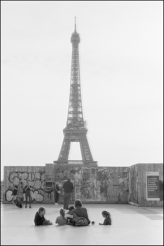

This has been really instructive. Thanks to everyone for your suggestions.
First, I could make out nothing on the negatives. They aren't stupidly dense, but sufficient to make me unsure whether there was/wasn't a ghost image.
Second, adjacent frames shot at the same (pre-set) shutter speed did indeed show similar ghosting. Like this one:
However, I've just tried re-scanning exactly as before, and the new scans have no ghost images.
So I don't know what was going on with my scanner, but evidently it was having a bad day. It isn't credible that I knocked it during scanning for each of half-a-dozen consecutive frames. On the other hand, not every frame scanned on that day and from the same sequence of shots had ghost images.
Anyway, mystery solved: it was neither the film nor the camera. My apologies to both of them, and thanks again for your help.
