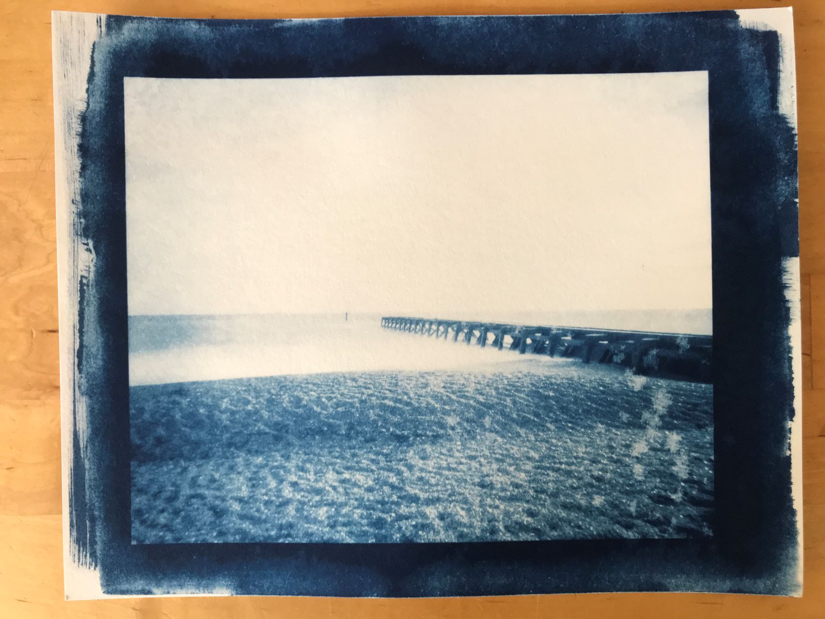

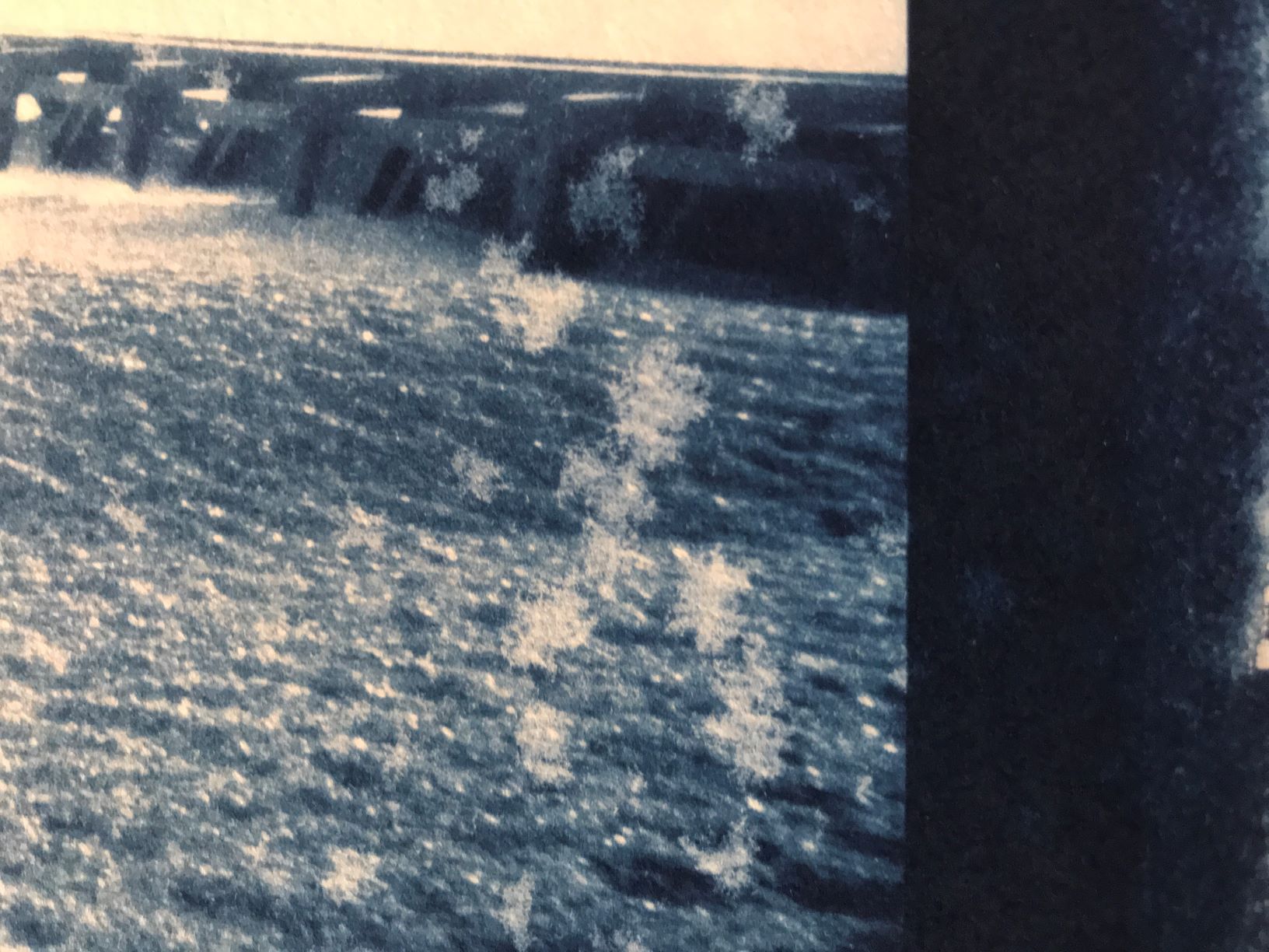

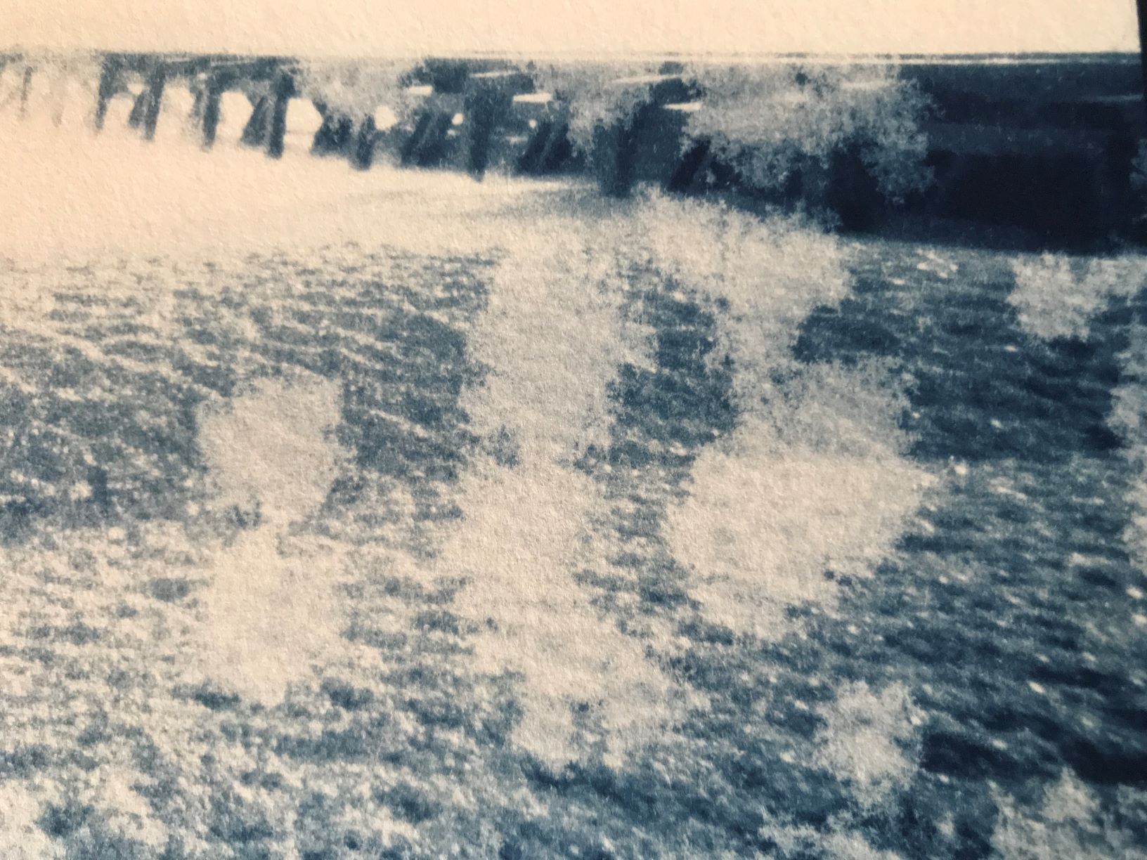

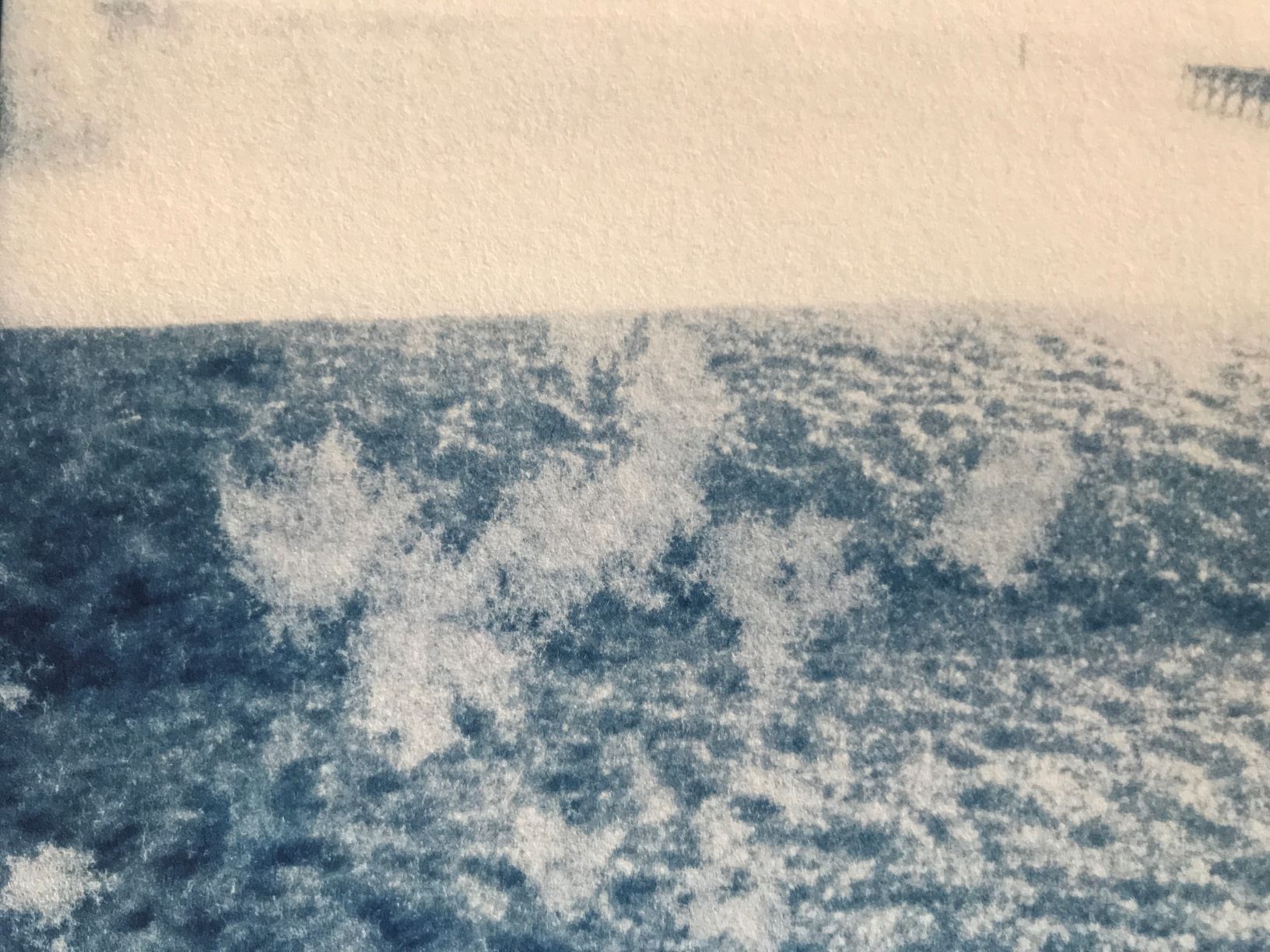

Hey, I'm having problems with coating Platinum Rag with a Mike Ware Cyanotype solution. I can coat this same solution on Arches Platine and Bergger COT 320 with no troubles. I've tried lots of things. Different brushes, coating rod, no Tween, varying amounts of Tween, air drying for several hours, hot air drying. Although the paper appears to coat evenly and looks fine when dry as soon as I expose you can see the issues even before "deving" in either water or 1 - 3% Citric Acid.
My last attempts were with 3 drops of 20% Tween 60 in 2ml of solution and 1 drop of 60% Tween 60 in 2ml of solution for an x10 paper. Obviously the dilutions and drop sizes of the different Tween dilutions is a big variable. If I've used that amount of Tween on any other paper the solution has pretty much soaked in straight away and saturated a small area and not been able to coat completely.
I've been using the same exposure time and (digital) negative as I would for Bergger COT 320. I'm so confused. Anyone able to shed any light on what I have done wrong.

Looks like something is wrong with the chemistry. Maybe try just the original formula with out any additives a clean brush and if there is mottling paper must be contaminated..
I usually get that on cheap paper I havent pre processed properly and using a wetting agent. Wetting agents are finicky some paper react bad.
Never had an issue with Platinum Rag and consider it the best of all papers, wish I could get it locally. I just brush my emulsion on after humidifying the paper.

Coat some Arches Platine and see if you get the same issue or not. I only ever had issue with HPR if the RH was way too high or too low. I've never had to use Tween. I'm assuming your cyanotype solution is fresh? Sorry, I've only ever used the traditional formula.

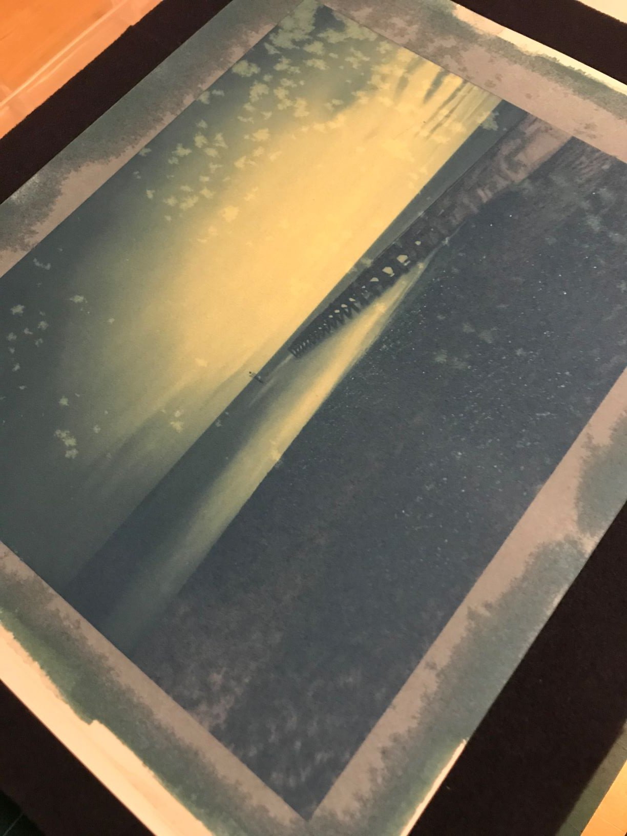

That's really useful info Niranjan, thanks. I've tried another brush (which I think was contaminated) and with considerably less sensitizer and things look ok. I think I was going down a spiral of adding more sensitizer and Tween as the coating was just sloughing off which leads to it crystallising. Fingers crossed that was the problem.

Hey, I came across a video on Bill Schwab youtube channel talking about acidifying his Tween. Apparently its very Alkaline and needs to be mixed with an acidic solution. He was having problems with clearing. He uses 1% Oxalic acid at 1:1. I don't have that so I tried 2% Citric acid at 1:1. Seems to have fixed the problem so far.
