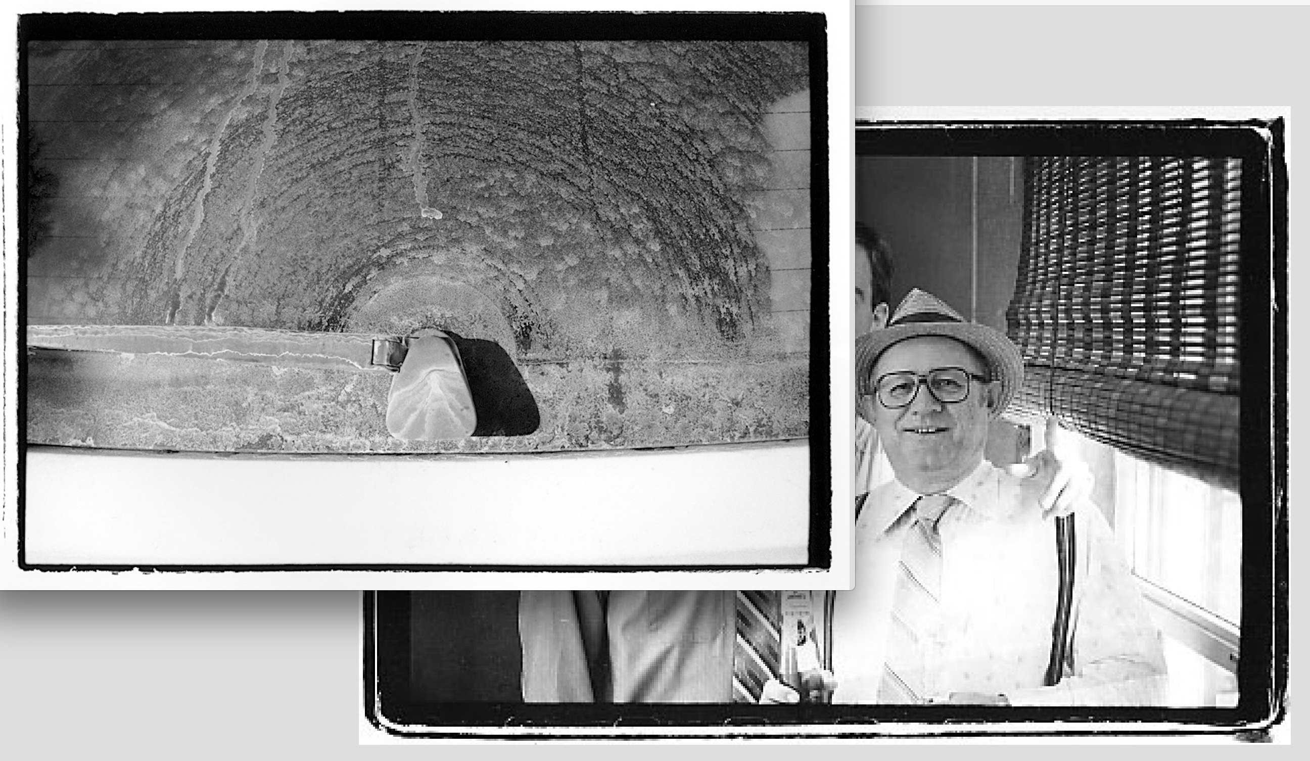

In my opinion, some carriers look better than others. Shown are two examples. The image with the thin border is printed with a carrier that uses thin inserts (Omega D5500). It is not as dramatic as the underlying image. In the underlying image the entire thickness of the carrier is visible and I think it looks better (Minolta Mod III). In both cases the filed edge is left unpainted.

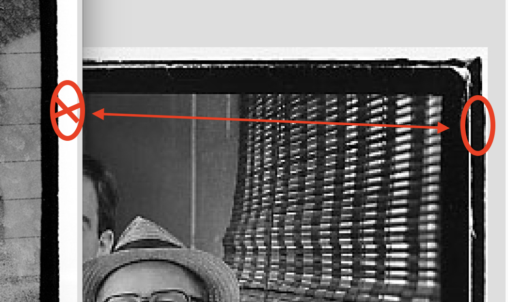

Just to be clearer. Painting over the shiny edge removes the BLACK edge in the resulting print. With that extra black border removed, It kind of makes the resulting prints look like you just have an easel with bad blades.
