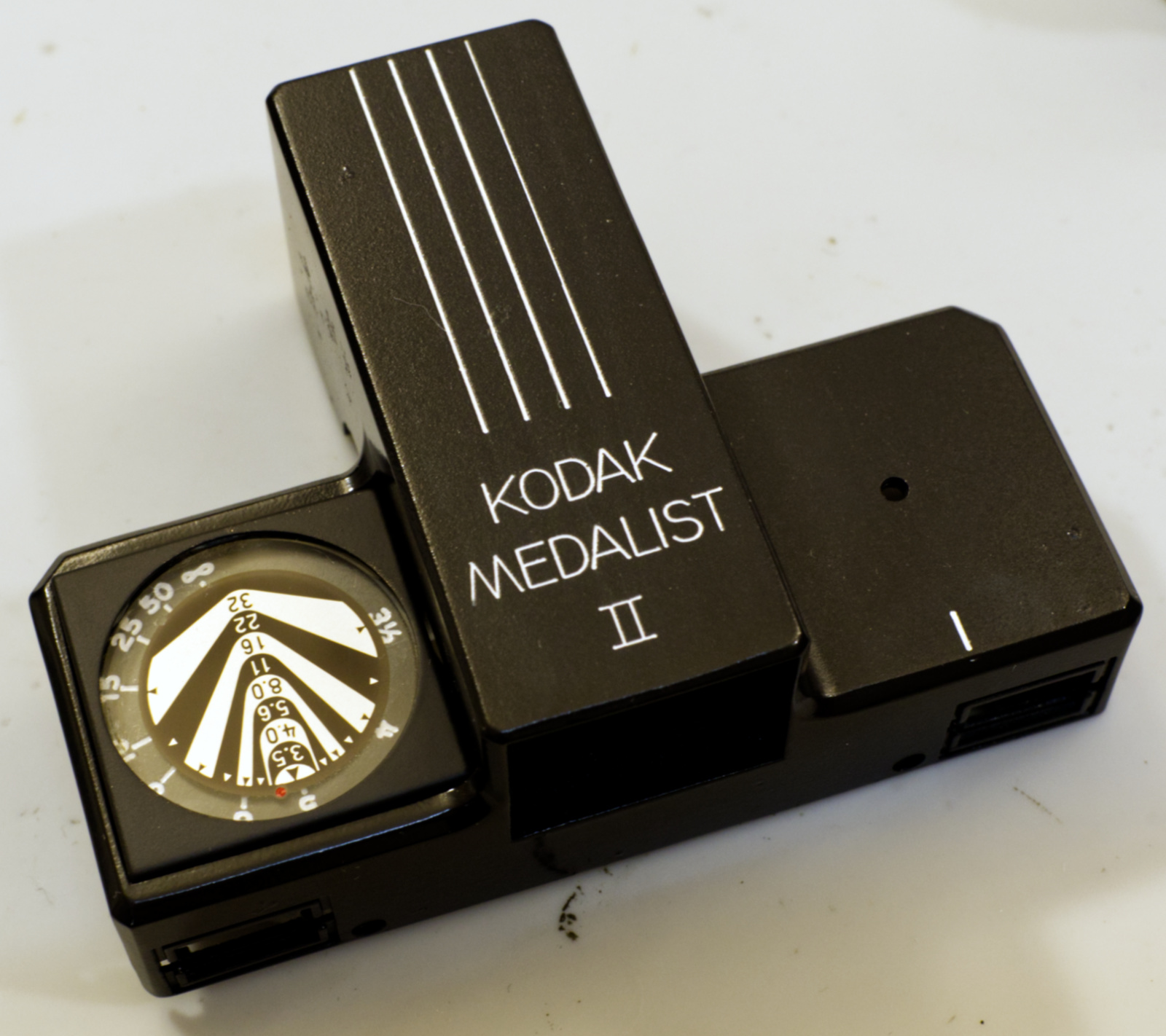

hmmm.... cerakote coating. enamel inlay (rough still).
Dan Daniel
Jul 4, 2009
2,885
upstate New York
Interesting, How did you make the revolving distance scale black with white numbers?
The numbers are etched into the dial. There are various ways to infill recesses like that. Here I use model enamel paint and overfill. Let dry then come back with naphtha on a wipe to lightly wipe away the over-filled stuff. In this case the black coating will not react to the enamel or naphtha. Not always perfect- you can see the right line of the four lines gets skinnier for the upper 2/3 from the wipe pulling a bit too much paint out.

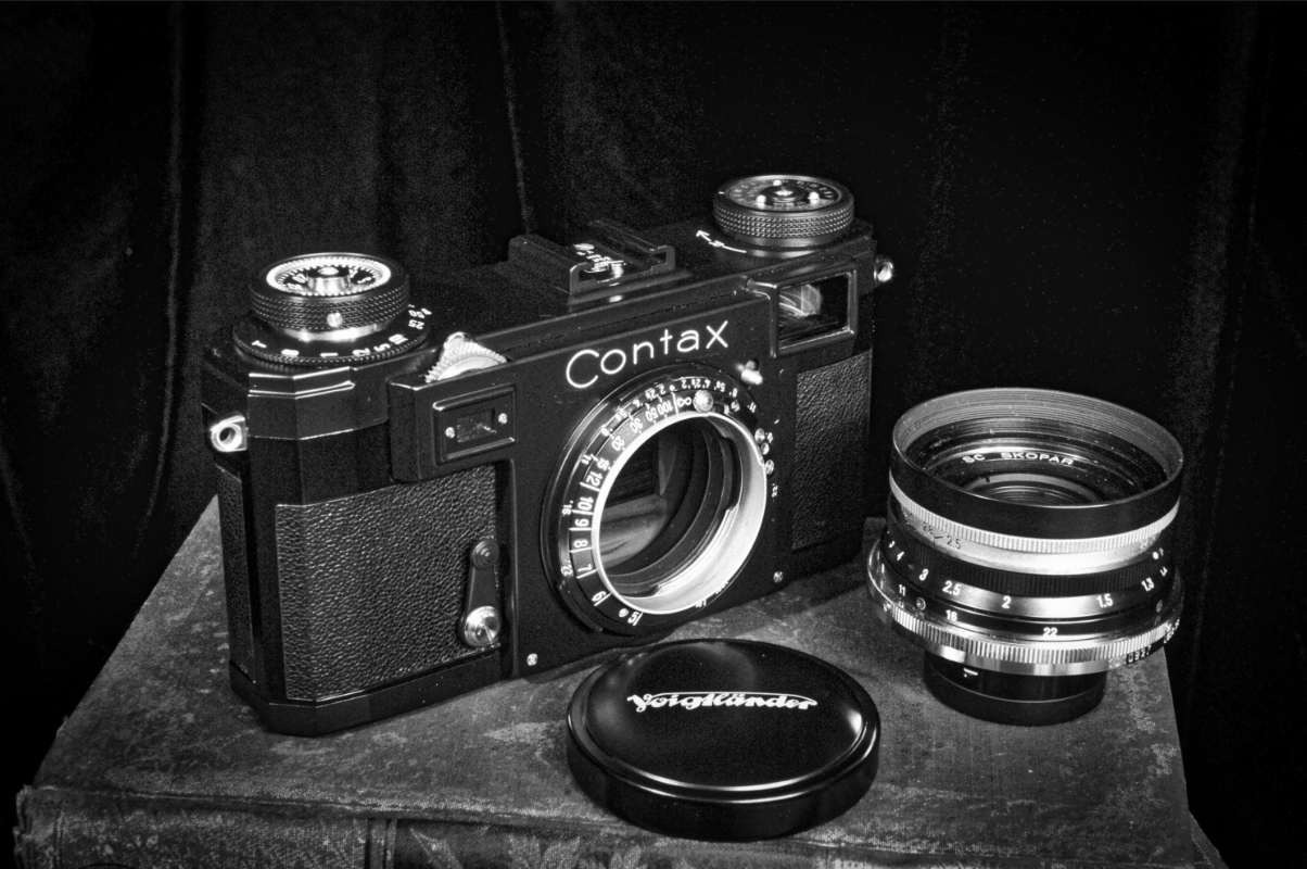

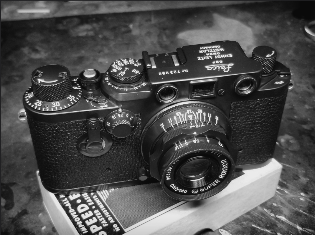

Here's a couple of mine...
