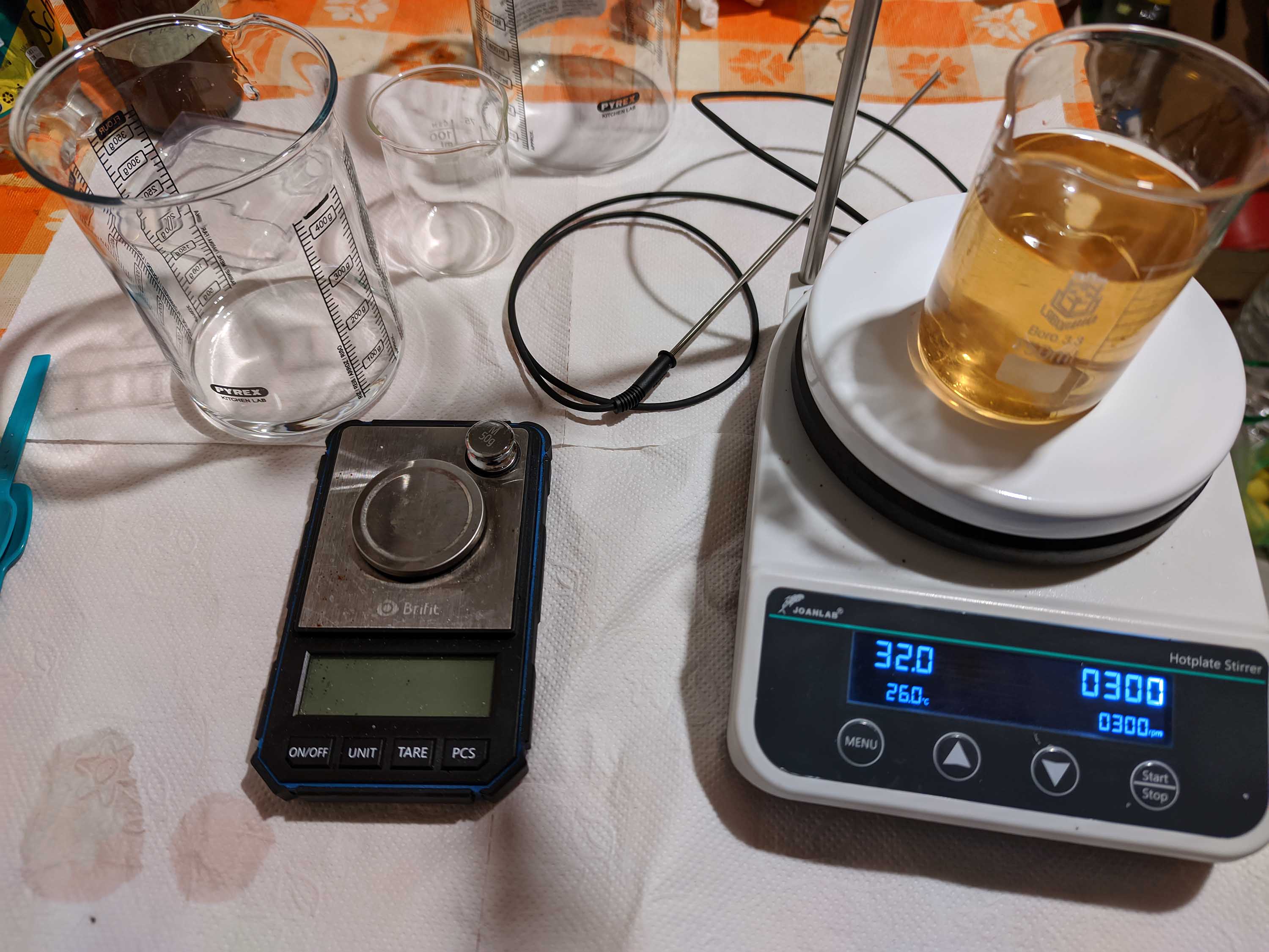

I made a new concentrate as follows:
In 50 ml of water (deionized), at 50C/122F, I dissolved 9 g of sodium sulfite (limit value 27.0 g/100@20 ml). Then I added the carbonate to the same solution. I dissolved Hydroquinone and Phenidone in 50 ml of glycol. I mixed the two solutions and added water to 132 ml. Everything dissolved, the concentrate looked good. I stored it in a dark glass jar, which I left in a room at a temperature of about 16C.
After only one day, this concentrate began to crystallize. I have no idea why - the amounts of the chemicals are small enough for their limit values...

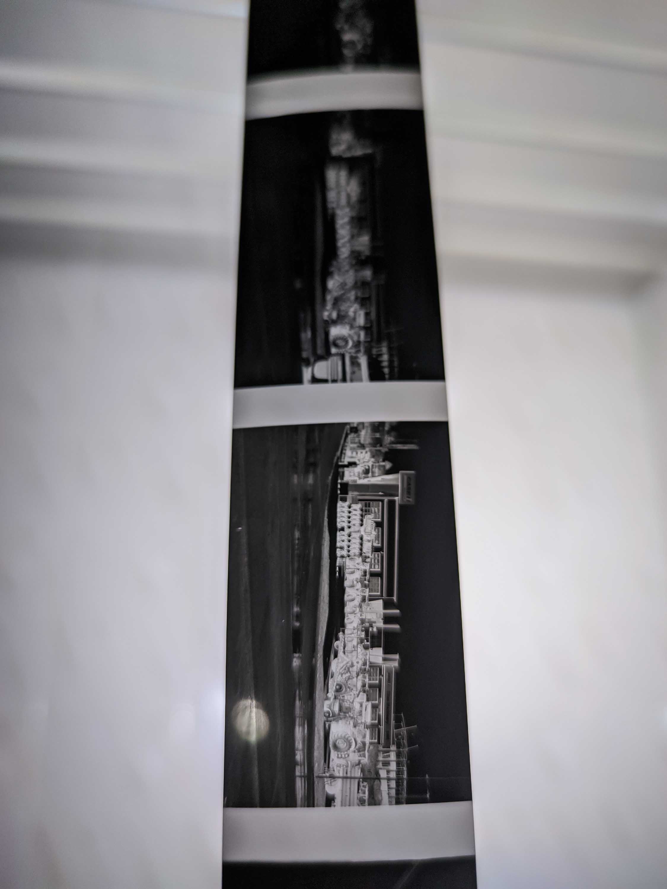

I decided to test the concentrate anyway despite the crystallization. A little while ago I received Kodak Imagelink HQ Microfilm - I had never worked with one, but as far as I understand, the film is rated around EI 12. I did two tests (on the first one I accidentally opened the film back to the light) at EI 12-25- 50. I got extremely thick negatives (will try to get something out of them). But at least the result is not a complete failure like the previous one. Processing: 18 min at 21C, 30 seconds initially, three turns every minute. Apparently, the processing time was too much (I got it after searching the internet for results). Maybe my stirring is too intense. The next samples will also include EI100...
What should I really expect from Kodak Imagelink HQ? What is its actual speed?
Interestingly, the composition of this developer includes very minimal amounts of chemicals. One liter of working solution contains only:

For comparison, there are 30 g of sodium sulfite and 1.5 g of phenidone in POTA. Development times in POTA are 12-14 minutes, but a whole stop is wasted. So I assumed 18 minutes for H&W Control was normal...

My personal EI-time combo was ISO 25 and 8:30@20℃ with normal agitation.
As for the solubility issue, you can double the volume by adding more water/glycol and cut the dilution in half which is not too inconvenient due to the very high dilution suggested above.
H&W control had higher working pH than POTA which boosts the activity of the Phenidone-Hydroquinone combo, making it a high-speed, low contrast developer.
