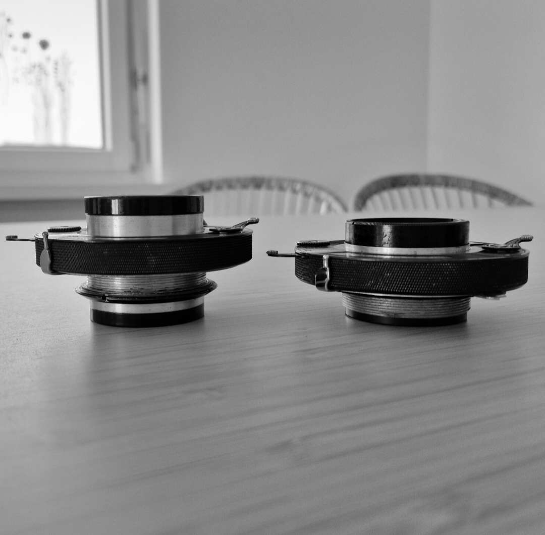

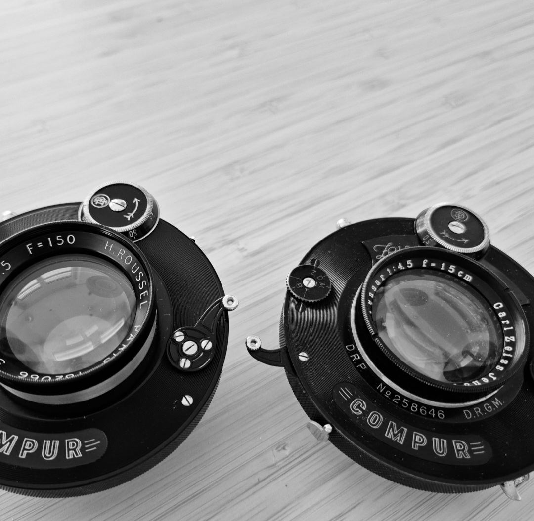

Hi,
I bought this lens in new condition and unfortunately I cannot find any information or contradictory information, what type of lens is this, there are 3 groups but some write its a tessar type other write its a cooke, a tessar is on the right and it is much lower than the Roussel lens.
Thank for infos and help.

Look at the reflections of the rear group under a lamp. If you see two clear reflections and one faint, it's an achromat, which makes the lens a Tessar-type, but if you only see two clear reflections it's a triplet. That the whole lens is "taller" on the table could just mean that the formula is different from the Zeiss Tessar, even if the type is the same. The Ross Xpres lens on the Ensign cameras are slightly slower at f:3,8 than the Zeiss Tessar, but the front element is larger due to the forumula being different, but it's still a Tessar-type.

OP, don't be so !@# coy. Show us all of the Roussel lens' trim ring, or tell us the name engraved on it.

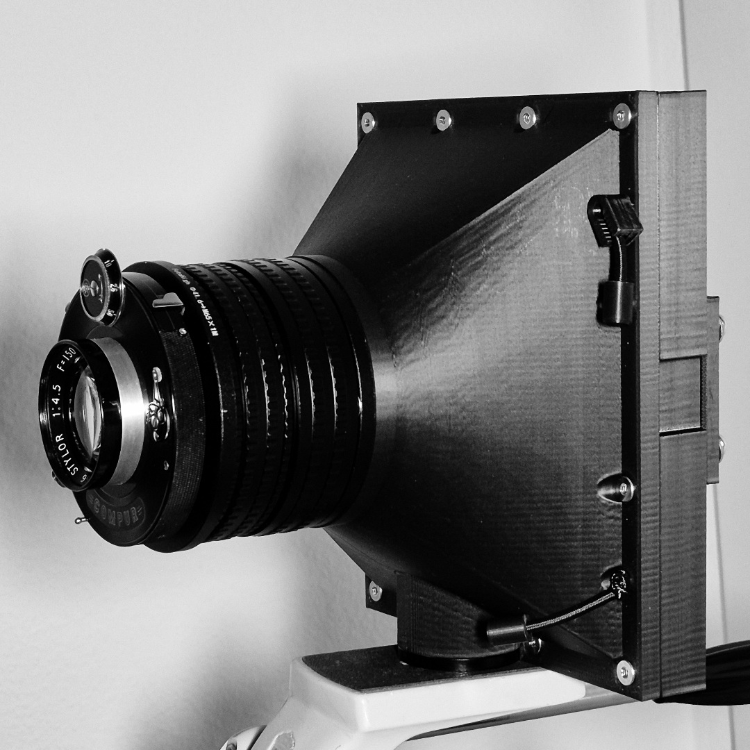

It seems to be a tessar type, the ffd of my tessar 150/4.5 is 142mm the one of the roussel lens is 154mm, today i finaly got my lensboard drilled to fit the roussel lens to test it, i would like to use it as a portrait lens. Will post soon the first image.

I would like to thank you for your help in identifying the type of lens, I am writing late due to a lot of stress around me, hoping that I can escape to a photography holiday to cool off.

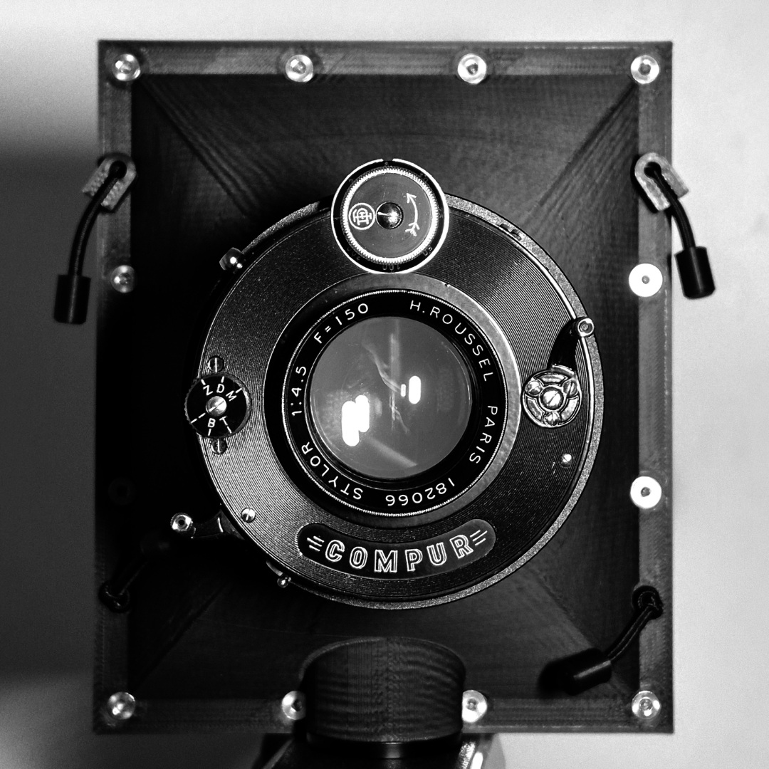

That looks good. The Stylor was the Tessar-type made by Roussel. They also made a triplet called Trylor.

It is a tessar type.
OP, I did a Google search on Roussel and Stylor and Tessar. Try it.

Also Allen Greenleaf includes the Stylor in a list of "Some lenses of Tessar construction..." (Allen R. Greenleaf, 1950, Photographic Optics, The MacMillan Company, New York.)
