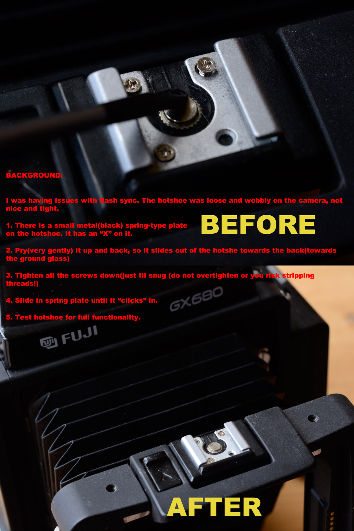

However, the other day I ran into a small issue:
THE HOTSHOE on the front standard is "loose". It wiggles. And thusly, the hotshoe doesn't always trigger when I need it to using Pocketwizards.
DOES ANYONE KNOW A HIGH QUALITY(as in Fuji certified) TECHNICIAN FOR THE GX680III system? Its just that one issue, but if I'm sending it in, I figured I might as well get a full checkup done on the body.

REPAIR QUESTION:
I called a local repair shop here in LA(Steve's Camera Repair, spoke with Mike(thanks again Mike, if you read this!) and he offered to help. Well the short of it: there are (3) screws UNDER the small "clip" plate in the hotshoe itself. I took some photos, and here's a short "DIY" fix it if you encounter the same problem :smile:

Greetings Dan,
Thanks a lot in the name of many for the repair hint.
