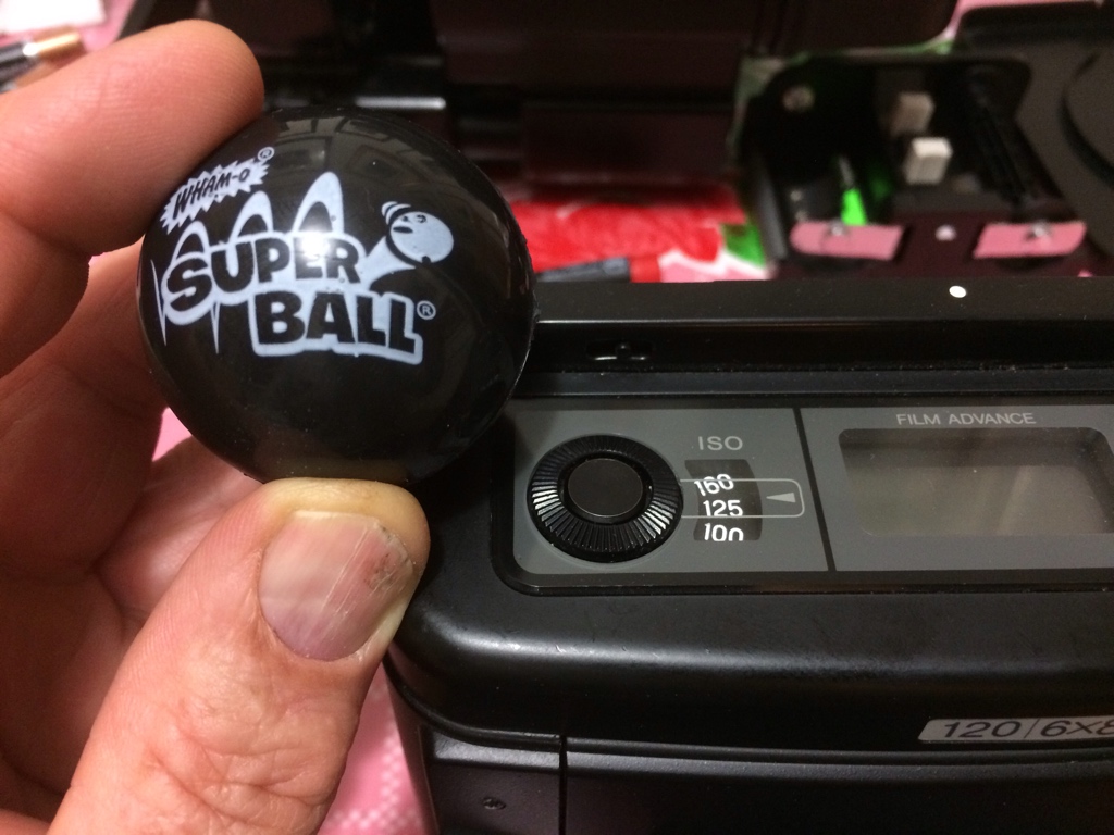

The battery is not to hard to replace although it is soldered in. The hardest put for me was getting the smooth headed screw out of the center of the iso dial. The gentlemen in the video covers it pretty well. I was able to remove the screw on my two backs using the Super Ball method. If that hadn’t worked then I would have tried the his forceps method, but that would have been a last resort as I'm sure I would have chewed up the screw.
