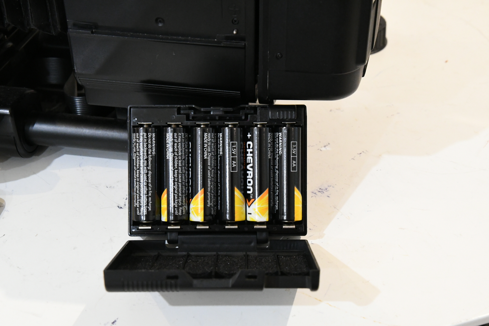

I’m using a GX680 that came with the battery pack adapter the uses AA batteries, and so far works very well. It also came with two backs which I had to open up and solder in new batteries, not too hard and plenty of info online to show you how to do it. Very happy with the camera, using it to shoot old cars around San Francisco so I’m not far to far from the car. The ironic thing is that my GX680 kit with three lenses weighs the same as my 8x10 kit with three lenses. They’re both in backpacks and weigh 26 lbs minus the tripod.

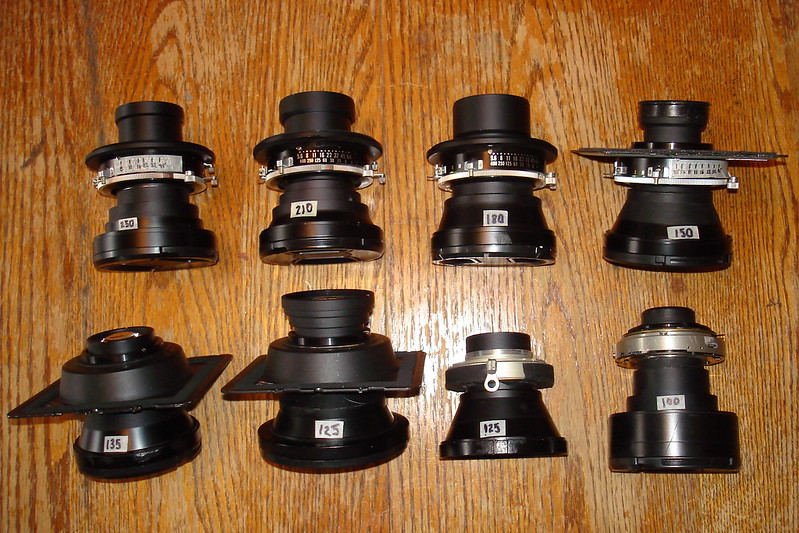

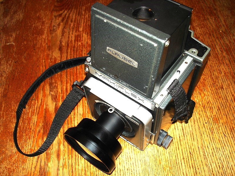

I really like the GX680 glass so I put them into mechanical shutters (Seiko #1's). I use them them on my focal plane Plaubel Makiflexes
I've heard rumors of using them on 4x5 systems... do they have enough coverage for that?

I haven't used them for that purpose. The Makiflex is 9x9cm and they work very well for that.

I'd never even heard of the Makiflex, you can really see where Fuji got the idea....

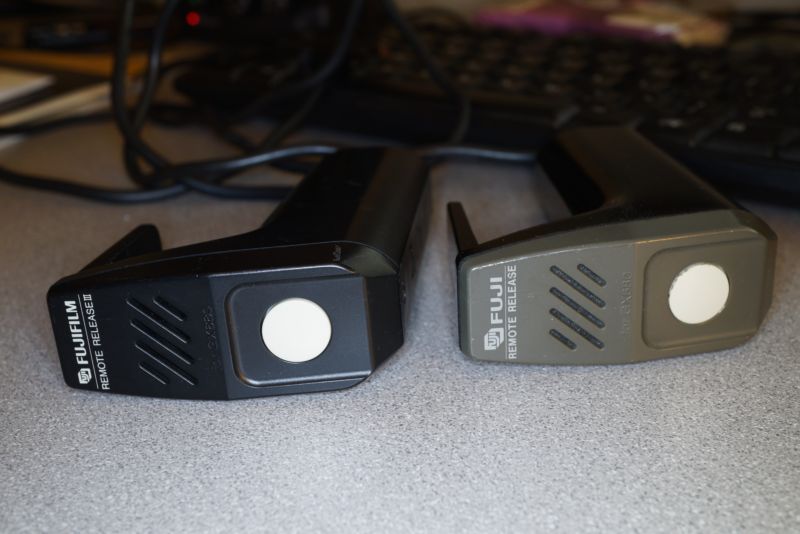

Make sure you get the correct cable release, the III and the I/II are not compatible, even though they both plug in.

Thanks for the heads-up on the cable release... Is there an easy way to tell which ones are compatible with the III?
f
The cable release for the III (left) has a "III" in the name, and is all black. The right one is for the I and II.
