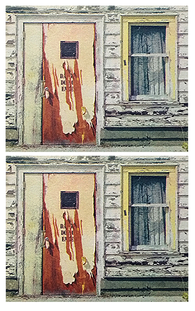

I occasionally use a medium gloss acrylic medium varnish. Four coats, diluted 1+1 with water. I like the slight increase to dmax and saturation. The image on the bottom is the gloss varnish print. I took a photo of the print before I coated it.
