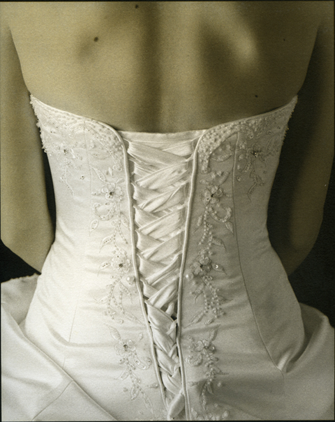

Here is preliminary scan of my results. The scan is not so great. The print, although not yet perfect, looks better in person.
I used raw sienna and burnt umber in a 2:1 ratio. I tested different exposure times, trying to get some color into the skin while keeping the dress white. I had some success, but the dress ended up looking a bit sepia toned. I didn't hate that, but was still not satisfied. In my impatience I painted the gum mixture just into the areas in which I wanted color.
It looks kinda cool, but I think what I need to do now is make several coats of gum, using a short exposure time (15-20% of the Pd time) for each until I get a nice build up of color without sullying the dress.
Thanks for the advice!
Steve

Jeremy
Oct 26, 2002
2,761
Denton, TX
why not brush the sepia off of the dress during development?

Jeremy, I've not tried to brush the pigment off during development, but I doubt it would come completely off. I'm sure most of it would, but all of it? I'd probably still have that slight sepia-ish tint.
Has anyone done any painting in of gum in select areas, maybe doing several colors at once. Similar to painting a silver print?
What I need to do (and am in the process of doing), is be more patient and do several coats of gum using a short exposure, and build up the layers.
Thanks for the replies,
Steve

Brushing off the dress will remove the color from the midtones and highlights of the dress, and likely leave some color in the lower midtones and shadows. To me, this is a nicer approach than having no color on the dress. If the dress is completely without color the image starts taking on a kind of a hand-colored look which I'm not fond of. But, that's just me...

Thanks Kerik. I think you're right, the dress looks better with some tone in it.
Painting the gum in specific spots is probably good for some images, but not this one. It requires a more subtle delicate touch.
I may try the brush development idea. I'll also do a single exposure to get the right amount of pigment in the dress, then add a couple more very short exposures to add extra to the skin tones.
