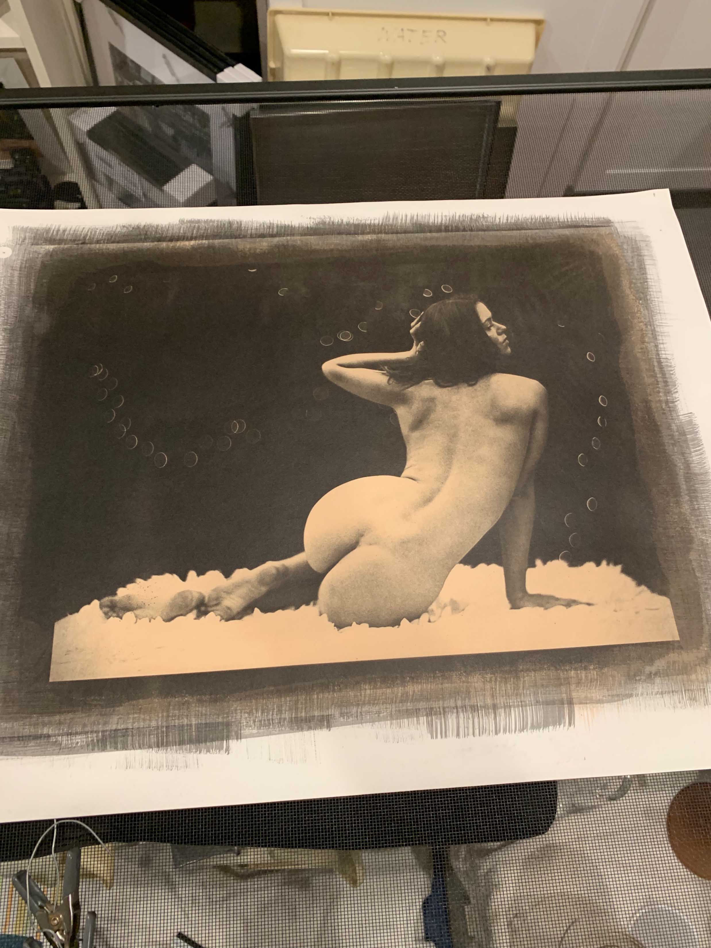

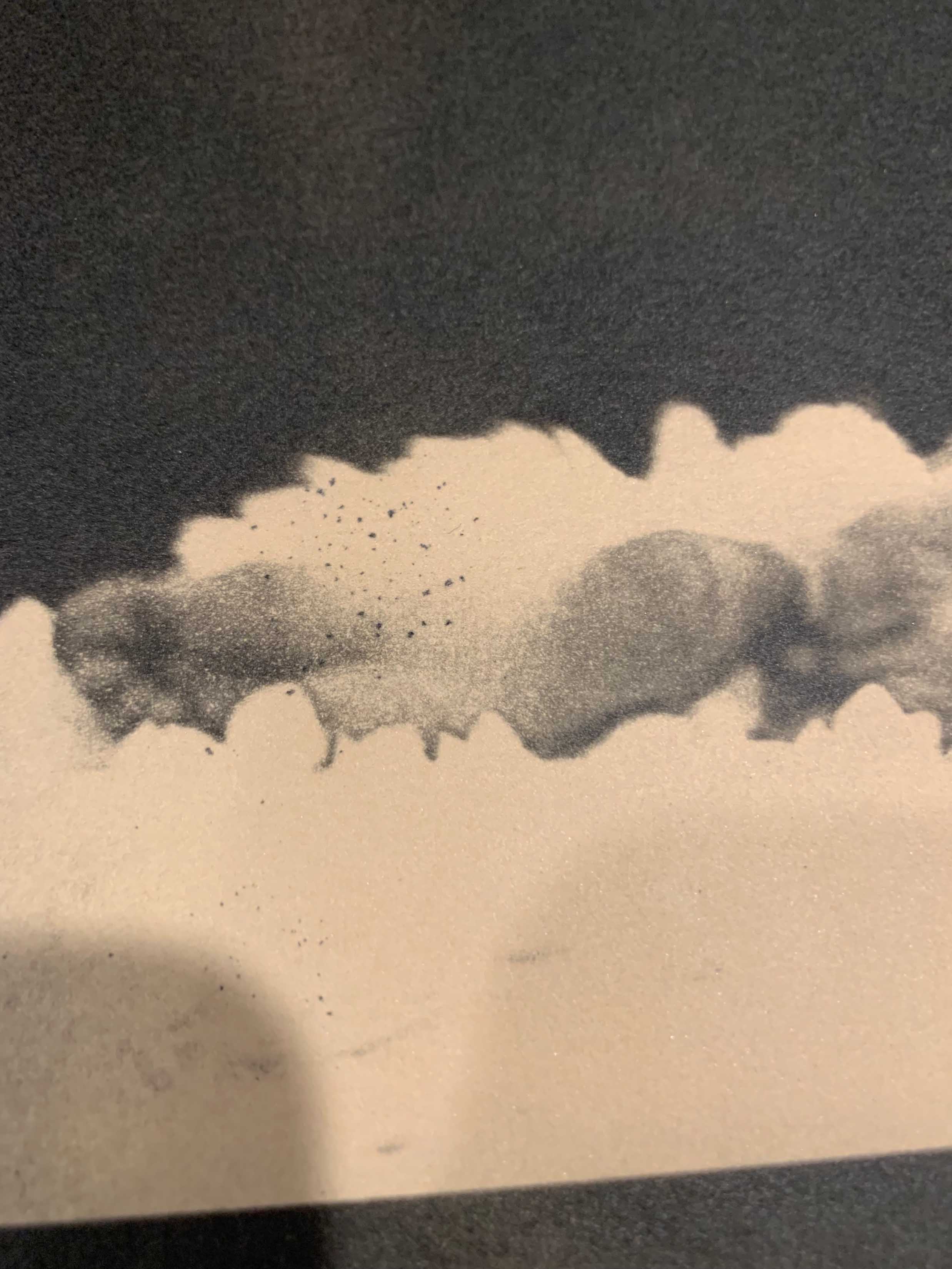

This is what I'm talking about. Not a big area but enough to warrant retouching them somehow.

In which layer do they first appear? I've had specks like that from small particles of solid dichromate that found their way into the sensitiser.
Calvin Grear calls it 'speckling', but I suppose others might call it staining and still mean the same thing, even though it's not a uniform stain like remnants of dichromate etc.
Have a look here: https://thewetprint.com/wp-content/...ical-Guide-to-Gum-Printing-Introduction-2.pdf
Page 17 (which is actually page 25 of the pdf...)
Anyway, my initial advice still stands: I'd scrape them out of the paper with a thin, sharp tool, and then repair the zit by applying a small dab of gum, perhaps with a little pigment added to match the surrounding tone.
Nice print BTW.

Not sure actually, that print has about 5 coats of lamp black on it so either it built up slowly or I just didn’t notice for a while.

Yeah you’re right I actually learned to call it speckling by reading Calvin’s book. Before I ever had the problem actually. I agree with you on the repair method. My buddy Patrick Robert James told me to use a tiny drill bit instead of digging, which is a great idea.
koraks
Nov 29, 2018
23,231
Europe
Oh yeah, that sounds like an interesting approach. I've got one of those generic press stands for a Dremel tool; it would be pretty easy to quite precisely mill away some specs with one of those tiny carbide drill bits. Good idea!
