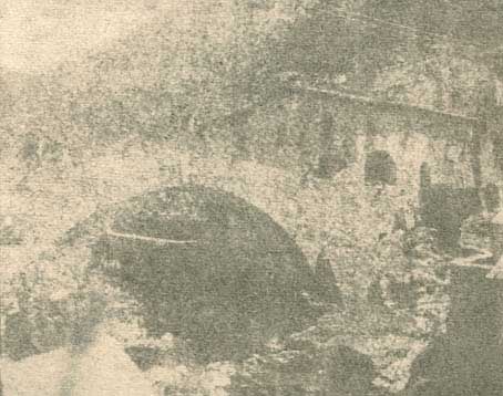

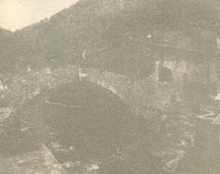

here are some first attachments
0.10g lamp black in 3 ml gum + 3 ml sensitizer (saturaded potassium dichromate)
the stepwedge scan shows print result after 3 minutes exposure
the file gum01.jpg shows the print of a silver gelatin 4x5" negative with same exposure
the file gum02.jpg shows the print of the previous negative with 2 minutes exposure (but I have used 4 ml gum + 2 ml sensitizer for this print, thus reducing the ratio to 2:1)
the scans look MUCH BETTER than real life...

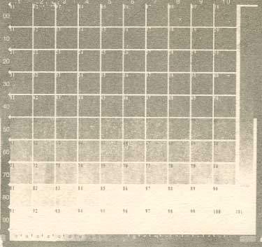

Fulvio
Jan 15, 2005
216
Italy
yes I'm using Mark Nelson's PDN system
I print my digital negatives with an Epson R2400 printer and have no problems with any other kind of alternative process
in the attachments you will find the tone charts with and without curve applied
same exposure time, 3' as indicated by the step wedge before, lamp black pigment - but if I try to print on a different pigment, a natural earth for example, I need to raise exposure up to 15-20' otherwise most of the print will be washed out in the developing stage
again, these scans look MUCH BETTER than actual prints
surprisingly the scanner is picking up more details than naked eye (usually is the opposite)

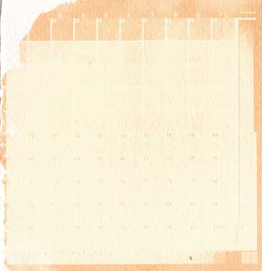

Fulvio
Jan 15, 2005
216
Italy
this is what I'm talking about, if I switch from lamp black to earth pigment...
burnt sienna instead of lamp black, same gum-sensitizer mixture,
same exposure (3'), same curve (pdn), but this is the result
if I raise exposure up to 20' then it's correct, and I get a similar image to that posted before for the lamp black (but with some problems in the highlights, flat contrast, etc.)

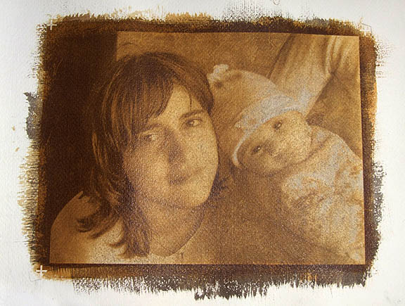

I have my first successful print, it took me several nights to complete (see the attachment)
it's 5 color (mars red, burnt sienna, raw umber, burnt umber... and a final layer of burnt umber + cobalt blue instead of black)
I gave up the idea of using carbon/lamp black... it leaves too many spots in the paper and the effect is unpredictable... Ivory black is too weak, in fact looks like a gray.
I still had some problems
I did not size my papers, though (I'm using Fabriano 5 for now). With earth pigments stains and spots are not an issue. But there were hundreds of tiny dark spots in the white areas (britghtest highlights) when I coated the last color (the umber/blue mixture to replace black). I was able to fix it with some white chalk.
Do you think I can overcome this issue by sizing papers? I don't want to use formaldehyde... I was thinking about a 1% gelatin solution (food gelatin or fish glue) and some 5% potassium alum as hardener... do you believe it will work?
