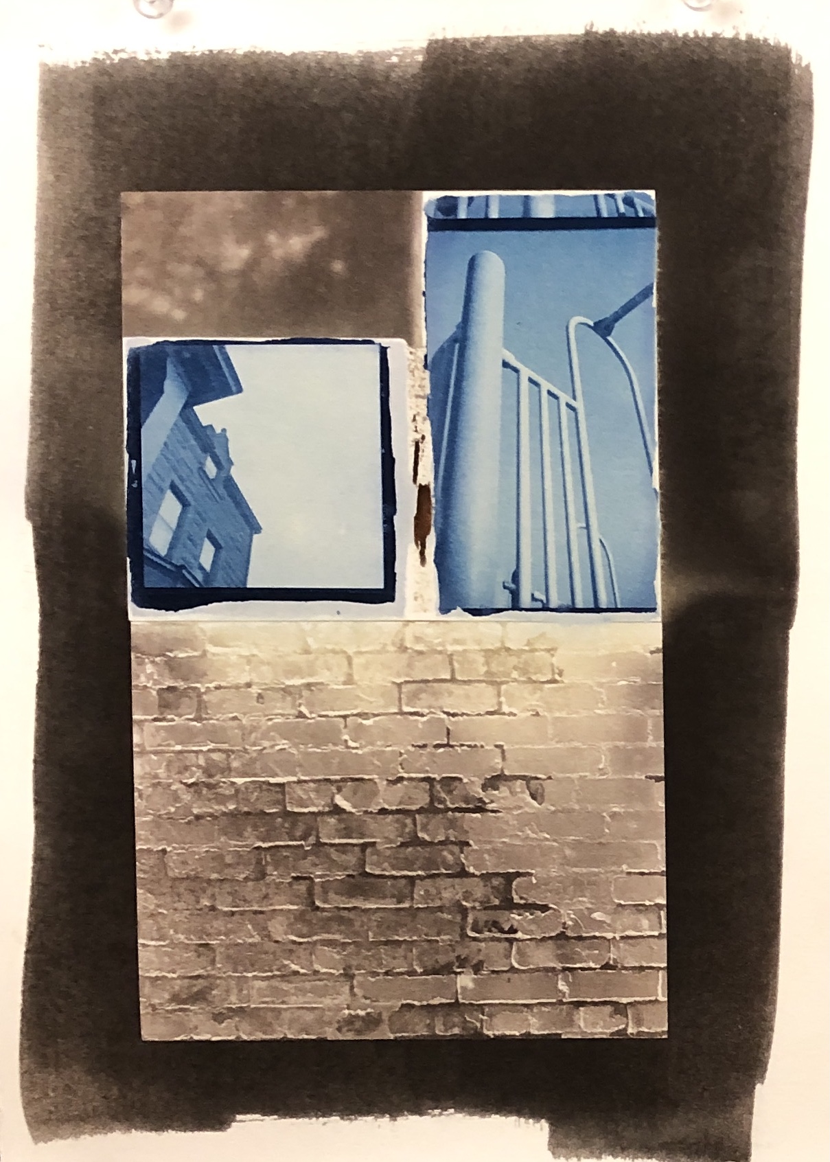

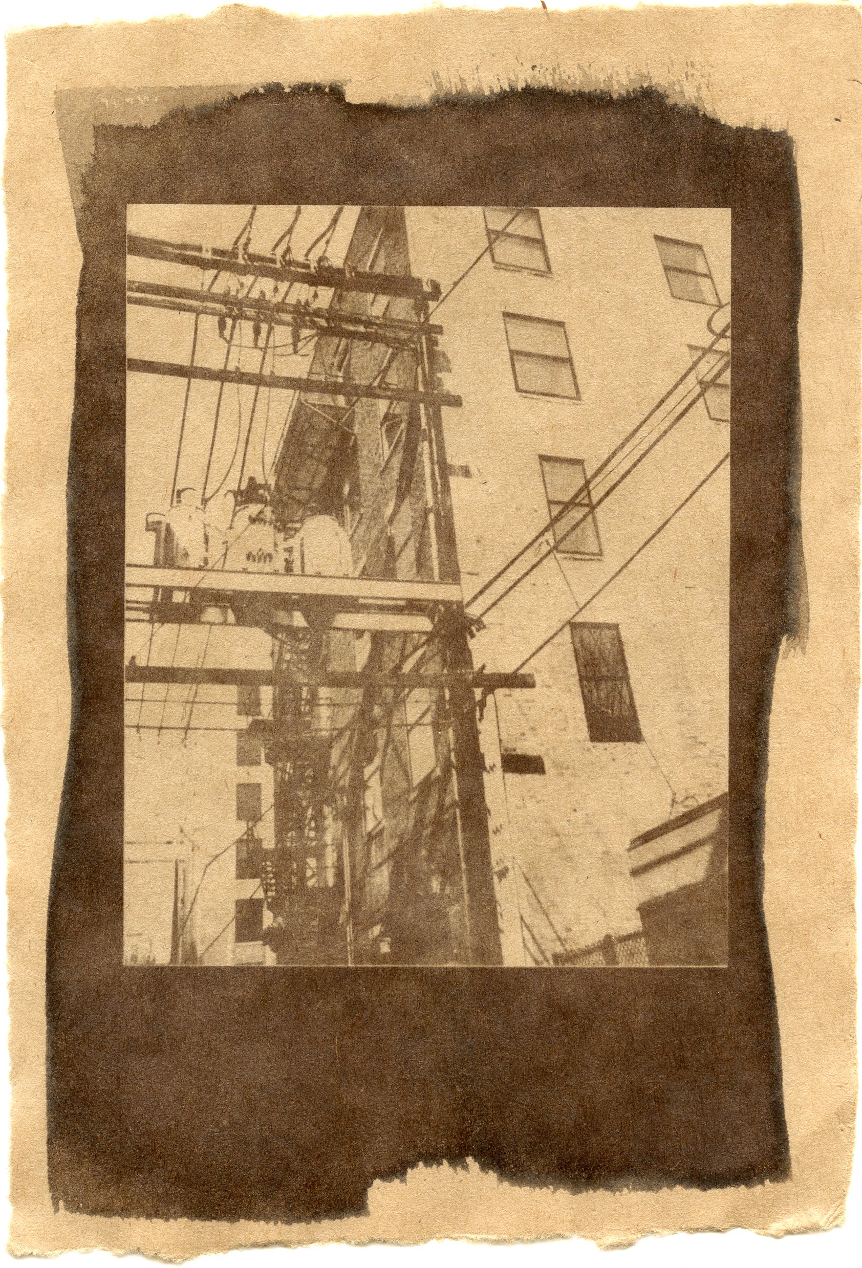

I’ve played with cyanotypes and Van Dykes, in fact, even did both on the same print. Here a Van Dyke on craft paper and a Van Dyke and cyanotype on the same paper.
