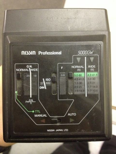

In addition, in manual mode on this flash GN 25 is the lowest setting, if I wanted to shoot at f4 instead of f8 according to the formula, my image would be two stops over exposed right? Is there a way to decrease the power further or is this where a ND filter comes into play?

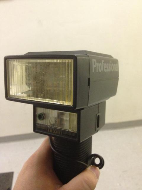

This is what my flash looks like... I plan on bouncing the main head and using the sub flash for fill.

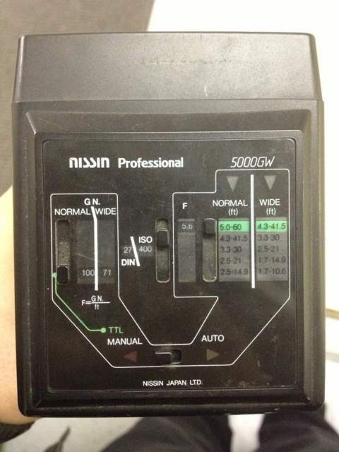

If I change the ISO on this flash to 100 then the min GN is 12.5, 200 is 18, and 400 is 25... Which makes sense now mathematically.
