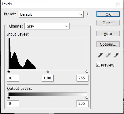

This is the histogram of your RAW scan as seen by Photoshop CS5 levels
As you can see this matches the histogram in Vuscan. This says to me that the film is under developed. Exposure determines the shadow detail, development determines the highlight detail. I suggest a 10% to 15% increase in development or more as a solution.
This is accurate for negatives, but may need to be revised to take into account that these are black and white slides.
