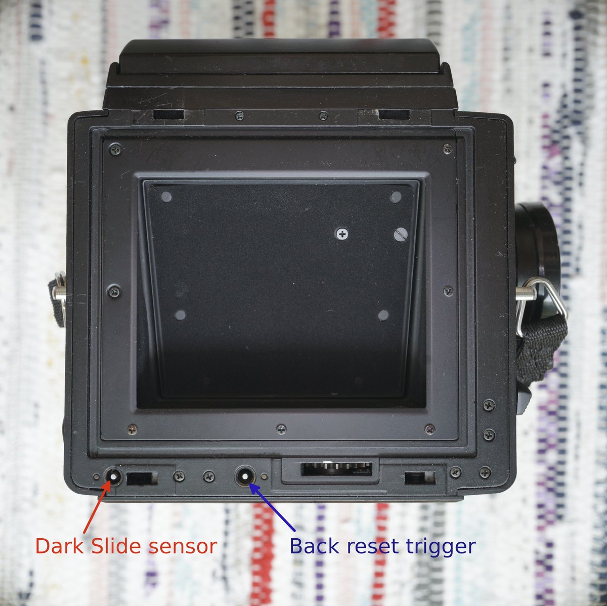

The mirror hang-up is typically the first sign that the body or back may need a CLA (note, my GS1 has had the mirror hang once, but it resolved and I did not service it). The spring forces are minimized on this camera to produce a smooth light wind feel, and the use of a quality components and lube have allowed a long service life (pretty much the professional life of the product with minimal service).
First:
Does it hang when the back is off?
Does it hang with another back?
Does it hang when there is no film?
Does it hang with the double exposure lever enabled (both with the back on and off)?
Does it hang with the mechanical (battery-less) shutter release? (Back on? Back off?)
You have answered some of these, but getting the exact behavior is important to getting a reasonable diagnosis (other than guessing).
The back reset pin has a pretty light force (unlike the Hassleblad!) and if it gets jammed (prevented from extending from the body side) the shutter will not fire - thus the mirror goes up and appears to hang. That pin may not fully extend if the lube inside the body is sticky (or something is jamming it), of if the mating pin in the back is stiff.
If the mirror hangs half way up, then it's usually in the body. If the mirror rises fully, but the shutter does not trigger, it's often something to do with the Back reset trigger pin. If the problem is in the back, taking the back off will allow the shutter to trigger.

Had similar issue... Mine just started with this issue a week ago. I read a post on another forum, about a
guy with a Bronica ETRS that had the same issue too and he said it was the interlocking pins.
If you take a paper clip and press the reset pin in the camera.. Try to cock the shutter and fire it.. If it fires then
there is nothing wrong with the camera. On mine it seemed to be the film back. The film back has 2 pins, one on
the film insert and then one on the outer film back (in the little metal cylinder). There is a lever on the side of the
film insert, when its depressed, it extends the pin in the Film insert, which then extends the pin in the outer film back,
which then pushes in the pin on the camera and unlocks the shutter release and film advance. Mine was not pushing
the camera pin in far enough, I took a small piece of metal and wedged it against the lever, to keep the Film insert pin
extended, I then took the pin out of the outer Film back. Inside the outer film back, where the pin is, the little cylinder
has a screw on cover, if you remove this, you can remove the pin. On mine the pin didn't seem long enough. Not sure
if it was wore down from use, or what? So I fashioned a new pin from a tiny finishing nail. I cut it to be slightly longer
then the original pin. I put the new pin in and now the camera fires on single exposure mode, even with no film in it.
The simple fix would be to just get another film back. But I didn't want to waste this film back as they are not that cheap
to replace...Only ones out there are from Japanese camera dealers on eBay and they are around $140 plus $40 shipping
to the US. Hope this helps you....
