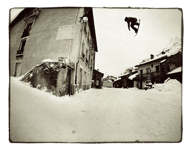

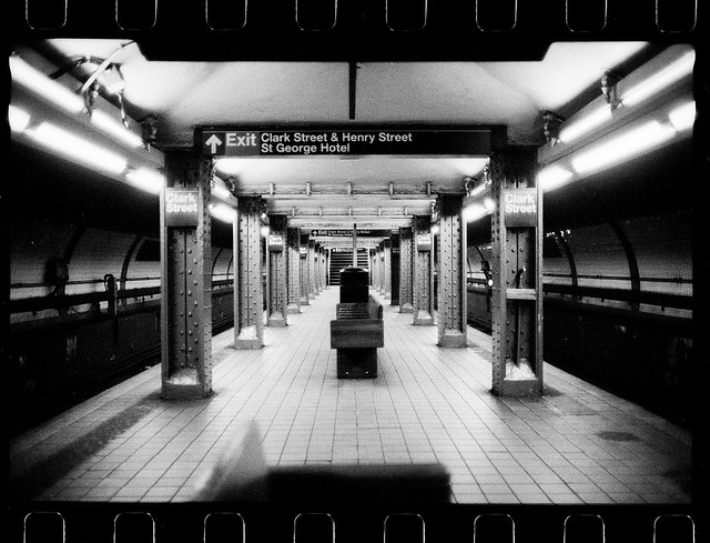

Maybe you could give us an example of what you mean by "grungy, tatty print borders".
like so...
