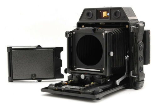

Most of the listings I see on e-bay show the ground glass back is included, even if it comes with a rollfilm back.
This is one of the first ones that popped up on an ebay search:
I've been looking at the Horseman cameras. That one has no RF cams, as I recall. Not the end of the world, but worth noting. They're normally stored either "in use" in the focusing bed, or stored in two little slots at the top inside the body, either side of the catch. They look empty to me.

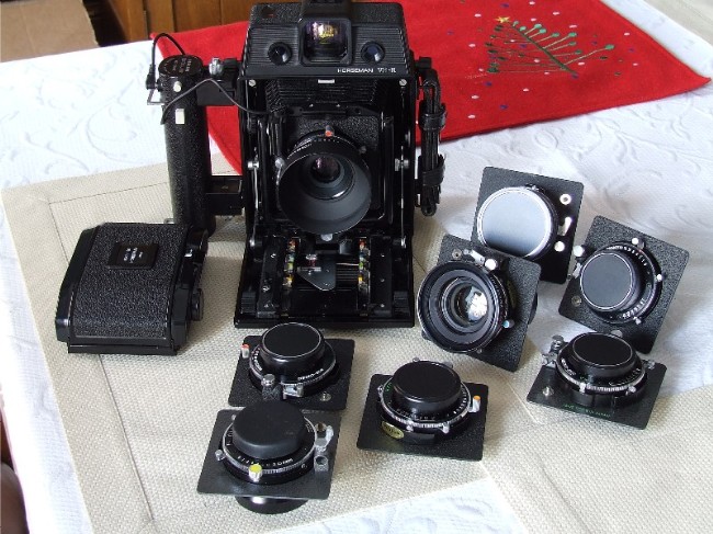

I see my picture is from 2007. I got in to Horseman when it was pretty easy to get a complete system. Back then B&H was still selling many of the accessories brand new. In fact that rollfilm back pictured was brand new from B&H.
I see it has the ultra rare shutter solenoid triggered from the electrical grip. Very nice.

Back then the solenoid was not so hard to find either. From what I recall my first rolls were all ever so slightly blurred from the mechanical release (with my thumb). I pretty much went on the internet that day and got a used solenoid right then. The grip, solenoid and extended 15ft elecric release, all like new. Even RadioShack sold the 22v battery. I'm really glad I got all that stuff, as I use that camera a lot. I just got done shooting some Instax with it now.
