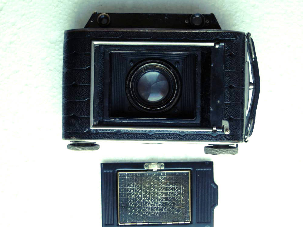

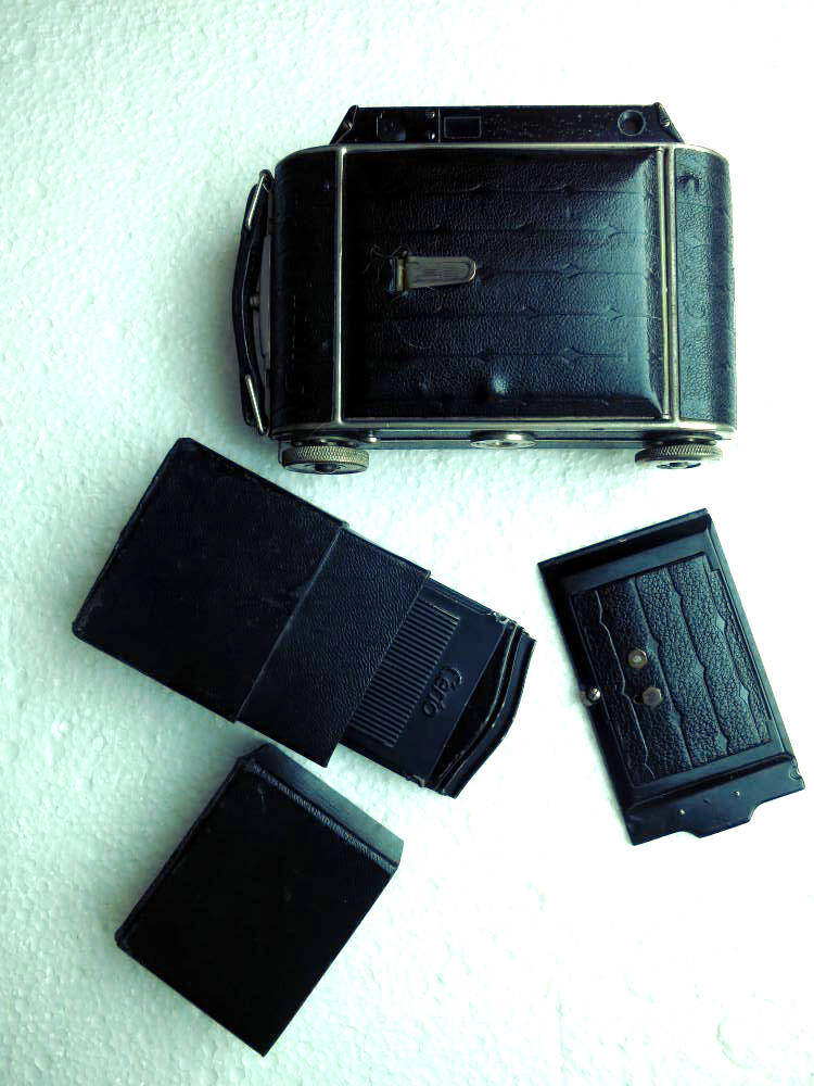

The single sheet kit.
Back flap deposed.

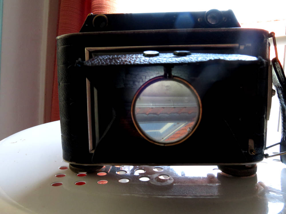

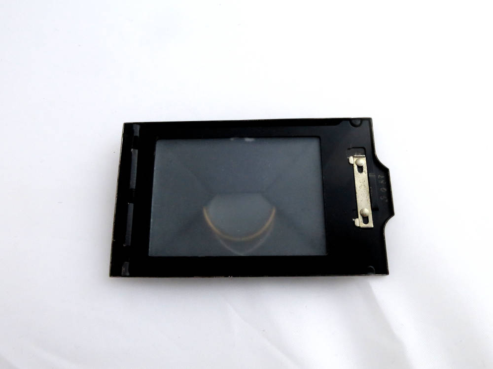

The holder with its new ground glass. Nothing to unscrew, you only have to slide the little lever to open the frame. You can see the tight space: the hood and the magnifying glass are squeezed against the glass.

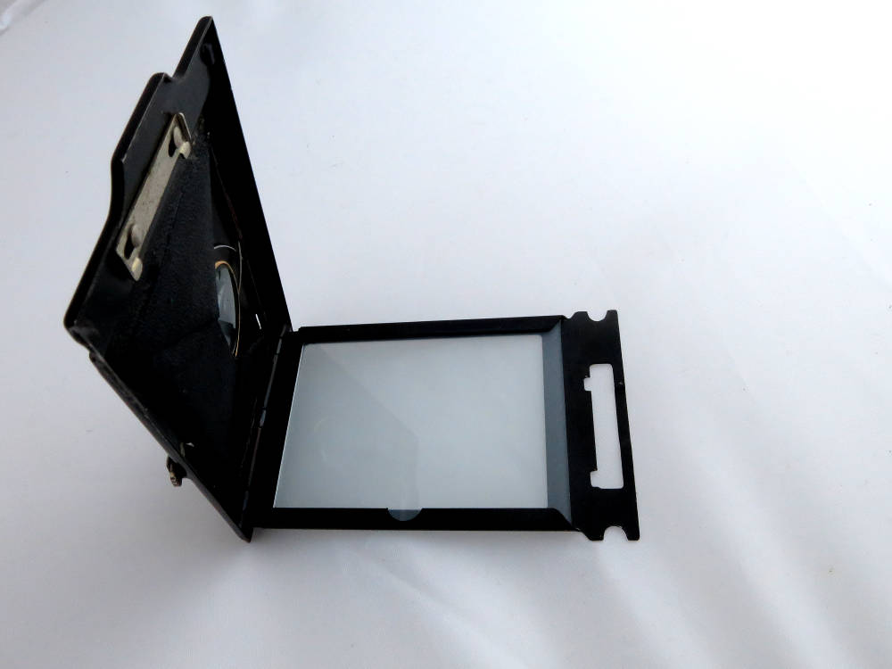

Frame open.
The new ground glass in action. Thank you, Ian Grant.
