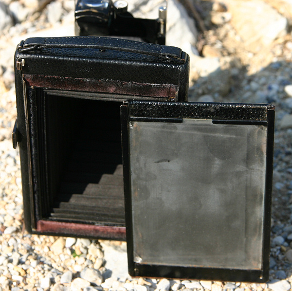

The Patent Etui should have a glass screen, mine is in Turkey, if I'd spotted your post on Wednesday I was there with the camera and I would have photographed the back. It's a few years since I replace the screen in mine but I know it was very simple.
I've found a photo of the back unfortunately the bottom isn't that sharp.
attachment.php
I think the screen needs to be pushed into the bottom against a spring until it clears the top and can be pushed in flat, the spring then pushes it into the top under the metal edges. That's the original screen I replaced. You may need to make a simple spring, probably easier to take one from an old plate holder.

Cheers, Ian. It's very helpful to see the back on an original KW focussing screen and good to know it should be glass. I'd love one of these but the back on my Patent Etui is clearly from a different 9x12 camera. So it'll have to do for now.
I'm pretty sure you're right, though, about the spring. Having examined both of my wooden-framed backs again, the bottom slot is about 5mm deep (compared with the upper slot, about 2mm). So there's room for a small spring and to allow the glass to be pushed down onto to it enough so that the top edge clears the top slot - and the spring will then push the glass up and hold it in place.
I suspect that the way the frame is constructed, with the two-layered top and bottom, was to allow the spring to be put in rather than to allow the original glass to be fitted. So I just need a new glass and a spring and I can get my focussing screen back into a more user-friendly state.
