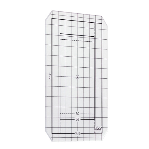

Hey all,
I've decided that I would like to use 120 roll film on my Pacemaker Speed Graphic. I'm looking for a 4x5 glass (mine needs replacing anyways) that has markings for 6x6, 6x7, 6x9 and 6x12. I'm not really finding much on this. I know that Linhof makes one (excluding 6x6) but that's about all I have been able to find. I have an email into Steve Hopf to see if he would be able to do this. I'm looking for my ground glass to look similar to this. Thoughts?

looks like you already found the one you want

I cannot guarantee that this will fit my graphlex back or can I?
Length and width can be trimmed (stained glass grinder) if necessary. Thickness shouldn't be a concern unless the GG is so thick it can't be mounted. Make certain the line guides match up with your RFH openings.

I'll measure mine once the camera gets back. I'm not so sure I am properly skilled to do any of this especially when dealing with glass. We'll see. Perhaps I will get lucky. I need to inquire to the actual dimensions of the Linhof glass since I do not know to be honest. Also, while the Sharpie idea sounds nice I never did well in art class and I would like my setup to look somewhat professional and nice. :smile:

if you start changing GG make sure you understand about shimming/adjustment of its depth becasue if you get it wrong and don't know the original depths and thicknesses, you'll never get it back to where its was. You will need to measure the depth of current GG very accurately before you alter anything. Ideally replacement glass would be same thickness.
If replacement fits from outside of back then it should be simple even if glass thickness is different. But if its inserted into back from camera side then it gets very tricky if glass thickness is different as shimming will need to be adjusted to get same depth as original GG.
May I suggest you just get a piece of clear acetate or thin perspex for each format you want to use, cut it to size with correct size opeing and fit over outside of GG and put in place in the same way as fitting an external fresnel, there may be clips on back for this. Or get some of those little double sticky sided labels so you can just stick it to GG on outside. Then you don't need to mess with GG at all. And you can take it off when not using it.

I've used a variety of masking techniques:
- Xerox transparency overlay on top of the GG
- Drafting "lining" tape on top of the GG
- permanent marker on top of the GG
- pencil lines on the ground side of the GG
All worked good enough but the overlay became annoying very quickly. It was just one more thing to look through.

Custom decals are easy enough to order if you have the given pattern on a file. My own method is a little different. I'll mark only the corners of the
smaller format on the GG. That way, all those misc grid lines don't annoy me if I'm trying to compose a full-sized image. Then when I switch over to
a rollfilm back, I merely slip in a piece of 5-mil frosted mylar with the appropriate cutout in it. The corners of this obviously align with those little dots, which I can also use for a quickie roll film shot if I don't want to install the mask, which merely slides under the groundglass clips for retention.
But what this gives me is something transluscent, where only the roll film format is fully visible on the GG through the cutout, but anything outside
those borders slightly visible too, helping evaluate adjacent parts of the scene if necessary. The polyester itself is waterproof, tough (except for kink
marks if you bend it too hard), easy to clean, inexpensive, and dimensionally stable.

I masked mine for 6x9 by exposing a 4x5 sheet and developing and fixing. I cut an opening slightly smaller Than 6x9. I just place the film on the viewfinder when I shoot 6x9. i tape it in place.

Something to consider is that some backs don't center the roll film frame exactly the way you think would be logical. I suspect the glass you can buy is set up for that maker's camera and roll holder and may not work in every instance. I've been looking for some nice plastic to cut my own framing guide, and it never occurred to me until this moment to use film as Kilgallb just suggested. Stupid me!

I know this thread is a bit older, but for those contemplating the same thing:
If you've got a Fresnel screen on the lens side of your ground glass, just keep it and don't even think of replacing it. Not only is your set-up about as bright as you can get, but the camera has been designed to focus correctly with this particular configuration of Fresnel and ground glass. Replacing it with anything but exactly the same Fresnel/ground-glass screen will result in a focus shift and incorrectly focused negatives. Better to get an overlay or a protective glass screen with the lines you need on them (or use a mask).
