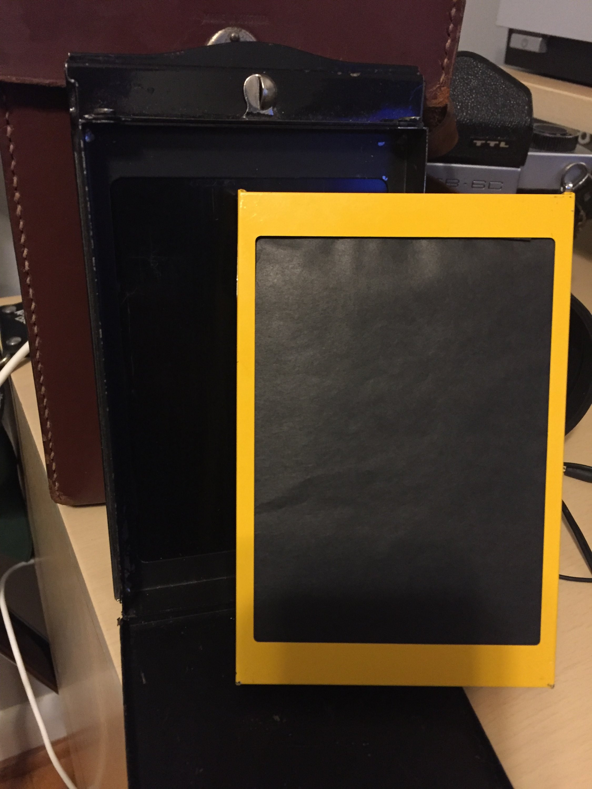

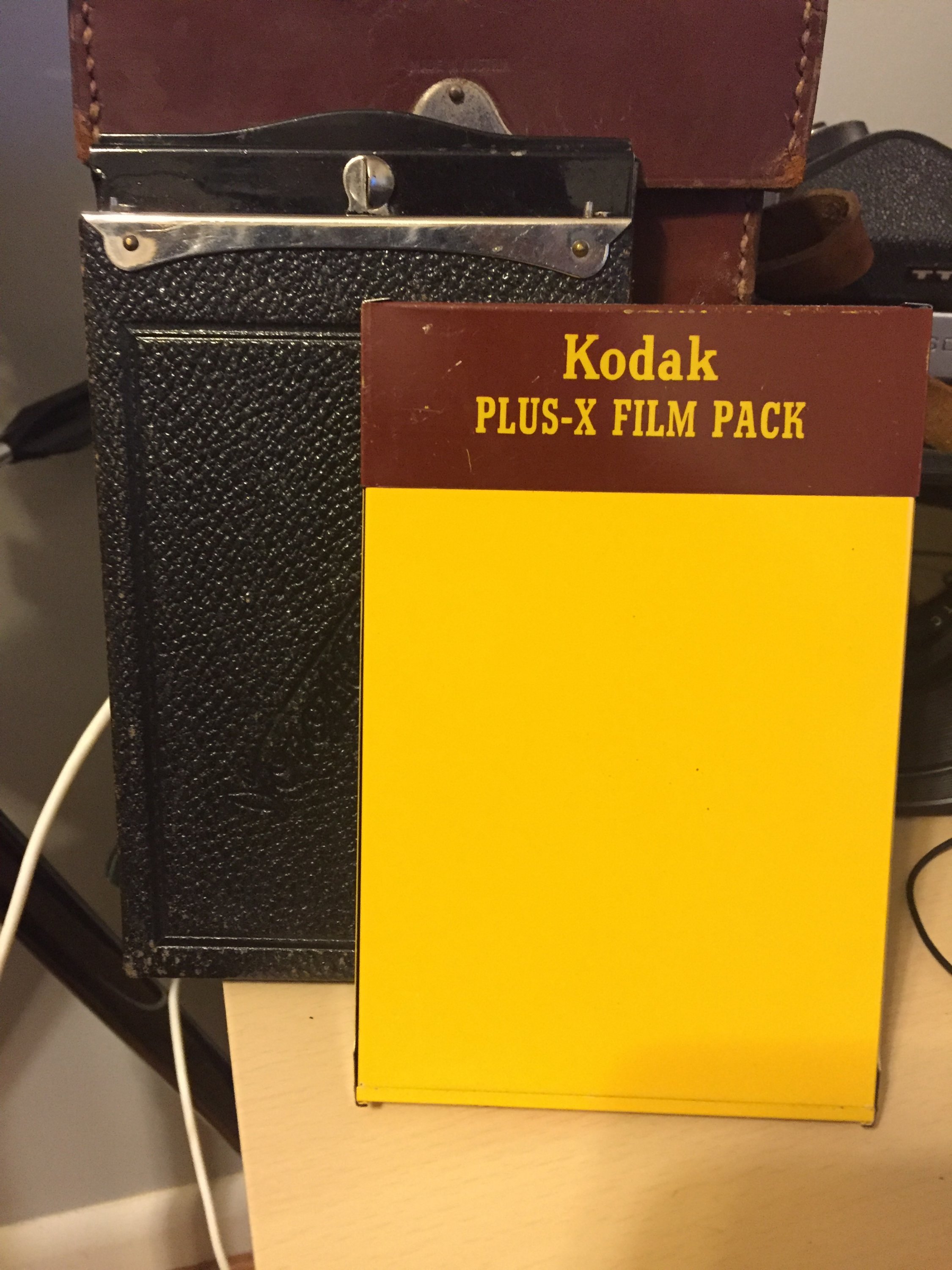

OK, tired of procrastinating; need to get this done.
When you adapt a film pack holder for an AVUS 9x12cm camera to a ground glass focus viewer, must you shim the glass equal to the thickness of the film pack itself? By that, I mean the metal cartridge that fit into the holder...
It would seem that the thickness of the metal lip of the yellow holder has to be accounted for; correct?

To clarify what Charles wrote, you'll have to shim the GG back from the front of the FPA. His table tells you how far behind the front surface of the FPA the GG must be.
