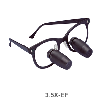

What format? If 8x10, then non-perscription 'reading glasses' may do. For 4x5 you would probably need an actual loupe. I use these DesignForVision 3.5x at work but have never used them to focus the camera. A loupe is easier.

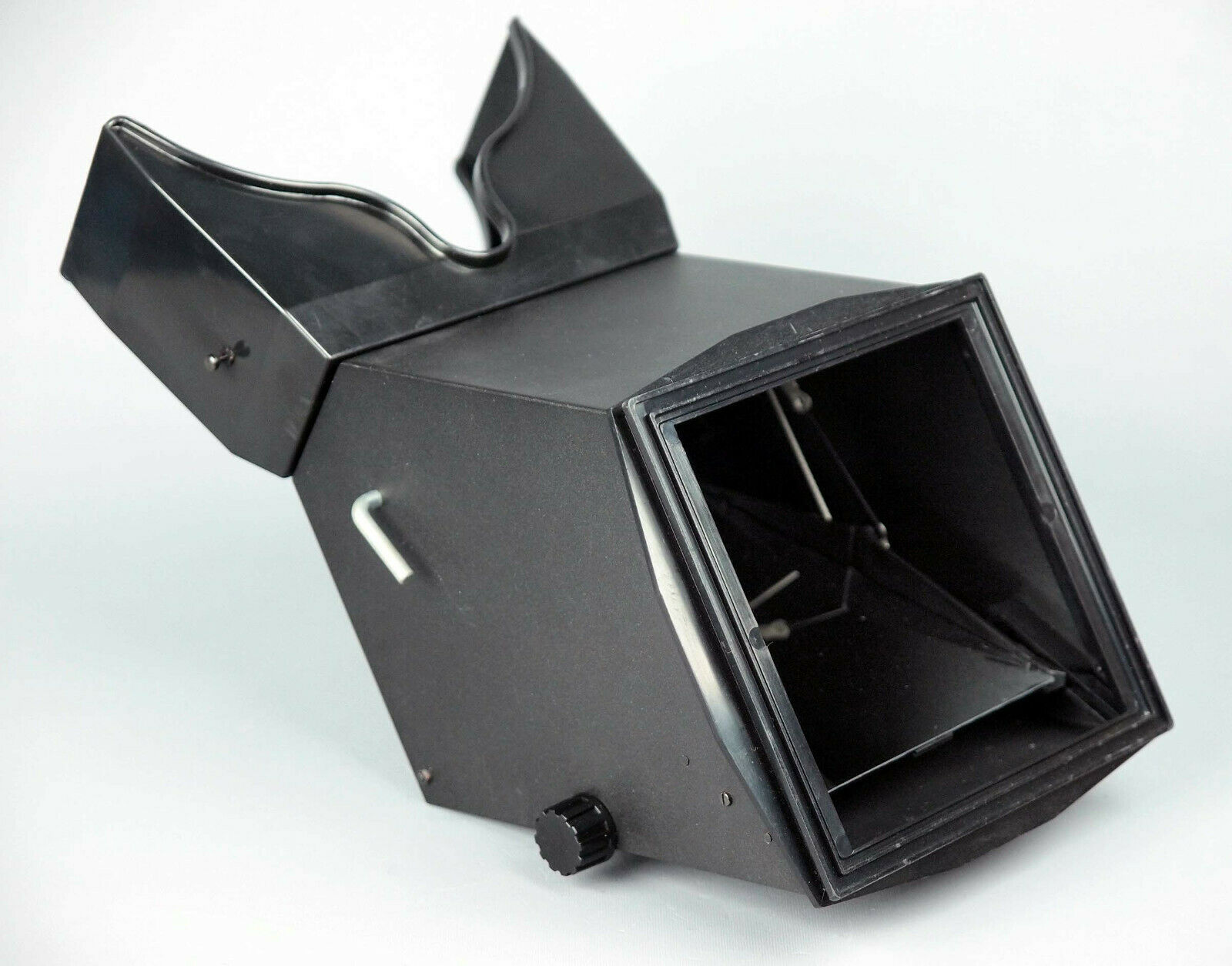

Still many solutions have been developed to complement or to substitute the loupe, like the sinar reflex, with that you have both hands free:
But IMO best is it to practice enough with the loupe, with good practice the adjustable loupe becomes very convenient.

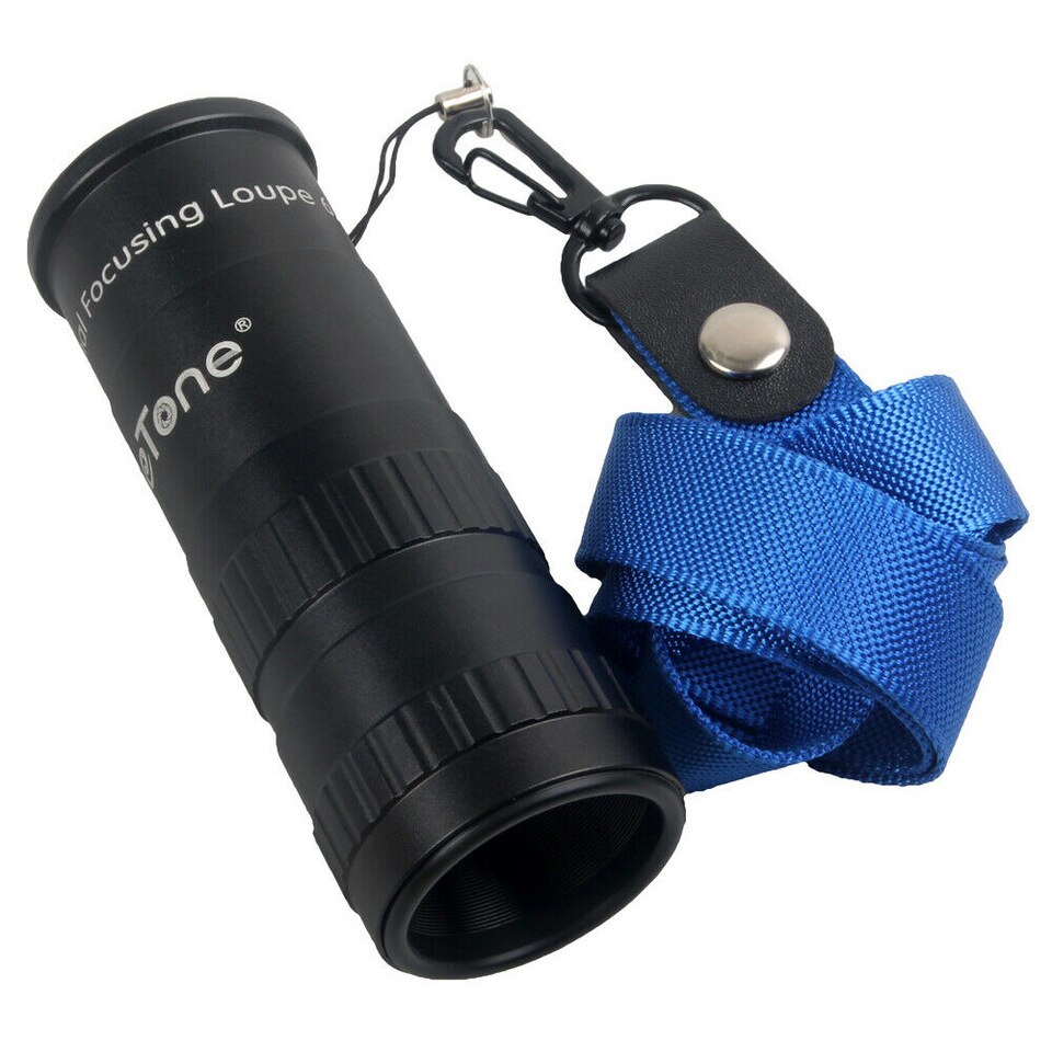

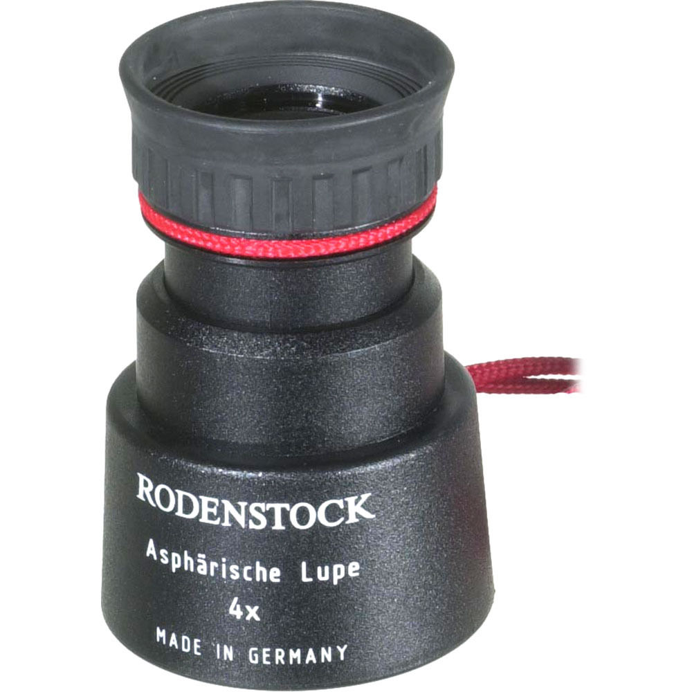

To focus a view camera you want one that has adjustable height, with the loupe making contact with the GG you turn a ring in the loupe until you have the GG grain in focus for your sight and also compensating the GG thickness, you have your loupe calibrated. With a non adjustable loupe you have to vary the distance to the GG all the time, which is not convenient or fast.
You may use many kinds of loupes, these ones (for example) are designed to focus view cameras conveniently and accurately:

If you want readers instead of a loupe the stronger the better, to get close to the back. I have a couple nice Rodenstock loupes, very nice
