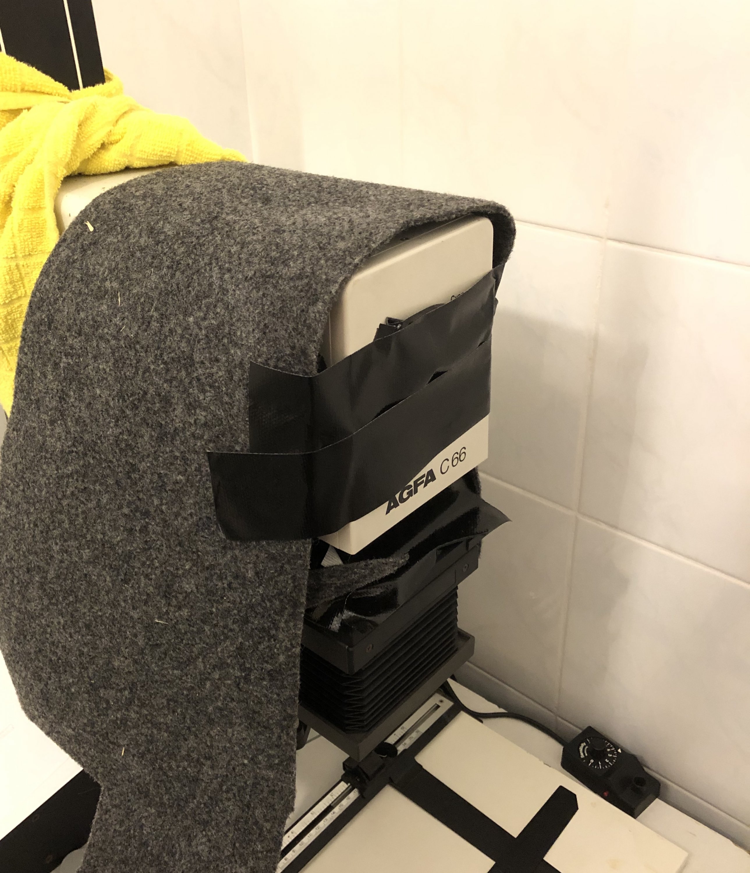

Ok, so thank you everyone for the replies, this place really is an amazing wealth of knowledge and I’m very grateful for the help. Yes I am a complete beginner, this is my first time in the darkroom as you can tell.
Anyway so after sifting through the suggestions I went back in and printed the same neg in the same way on both enlargers and still got a very grey washed out image from the Agfa (durst). The image from the LPL was wonderful in comparison. Anyway, I re read the suggestions and Neal’s idea that light leaks from the enlarger could fog the paper came up. Sure enough I turned on the enlarger and light was pissing out everywhere and it’s hard up against a white tiled wall so it’s reflecting light all over the place. In the magic of the moment I clearly hadn’t noticed this as I’m still in the awe struck stage of printing. Anyway, I started to tape up and cover all the light I could see (there’s a few sliders to select 35mm and to engage the filters, light was beaming out of these). I tried again and this was 100% my problem. The image is 100 times better, still a bit of grey that I know shouldn’t be there but the blacks were black and whites were white. Amazing! Now I have to figure out how I’m going to seal the leaks more permanently.

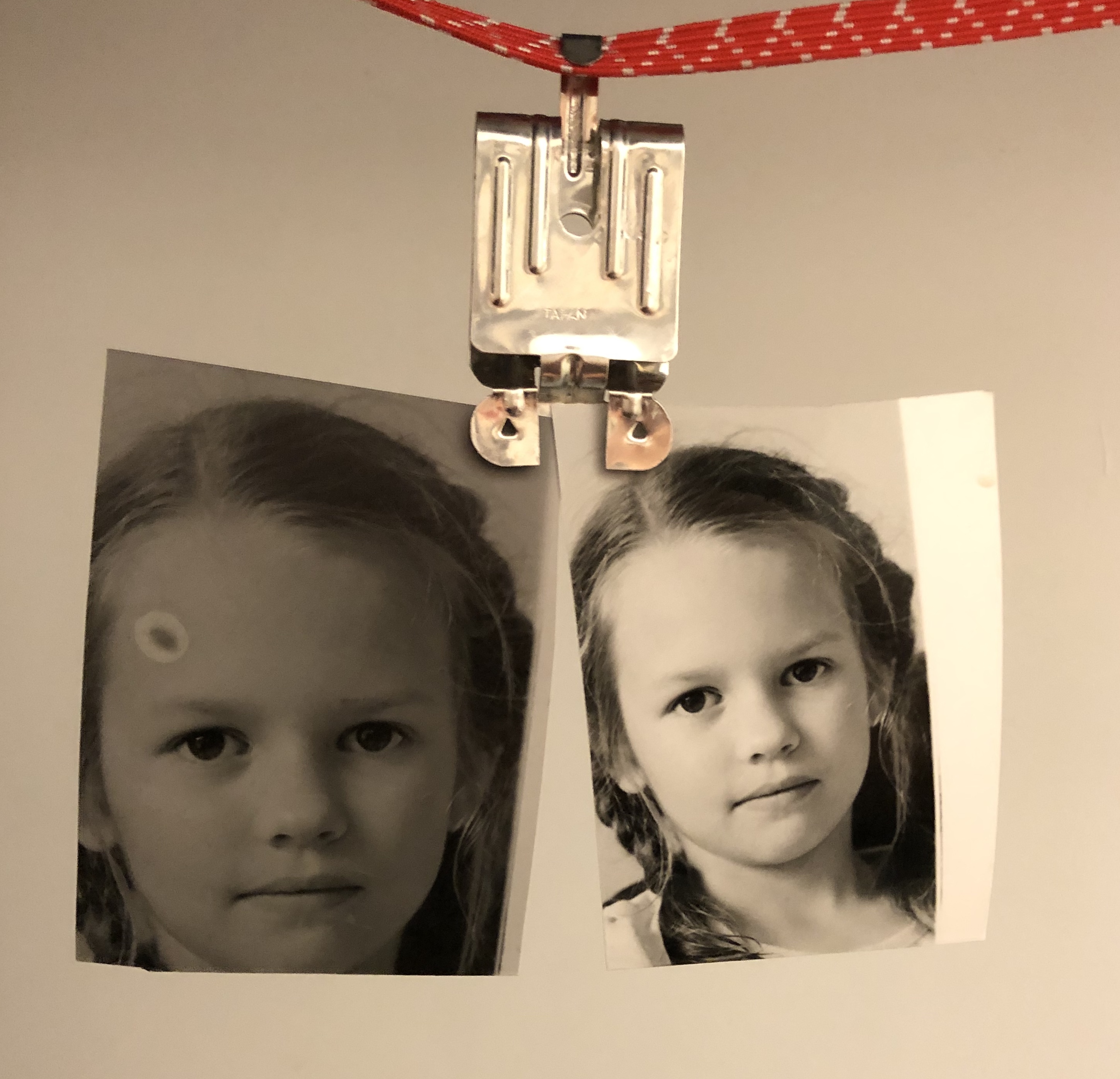

Sorrycharlie
Nov 3, 2019
62
Australia, NSW, Illawarra

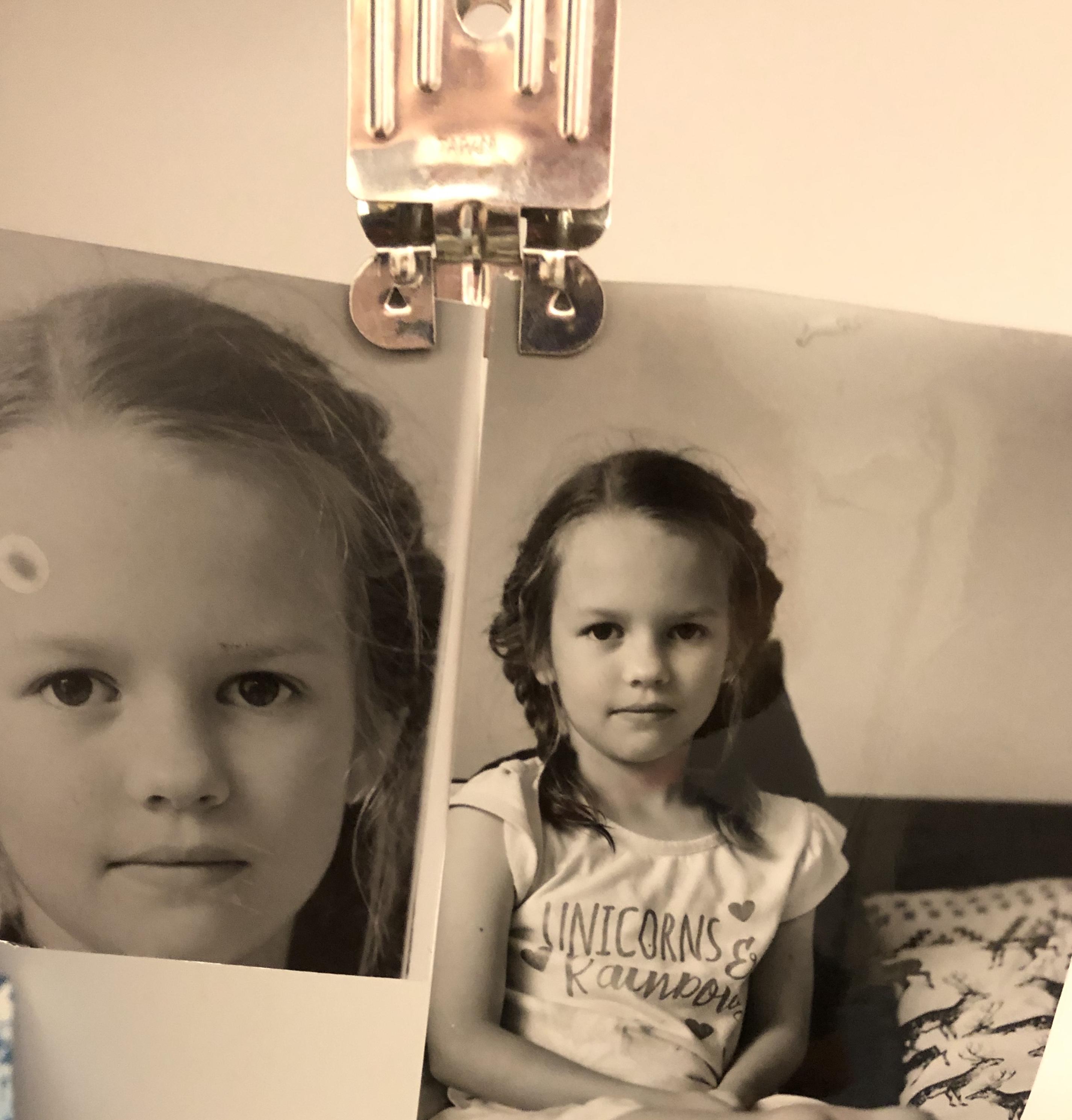

Left was the AGFA with light leaks and right is the LPL
Sorrycharlie
Nov 3, 2019
62
This one is the light leak AGFA on the left and then the right is after I covered up the light leaks. Still not a great exposure but so much better, and I think was the problem

Be careful with heat!
Try covering the tiled walls at the side and back - something like a grey towel would be perfect.
If necessary, you can add as well a small cowling just below the negative stage.
Some light leaking out the side may be okay if it doesn't reflect off anything and down to the paper.
You probably understand this already - if you have paper out, the enlarger should be off except when the paper is actually in the easel and the exposure is happening.

Thanks Matt, yeah I realised straight away that this would cause an overheating issue and I will now have to figure out a way to stop the light or maybe diffuse the tiles like you mention. Yeah I’m careful to turn the enlarger off before opening the paper, made that mistake a few times !

As others have said a white glossy tiled wall is far from the best background from a reflection aspect. I suspect that it is a kind of point reflection from such a wall that resulted in the mark on the girl's forehead. My own enlarger is a Durst 605 which essentially is the same enlarger from a light leak aspect and yes light does leak from the carriers Mine does and has since I got it . However it does not exhibit your problem. All I have is matt white wall paper on the wall behind the enlarger which isn't even painted black. My carrier is about 14 inches from the wall and when I take paper out of its box the box sits quite a few feet from the enlarger and well below the level of the leak of light
Why am I telling you all this? Well the good news may be that if you cover up the glossy tiles and then take the kind of precautions I mention this may be enough. Covering the whole head with carpet is far from ideal for the reasons already given
Incidentally if you can cover the specific light leaks from the carrier in a convenient way that does not impede the use of the enlarger then let me know. Such information is still useful to an experienced user like myself
